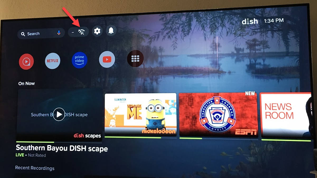

The screen that shows up here, which is after hitting Home on the DISH Remote (50.0 and 52.0), where I have the arrow pointing in the photo below, isn't that supposed to show something like the Weather instead of what it is showing as when I click on it, it does show the weather in a bigger full screen for San Francisco on The Weather Channel:
This still occurs in H398 and is probably a issue with the Hopper Plus software as that still did not have a new version after P13712 yet. Not sure if the Hopper H3 without the Hopper Plus connected even has the weather icon at all.

I have the same issue with the weather not being shown and showing that wifi looking icon.
Is that with the Plus or without the Plus?
Mines did fix itself once right before I updated to H398 as mentioned in the H396 thread. charlesrshell did show his was working in H397 withe the Hopper Plus also on P13712 but I wonder if his works correctly all the time or if it actually had the problem too and also just fixed itself when he went to check it.
I don't ever recall seeing the WiFi icon. I just checked again and I see the Wx icon for both my H3+, H3, and all my Joey 4s.

Issue #3

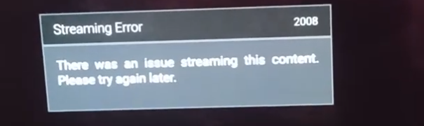

There is also another new issue that only occurs in H398 as mentioned below:
Issue #4
Ever since I upgraded to H398 on the Hopper 3 with Hopper Plus on P13712 on August 8, 2025, this did not happen on the Hopper 3 with H397 and Hopper Plus on P13712.
The first time was on August 12, 2025 when I was watching channel 626-05 which is streaming TVB Drama that is part of the JadeWorld package. The video would freeze and not resume even after 30 minutes. The other JadeWorld streaming channels are working fine but channel 626-05 would show the DISH Animated logo of starting the stream but no video would show and then the following error would show up on the screen no matter how many times one tries to change to channel 626-05 after going to another channel:
On the August 12, 2025 incident, I thought it was a channel outage so I contacted DISH on Facebook Messenger and the only way we were able to get the channel back was to use Reset Hopper in the Tools area of DISH Diagnostics.
The same thing happened yesterday and the video would not resue even after 30 minutes. The other JadeWorld streaming channels are working fine but channel 626-05 would show the DISH Animated logo of starting the stream but no video would show and then the same error with the 2008 error code
would show up on the screen no matter how many times one tries to change to channel 626-05 after going to another channel and the only way to get the channel back was to use Reset Hopper in the Tools area of DISH Diagnostics.
I do not know if rebooting the Hopper Plus would have fixed the problem or not.
Many thanks for your time in reviewing this!
Makes one wonder why it works for some and not others. If I had to guess, it seems like it might depend on the Hopper 3 with or without the Hopper Plus's is connected to the internet before the weather part loads and if it is connected, then it will work and if it is not, then it will show that issue. What appears to be missing is that icon needs to learn how to refresh itself and check for internet connectivity again later on and update the icon if the internet is connected as I do notice the Bell on the right hand would have a notification claiming no internet connectivity and then another one saying there is internet connectivity.
