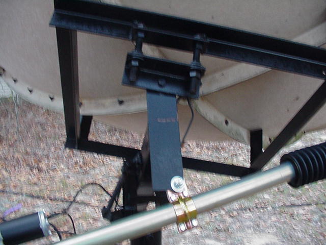

Yes, I've got it on a 10' fiberglass with a GI 920. I had to buy a new actuator, the one that came with the dish wouldn't work. I had an extra one, but it was too small to move it. It would travel downhill, but it would take it back up? So I ordered one from Rick's Satellite. It's a Venture 24" Ball Screw rated at 1500lbs, I think.

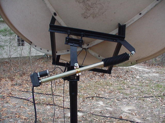

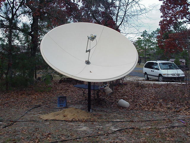

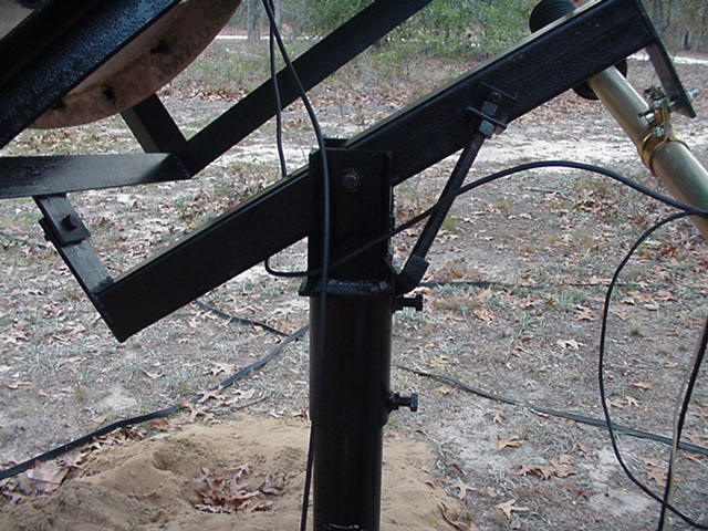

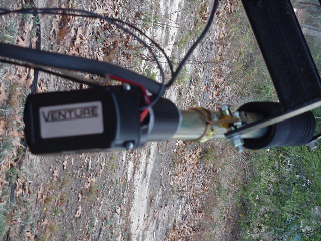

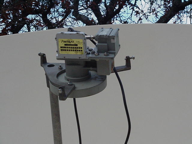

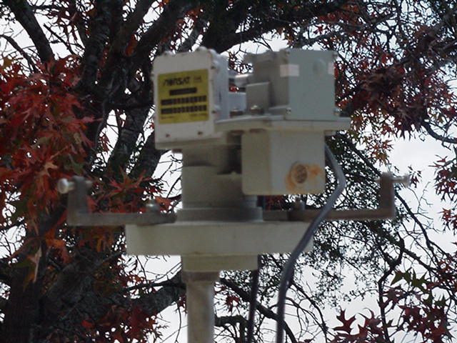

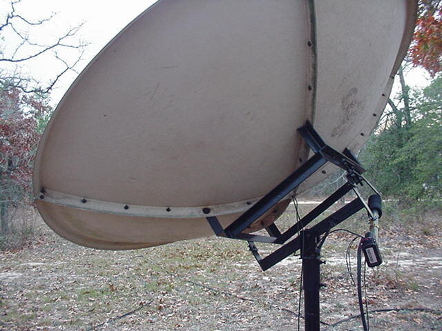

Steven, I went out and took some pictures of the 10' fiberglass I was discussing in another thread (Inno's I think) with the Dual C-Band Feedhorn. I was doing these pics for you and took pics of the wrong dish. I think you wanted to see the C/Ku feedhorn I got from you. I'll try to remember to get pics of it tomorrow? When I went out, I guess I had the other dish or at least the Dual Feedhorns, on my mind. Sorry about that.
The 1st picture shows off the new Venture Actuator
The 2nd picture is of the Dual Feedhorn with the 2 LNB's
The 3rd is a different angle of the Dual Feedhorn
The 4th is a picture of the dish looking from the south (I think it's pointed @ T6)
The 5th is a picture of the Polar Mount from the east
The 6th is a picture of Venture Ball Screw Actuator
The 7th is a picture of the Elevation Adjustment on the Polar Mount
The 8th is a picture of the Declination Adjustment on the Polar Mount and you should be able to tell this mount is an offset mount, meaning it's not centered with the Pivot.
Here are the pics I took a few minutes ago:
