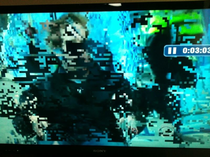

Not sure about KITV since they have their own procedure. Tonight (6/8/2013) KITV News is totally unwatchable. See the attached video to fully understand our dilemma.
