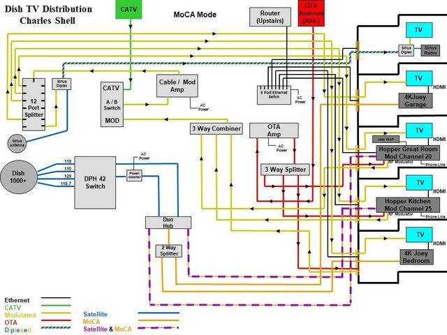

I have one each RF Modulator connected to both my Hopper 3s. One of my H3s has a component to composite converter installed prior to the RF modulator so I can get wide screen at the distant TVs. On one of my Hopper 3 modulators channel 20 is set for the distance TVs and the other H3 modulator is set on channel 25. So the distance TVs in my home distribution system has a choice of which Hopper to view. Here is a wiring diagram of my system.
Holland HMM-10H Multimedia Demodulator (HMM10H) from Solid Signal
Monoprice Component (YpbPr) to Composite Converter (Open Box) - Monoprice.com

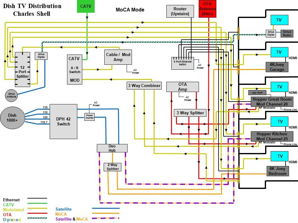

I recently had a component to composite converter fail so I replaced it with one from Amazon that I posted a link of in a previous post. Just FYI, the new converter seems to have a clearer picture. :)
