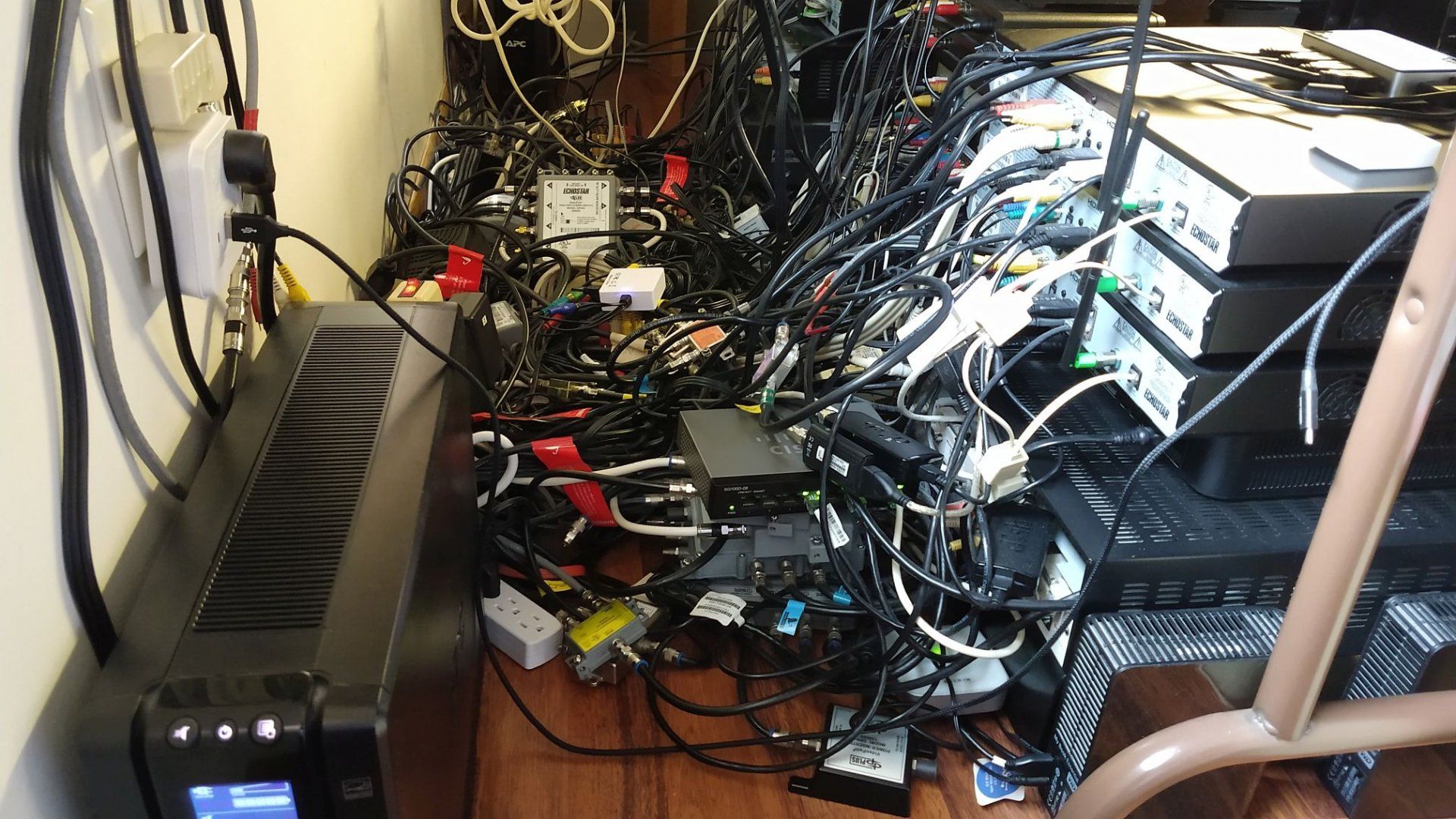

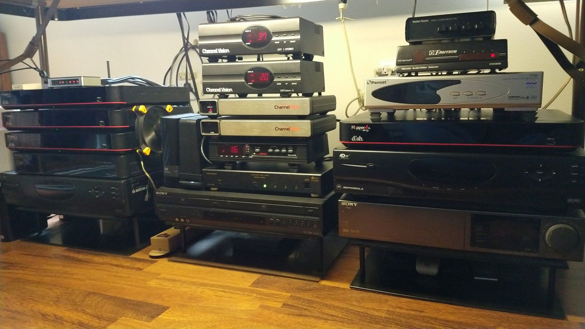

Here's part of what's in my office, the front is nice and neat and then there's what's behind them.
:p This has all been accumulating over the last 20 years that we've been at this location. I never seem to get the time to clean them all up because I'm always busy making all the customer's wiring very neat. By the time I get to mine, well you know. :)
WOW, are you kidding me! :coco:eeek;)
View attachment 138209 View attachment 138208
