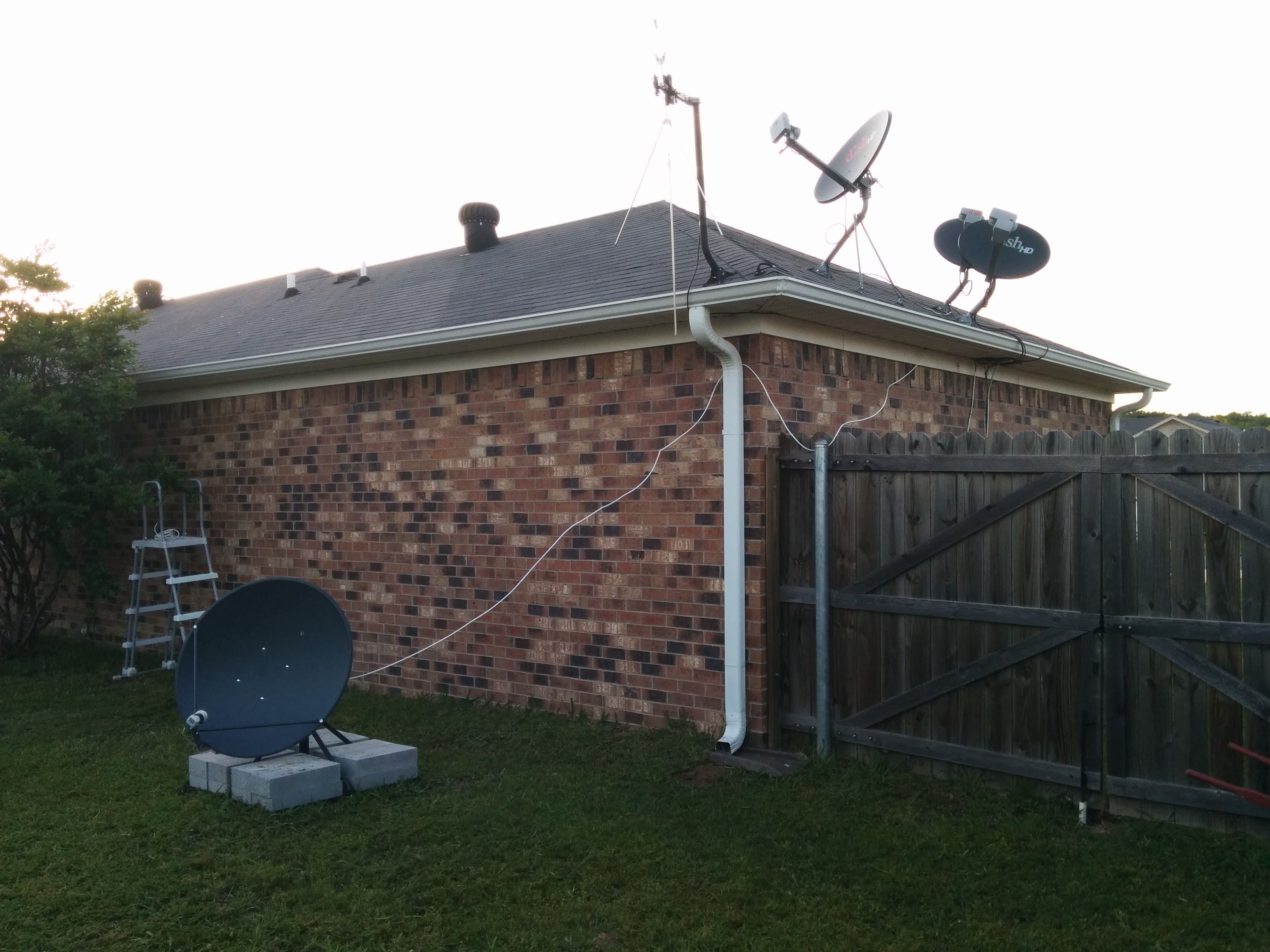

Thank you sir. I'd love to get a C-Band dish, but I live in a subdivision with a fairly small back yard. Yes, getting my wife to accept it would be a huge hurdle, but I also don't have the first clue as to where to get one. Apparently BUDs have gotten very scarce around here. Secondly, it would involve a more permanent mount than we would necessary like at this time, since we aren't completely sure this is where we will be living in the next 5 years. The Ku dish I have is a motorized 90cm which is mounted on a leveled NPRM with 16 concrete blocks. I've been in the hobby for about a month now, we'll see what happens over time :)
Here's my Ku dish, and my array of DN dishes.
My Channel Master 1.0 is on the original Channel Master NPRM with only six 1/2 blocks. Has not moved in 60+mph winds. 16 should keep yours in place in the heart of a F5 tornado (although I think the dish would be in the next county) My 10ft BUD is also on a NPRM - of sorts. AKA a 'Free Floating slab'. Could be formed circular instead of rectangular. That would allow it being tipped and rolled to a new position. (minus the dish) http://www.wisegise.net/BUD/3469/ (towards the bottom of page) Sorry for being/continuing 'off topic'.
