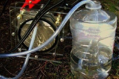

Had some minor fabrication work designing and building a HHO generator . Freaked out installed when I had hose in my mouth a few minutes while it was on as I was working on the bottle ( you can easily breathe hydrogen and oxygen LOL ) . Then twist tied , sniped hose and threw it on the bonfire . A bit louder then a 12 gauge LOL

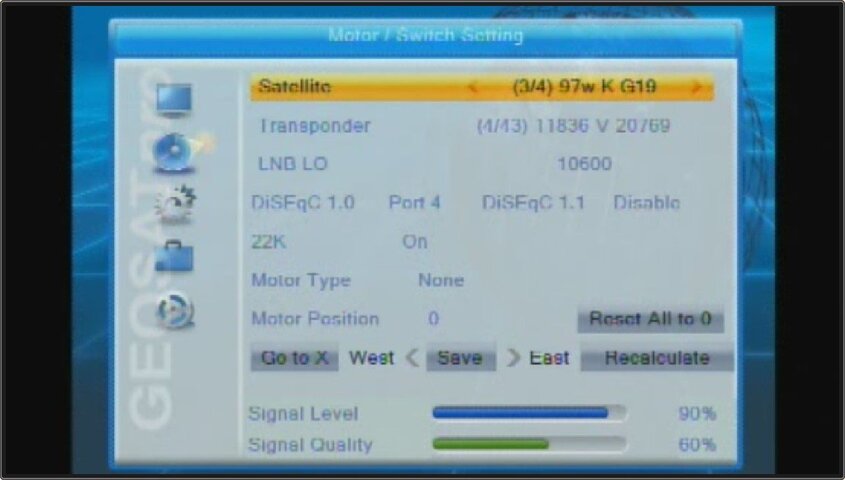

The receiver's LNBF LO is set to the wrong setting for 95w and probably also wrong on 97w as well. How do I know? Well, CCTV TP frequency is actually 11780 and you scanned it at 12780. This calculated to mean that the LO frequency is set 1000MHz to high.
This is very likely why you can't lock onto the other two TPs. I bet you $1 that you would get a transponder lock if either:

Following along Brian's theme on the Local Oscillator (LO) frequency: Since you're using the same dish and LNBF to receive all of the sats, the LNBF settings (LO, 22kHz and DiSEqC values) should be the same for all of the sats you will scan with your dish. Assuming that the LNBF is the one shown in the pictures on the SatPro website (and I think it is based on your earlier posts), the LO freq should be 10600 OR something like Universal (9750/10600), 22kHz should be ON or AUTO and any DiSEqC values should be Disabled or Port 1 (you probably don't have a switch anyway--if so DiSEqC would be ignored). The screenshot below shows my STB's settings for 97W (for that Sat I use a Universal LNB, which is what your LNBF is as well):
Maybe you have 11600 as the LO instead of 10600?
If you have selected the actual LO Freq (10600, hopefully :) ) instead of the Universal setting, you should set 22kHz to ON instead of AUTO, otherwise you could either not see channels or transponders you expect to, or channels could show up on the wrong transponder (according to your STB, at least).
Can you post a screenshot or two of what your settings are for the various sats you're scanning?

When I plugged in reciever the LNB was set to 10600 with 22KHz on . Set satellite to match what satellite the First Strike ID'd , had motor store that sats position , then thumbed through the recievers TP frequencies at about 20 seconds each till I got a Q-bar and hit channel search . Everything else happened by itself .
Are you referring to the 10600 setting to be turned dwn 1000 ??? Will the 22KHz still be able to function ???

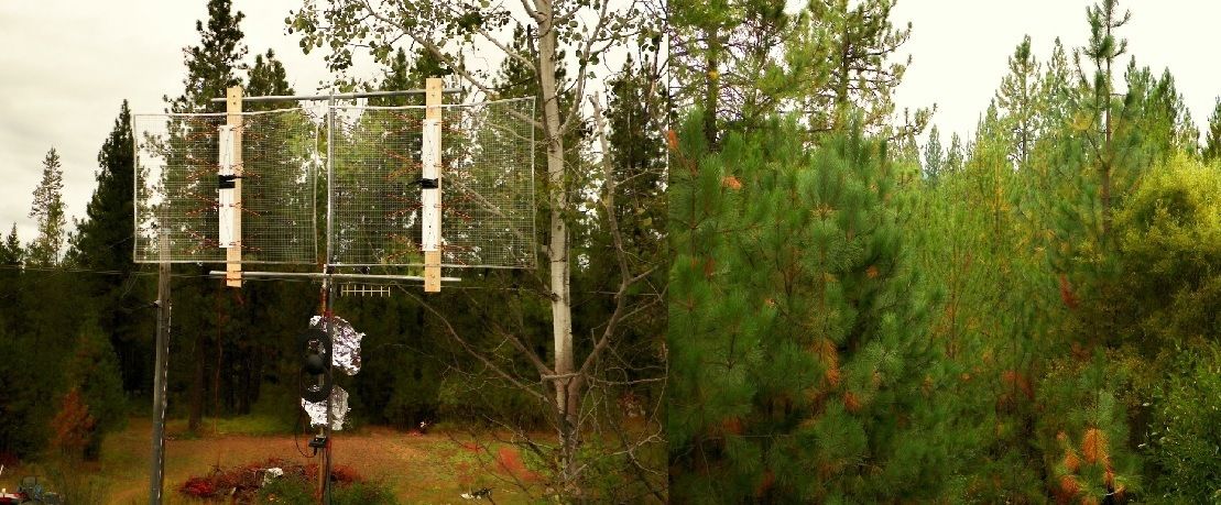

Perhaps in the spring . Moved onto next hobby which was to double signal strength of one of the top rated long range HD antennas with my own rabbit mesh one . Signal through the forest between two mountains and across the valley went from 10-40 to 40-80 in time for FOOTBALL ;) RoofHD.jpg Of course while shooting these pics on the rooftop wildlife invaded the property in a few places Turkey1.jpgMooseAndDeer.jpg
