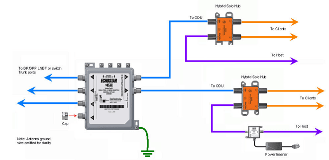

Please need help getting two Hopper 3's up and running on the same account? After paying for two dish tech visits, The Dish tech informed me the only recourse I have is to allow them to add a second satellite dish. One tech did say, it's possible by using a DP44 Multi-Switch, but Dish doesn't let the techs go that route. I've leased one Hopper 3 from Dish and purchased the other Hopper 3 from Solid Signal. I would prefer to go the switch route vs. adding an additional satellite dish. Any advice would be greatly appreciated.

It requires a DPH42 switch not a DP44 switch. You also need a DPP LNB rather than a DPH LNB. We have several people here who are set up that way with 2 Hopper 3s.

I know I have the Eastern Arc; however, the Tech from Dish only ran two coaxial wires from the LNB into my attic, is that going to be a problem?
2 lines from the Eastern Arc but it has to be a DPP LNBF. not a DPH. Seems like your techs didn't know what they were doing

Dish should accommodate him with the DPH 42 Switch but he'll want to insist to the installer that he use a Duo Hub, not 2 Solo hubs from the switch
