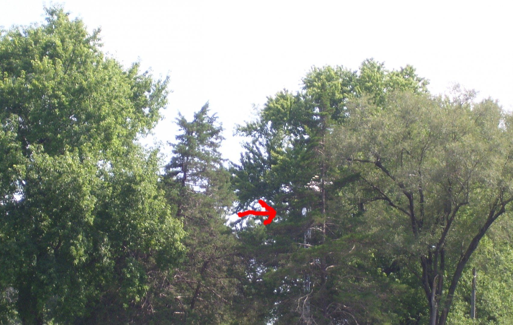

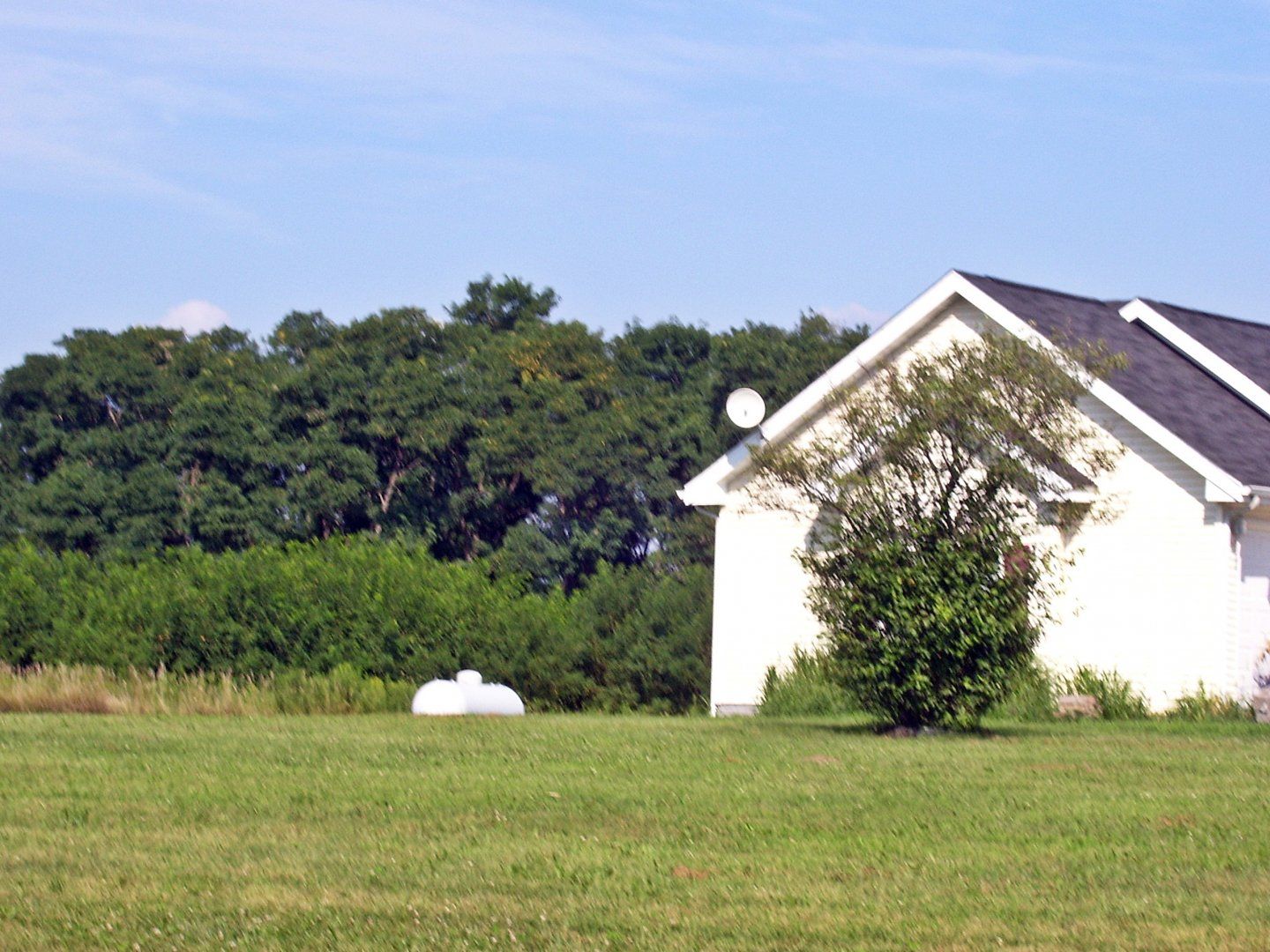

I have neighbors on either side of me that are using these little parabolic shaped antennas. I would say they were about a foot and a half across, and they have one small probe sticking out of the center. One is pointing East and the other West.
Could they be some kind of microwave antenna?
Here are a couple of photos. The second photo shows one of the antennas on a walk up tower, sorry for the pic quality.

Yes, those look to be PTP microwave antennas, probably Ubiquiti 5GHz.

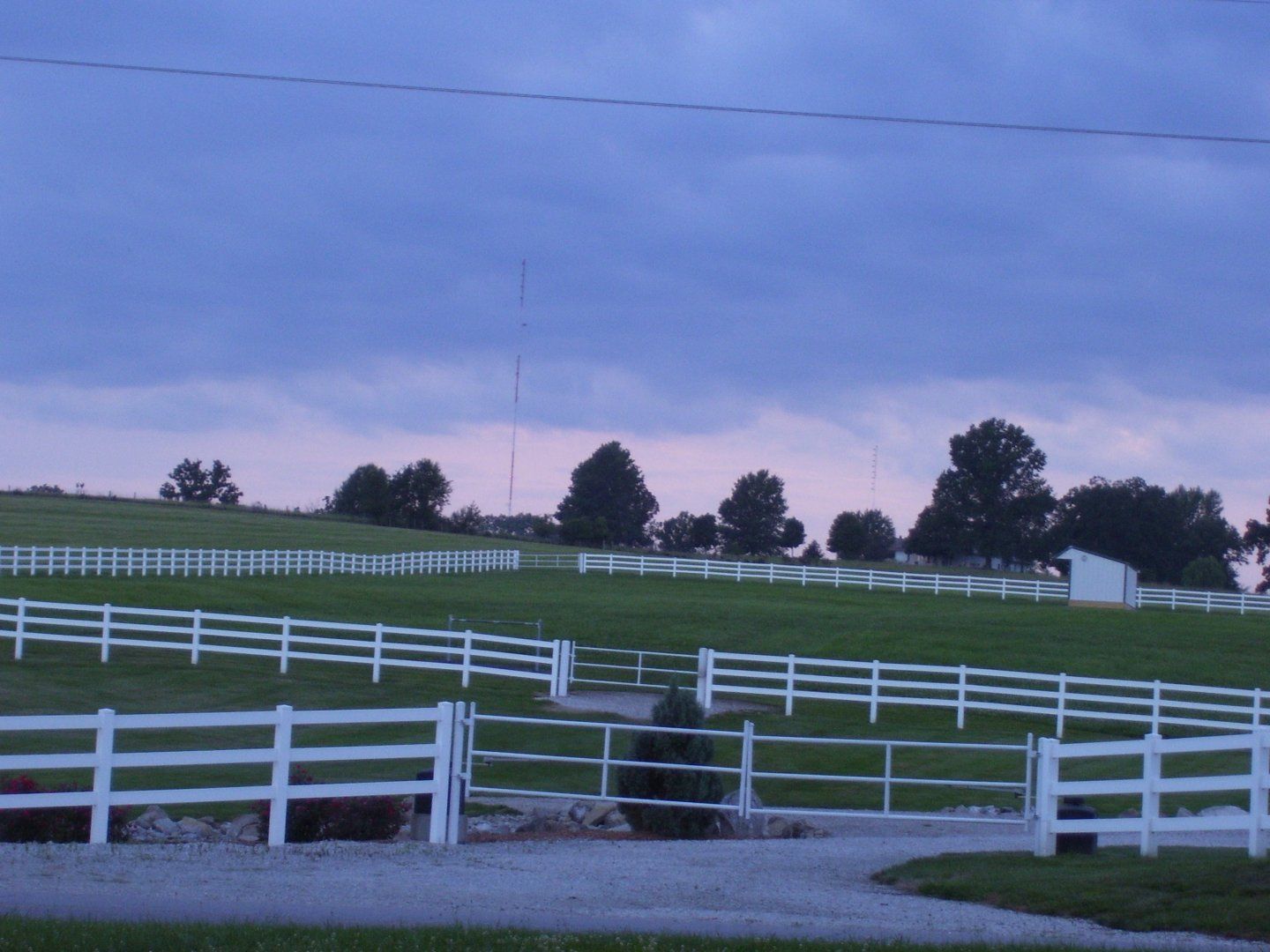

I have 2 commercial radio towers about a mile across from me. You can see them from the pic I added below which I took from my yard.
I believe the wireless antenna in the first picture is pointing towards those towers, so there's probable a transmitter on one of those towers.
