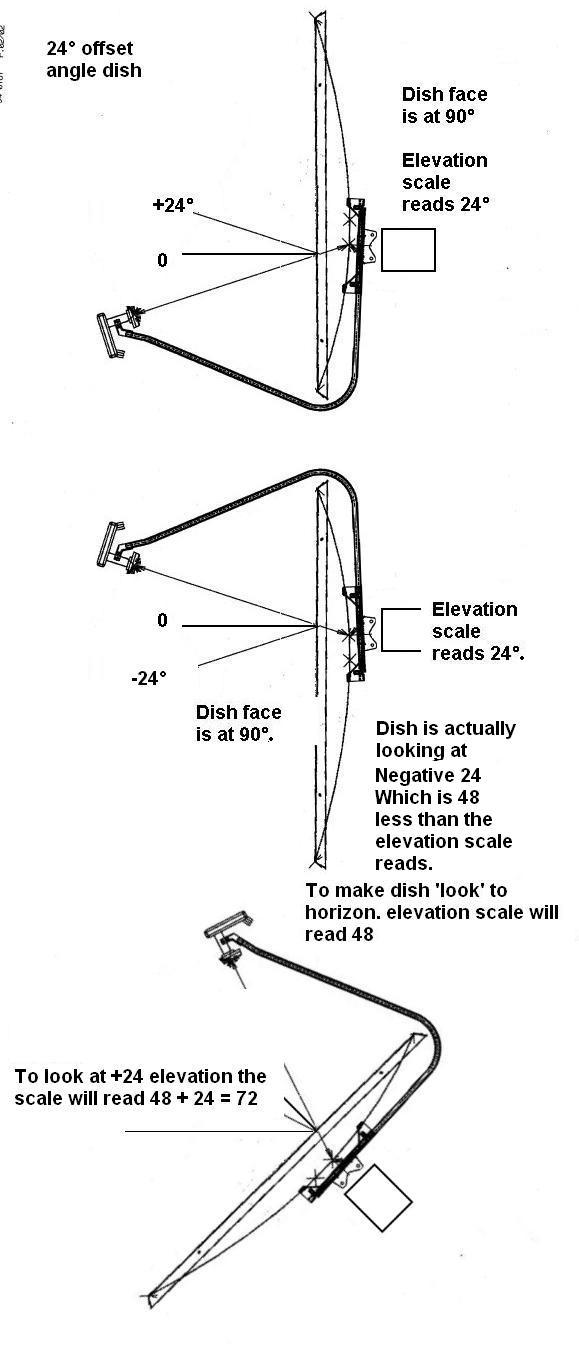

Should be a scale on the side of the dishes mount. Can the indicator on it be adjusted to 12?
If not, the usual way is to invert it on the mount.

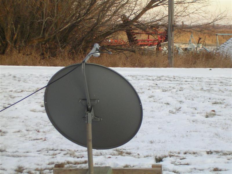

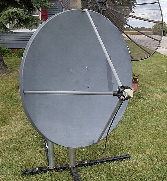

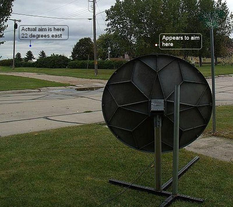

I have used the inverted dish, it works ok. You basically have to take the dish mount apart and install the LNBF arm upside down on top of the dish instead of the bottom where it usually goes, so the LNBF is pointing downward toward the reflector. I think I have some pictures:
Showing the back might help, picture can be worth a thousand words! This was set up last winter pointing at 30W. This year I set up a dsih with a motor attached to the roof using a 15' 3" mast. It is nice and solid, but in order to get 30w I have to run it east to the hardware limit of the motor using diseqc control (not usals). This works better than the ground mounting, I likely get some fresnel scattering with 6 degree elevation from here, so the higher up it is the better. 12053 is a fairly weak tp on that satellite though. Try for 11884 V 27500, it is quite a bit stronger. Once you fine tune that one you can try for 12053.
Did you also invert the dish itself? That's a requirement to keep the focal point focused.
In my case you have to otherwise the LNB arm will not fit over the dish. The mounting bolts through the reflector are not in the center as I would expect with most reflectors.
I should also mention just for fun... the spot where that Ku dish is located, right now there is about 5' of snow! :eek:
LNB skew is unaffected.
On another note, the mirror trick will work inverted also. (Or sideways even)
