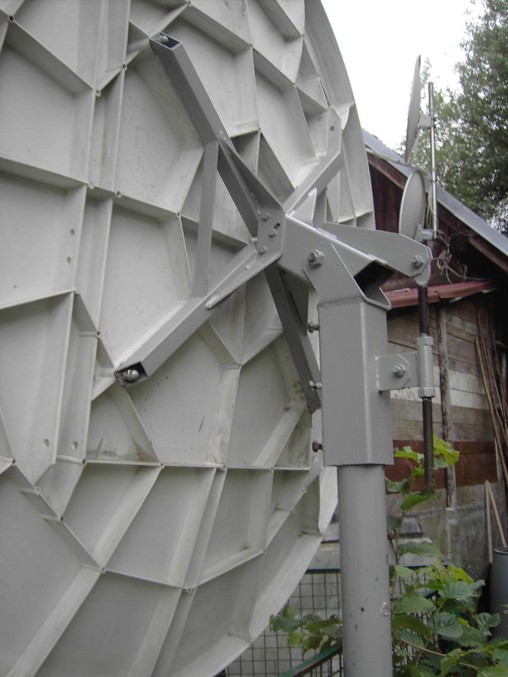

PICT3226 - Kopie.JPG (127.0 KB)
It couldnt be that easy as I said but the idea was on the right track. By the lower support arm will that cast a shadow? Now when you say 'if a satellite is not at zenith, find it's azimuth' Is this the azimuth that is on the Satelite Antenna Alighnment table eg Astra 2A/2B/2C which is 160.973° Then I look at the azimuth of the sun table see which time the sun is at that azimuth, then point my dish at the sun?

I have added a couple of pics of polarmounts i have found and mine as well, i am sure I canalter my to suit using some parts as the dish fixing,the pole mount and the threaded adjuster can be adapted. When I have something construction, a new can of worms will be opened.

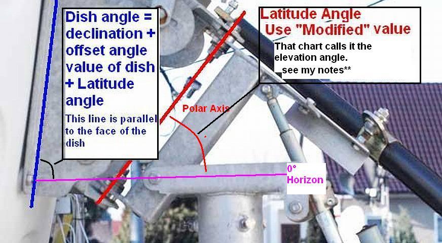

I threw together a picture to hopefully explain the angles involving an offset dish on a polar mount. See Attached:
Example (Angles measured at 'due south") :
Location is 47° North. Offset angle of dish = 24°
From the chart* the Elevation angle** (modified polar axis angle) is 47.65°
The Declination offset angle from chart" is 6.38°
Dish face = 24° + 6.38° + 47.65 = 78.03°
Testing/Confirmation: offset dishes "look" offset degrees up from the perpendicular of the face of the dish.
90 - 78.03 + 24 = 35.97°
Dishpointer.com says the satellite arc elevation at "Due south" with location at 47N is = Elevation: 36.0°
36 and 35.97 is close enough to = for me.
* Footprints by Dish Size - Latitude Declination Chart - C/Ku-Band Satellite Listing
** I don't like calling it the "Elevation" as it's easily confused with the elevation of the satellite.
