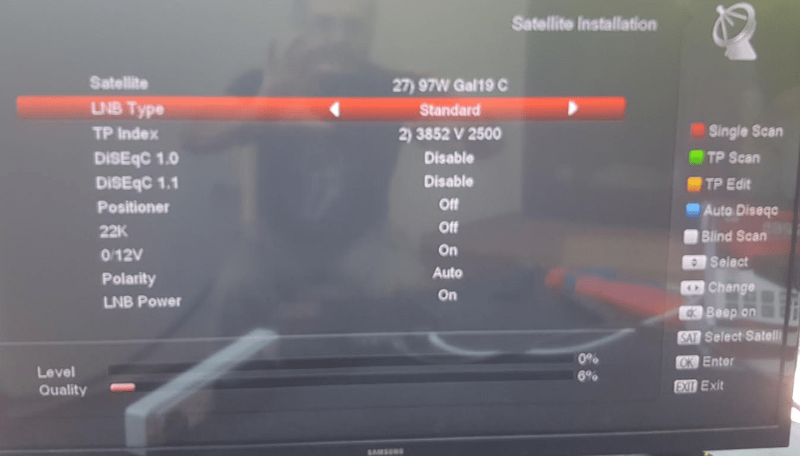

Hello Guys
Good morning!
Last night I got my new Amiko Mini HD265 FTA Receiver, and my MAVERICK KU BAND PLL LNBF , Great!!
I was checking out the receiver and just looking at the satellites menu I did not find the same settings as someone post it here for me in the Galaxy 19 satellite.
GALAXY 19 (97.0W)
LNB power.................ON
LNB Type...................Standard
LNB Freq....................10750
22KHZ.........................OFF
TP Freq........................(Visit Galaxy 19 at 97.0°W - LyngSat to find active TPs but maybe try 12152 H 20000 first)
DIESsqC 1.0.................OFF
Motor ............................OFF
but here is a picture from my receiver for Galaxy 19 settings,
one of my concerns is the TP Index line on my receiver vs the one above is TP Freq, I cannot match the same numbers
in my receiver, it just gives me 2 options and thats it.
can you guys let me know if the settings below are correct for the Galaxy 19?
also, my location Longitude and latitude are
My settings in my receiver it should be like this?
The recommendation says .....
To look up at Lyngsat for current TPs but where do I look for those values? , I don't see them.
Something else?

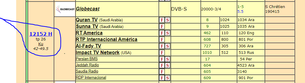

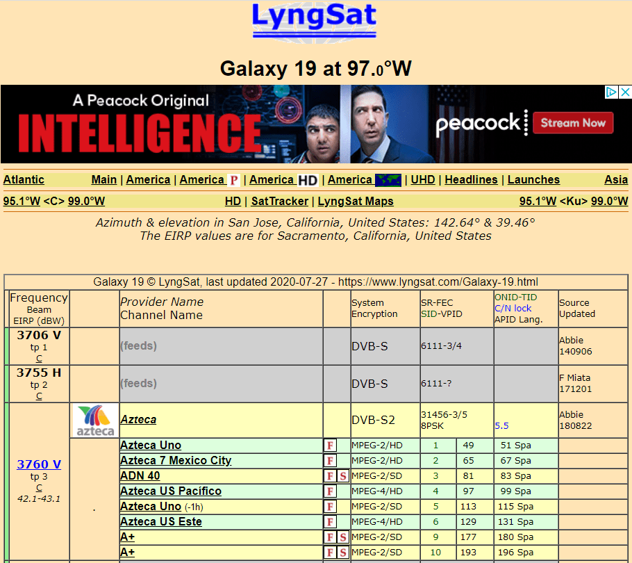

You have to scroll down on lyngsat to see the Ku frequencies. They'll be below the C-band freqs.
Down near the bottom of the page for 97W you should find 12252 H and RT America today. That would be a good one to start with. On the right side of the picture for your receiver setting the third option down TP edit should let you enter the info above if you can't find a preinstalled list for this sat.
If you are able to do this and can peak the signal to 60% or better on both the level and quality a blind scan will find lots of international channels. Please note if both scales are not showing then you are not on the sat and will find nothing.
Regarding streaming, lot's of the channels on 97W are available by streaming. Once again try running a search on "RT america streaming"

and I'm sorry but near the bottom of that page I don't see any value exactly like that only this one.
is that the one?
and how do you know that's the one I need to pick up versus the others above ?
Sorry for my stupid question but I'm not familiar with this chart.
Thanks again.
is that the one?
Yes that is the one. In your photo of the receiver above you are set to 97 C. You need to move one more satellite and you will see 97W Ku. :)
From there 12152 should already be in the list.
That particular one is chosen to give to newbies as that frequency is not used by adjacent satellites. This minimizes the chance of locking your dish onto the wrong bird. Once you find and have a good signal on that transponder, you can do a blind scan. :)

someone recommended me this LNB "Maverick" that supports KU Freq. which is great, but now that I'm going thru this deeper?
I see in my Lyngsat picture that I'm interested to get those spanish channels from Mexico "AZTECA" But looks like those use
C- Freqs
is that that I need to get the INVACOM QPH-031 Quad Polar Ku LNB FTA Satellite 2 Circular 2 Linear Outputs HD
or the MAVERICK will do it too?

No, a KU lnbf won't get c band. You will need a c band lnbf like the Titanium C1-PLL you mentioned in your first post and you can't get most c band channels even with a c band lnbf if you put it on a small dish. You need a large c band dish, like I mentioned earlier in this thread. :)

Most likely the AZTECA channels used to be on Ku and then got moved to C-band.
Perhaps that's why it is confusing you as to what will be needed to receive them.
Google "c-band dish images" to get an idea of what is needed.

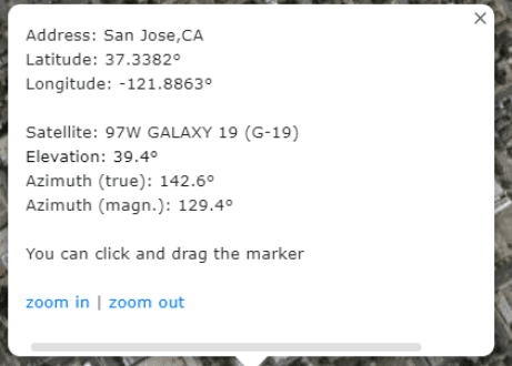

Hello guys
I'm trying to setup a Dish with "NO" motor, pointing to the Galaxy 97
here are my points of location I have:
If you notice the city location numbers are different than the satellite location numbers.
The city is calling Latitude and Longitude when the satellite location is calling Elevation and Azimuth.
Then, if the Latitude number is the same as the Elevation but they are a little different.
the city Latitude is 37.3382 and the Satellite Elevation is 39.4

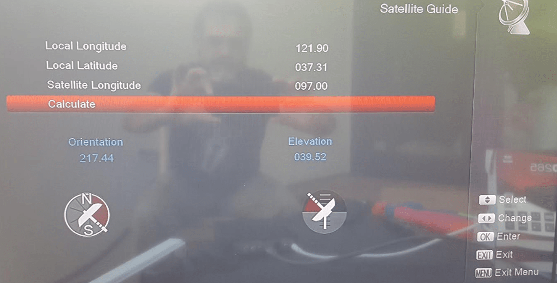

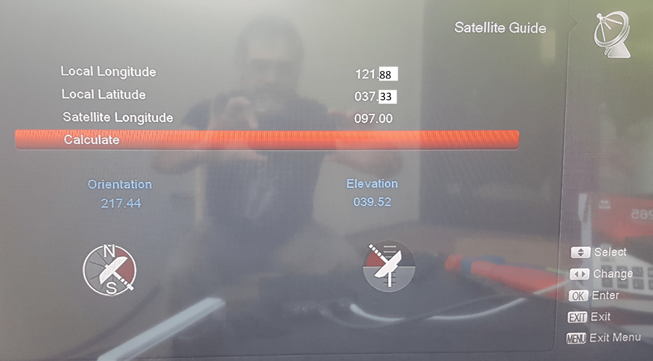

Now, in the receiver I got, Amiko Mini HD265 FTA Receiver.
I have this problem, in the page below to setup my receiver, well? I don't even know if this page is for me to setup the receiver or just for me to calculate the correct number? plus are those the numbers I supposed to put there?, I mean
for a fixed receiver with no motor, what numbers I should use?, the City numbers or the satellite numbers? in the page below.
the problem I have with this page is that every time I get out of this page my number disappeared, Does it supposed to do that?
the same thing does when I setup the satellite Galaxy 97, once I get out of the page, it doesn't retain the numbers.
why is that?
Since I'm testing, I have to re-enter these numbers over and over again.
why it doesn't save them? or how it supposed to work?

Your local longitude would be MINUS 121.89.
If you cannot enter the minus, then enter 360 - 121.89 = 238.11 (instead of - 121.89)
Same applies to 97W: should be MINUS 097; or 360-97 = 263.
It is just for you, those calculations, though, I think.
Normally only a motorized setup, using USALS, would require your LAT and LON for the motor angle calculation.

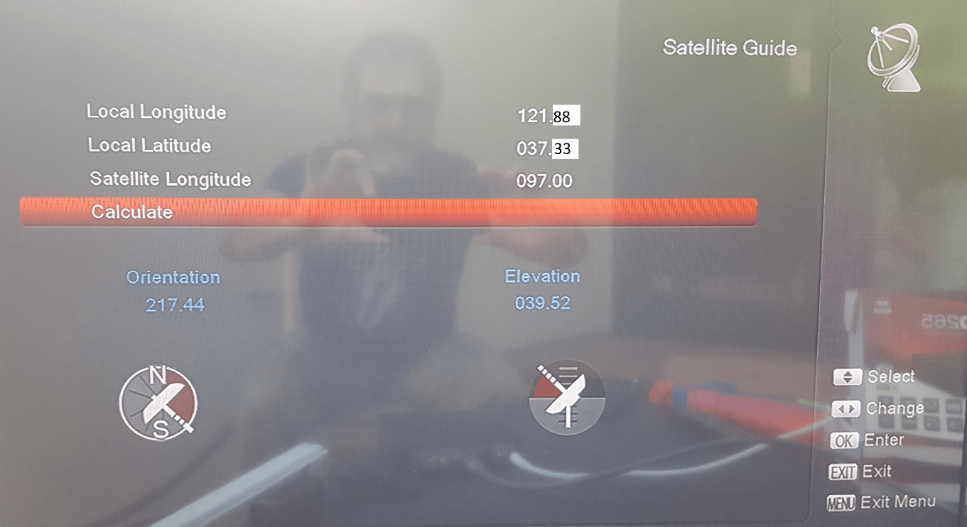

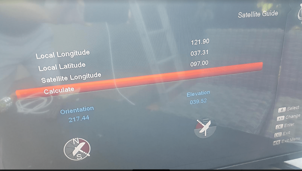

Does this help?
Greetz,
A33
Edit: Typo. in the decimals...
That is just something to help you aim your dish. As in giving you the angles you need when you are outside at your dish. So no need to save them. Also, you have them from dishpoiner I see. You don't enter those numbers anywhere in your receiver, unless you have a motor. The 39.4 is what you PHYSICALLY set your elevation outside at your dish. The azimuth is the general direction your dish will be pointing.
Since you don't have a motor, it's not necessary to put your latitude and longitude into the receiver memory. Anyway, once you get the dish elevation set, you'll move your dish, by hand rotating it on the pole, east of true south until you get a signal. If you can accurately determine where the true azimuth is, then you can get things in the ballpark by rotating the dish to point in that direction and then move the dish east to west or west to east until you get a signal. Sometimes the dish elevation may need to be adjusted up or down. If you're lucky you'll get a signal right of the bat. A satellite signal strength meter would be very handy in helping you get on target.
