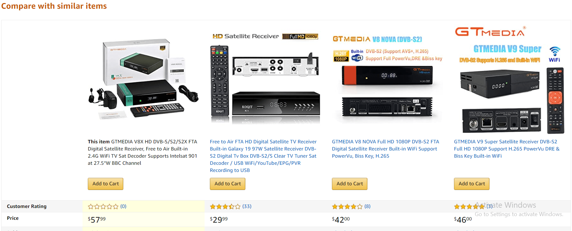

Notice:
It doesn't support 8psk turbo satellite channels
In other words this box will not assist you in hacking. Only channels that use that are pay channels. So, no worries for you, if you want true FTA. :) They left out the words hacking and theft of service so their listing would not get flagged on Amazon.
They compare to this but what's the difference?
"They" are not comparing to anything. This is Amazon's auto compare function.

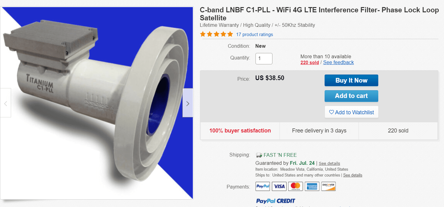

I'd like to buy this LNB
That LNBF will not work with your 30" dish to get what you are after. That is for a C-Band dish (the big 8-12 foot) dishes. You will need a Ku band LNBF for that dish.

On the dish bigger than 30" so I can use the LNB for C-band, is it worth it to do this?, am I gaining better things?
you know, it's like "the bigger the better", "what you pay is what you get."
I just don't want to lose anything interesting.

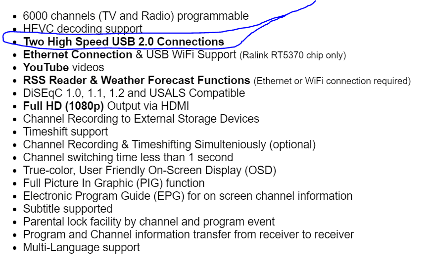

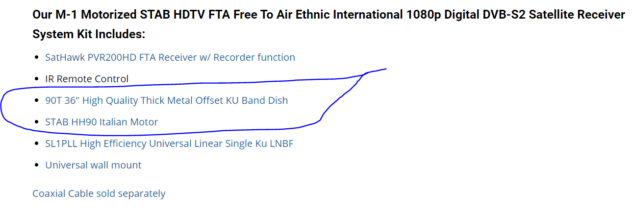

someone from the receiver you recommend left a review saying that he recommends to use a dish 36" or bigger for that receiver,
so that would go with the LNB C-band I want, right?
do you guys know for any good dish 8' or 10' or better buy in a package with LNB C-band out there?
if I buy the dish and motor from this package, is that would be a great kit?
Then I can buy the Amiko Mini HD265 FTA Receiver and LNB C-band separate.

The Amiko receiver and Maverick lnbf will work with the 30" dish that you have. If you can get a bigger dish (36") it will work better. As you said, the bigger the better. A larger dish will collect more signal which will allow you to lock more channels.
As far as the Titanium C1-PLL lnbf, that is for use with large c band dishes. Generally 8 foot or bigger is recommended for reliable reception. People do experiment with these on smaller dishes to see what they can get. Just keep in mind that they work best on large c band dishes and you will not get many of the channels that you will get on larger dishes and the channels you do get may come and go with signal loss due to rain.
There is a seller that offers large c band dishes and complete packages but they are not cheap.
A better option might be to drive around and look for an old c band dish that is no longer being used. You may be able to get it for next to nothing and many people will gladly give it to you just for removing it from their property. :)

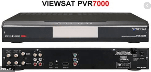

Last but not least question:
By doing these exercises with Satellites and Regular TV antennas, I noticed that the FTA Satellite dishes when they scramble channels you don't get the Local channels you get just using a regular TV antenna.
why is that?
I was assuming that when you setup a satellite dish FTA, you should get everything including your local channels.
Interesting.

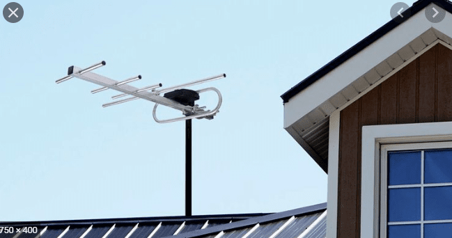

is there a receiver that I can hook up the satellite dish and regular antenna so I can get both?
I see my receiver has the antenna INPUT but it doesn't scan anything but if I switch the wire in a TV it will scan all my local channels right away.
also,
What's the difference from old receivers like Viewsat PVR700 to new receivers like Amiko Mini HD265 FTA Receiver,
WHAT am I missing if I use an old receiver?
Thanks
Have a wonderful time all.
stay safe
Freddy V.

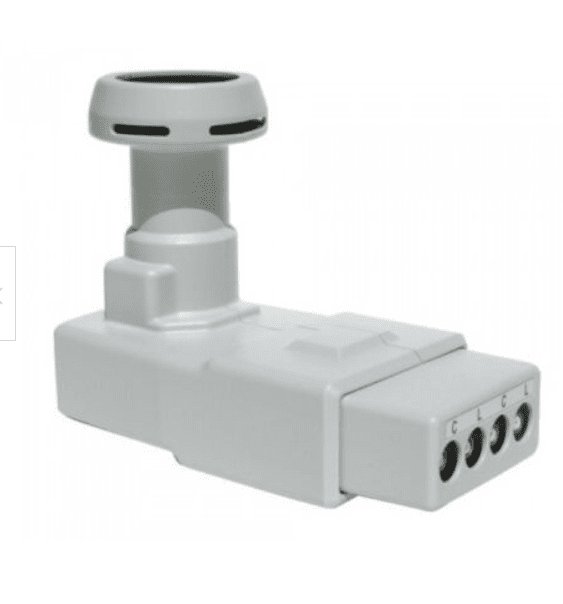

Also,
What do you guys think about:
the
INVACOM QPH-031 Quad Polar Ku LNB FTA Satellite 2 Circular 2 Linear Outputs HD

The Invacom lnbf is good for linear ku but in my opinion the Maverick is better. Also, the two circular inputs on the Invacom are not worth much these days as there are few if any circular feeds in the clear. :(

Older receivers do not support the formats/codecs that newer receivers have. You will get far less FTA channels using an older receiver as they are unable to scan them in.

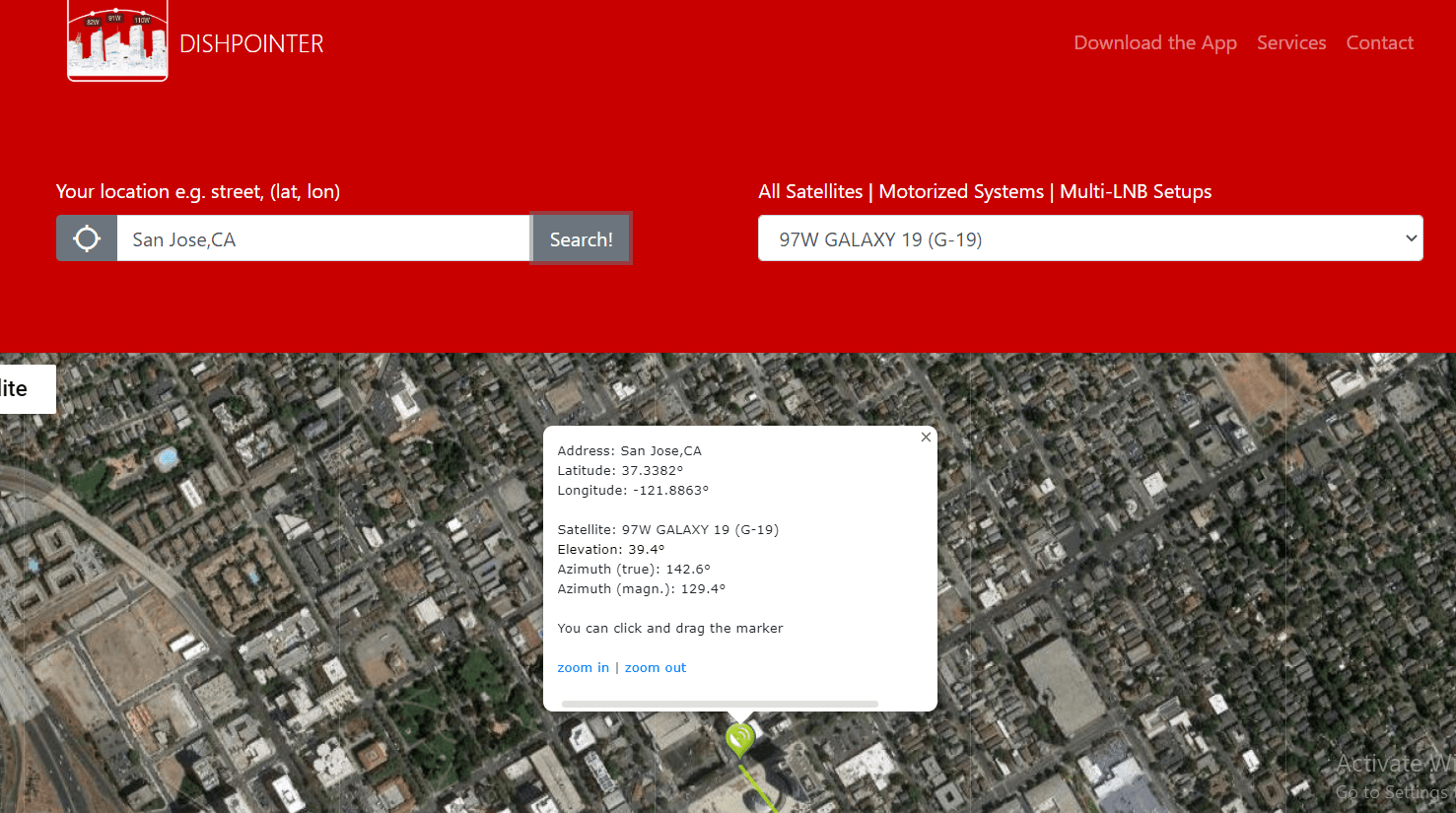

Hello there
How can I figure out what Satellite to choose to setup the dish?
the one that I need point to setup the first signal.
I have my Longitude and Latitude but now what?
here is my location
I just chose Galaxy 19 to the hell of it.
but my location for Longitude in my city is there. -121.8863 (as minus)

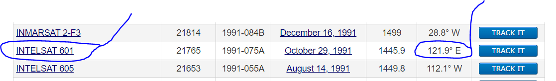

if I go to
The closest to -121.8863 is this. Except that is not MINUS.
I don't see any minus there, I'm a little confused which Satellite should I chose to set it up from?
Please, guys let me know, I'll really appreciate it.

Minus numbers just mean it is western longitude instead of eastern longitude. You can choose to aim at any satellite you have line of sight to. Take a look at North & South America - LyngSat or Satellites - North & South America to see what channels are in the clear on each satellite. On Lyngsat look for channels that have a red F in a box, on Sathint look for ones where the encryption is marked clear. Keep in mind that based on dish size you may or may not get what is available. Personally I would try for 97w first as it is fairly easy to lock. Getting that one locked and scanned in will give you a good idea of what is required and then you can try for others. :)

this is the thing:
I read that once you setup your dish and align to zero that you should pick up the closest satellite to your true south
since my Longitude is -121.8863 , I was looking to the closest to that, I didn't know you can pick any other one.
and actually I'd like to setup on the Galaxy 19, 97W in the first place.

Normally you line up on the satellite closest to your longitude. Looks like 121W is the one you want to start with.
Hello Guys
Thanks so much for your help.
Yes, you all correct.
I dont have a motor yet.
I will buy one later on
for now, I have a directv already up on my roof and I'd like to try using this , just to hell of it.
I'd like to experiment to see I can get with that.
first to use the Directtv LNB
then, change it to the MAVERICK
Then Put a new 36 dish with motor.
Thanks
