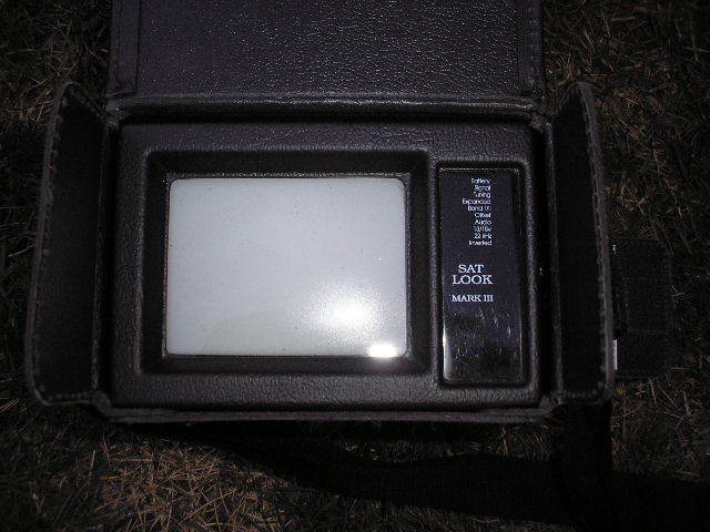

Using my Satlook Mark 111, Found great signals in the direction, according
to Dishpointer. Get no Quality at all. Any input appreciated.

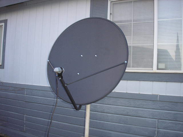

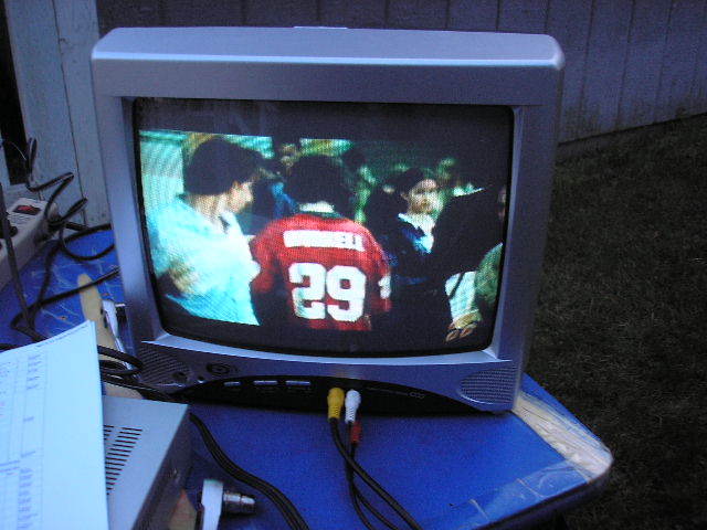

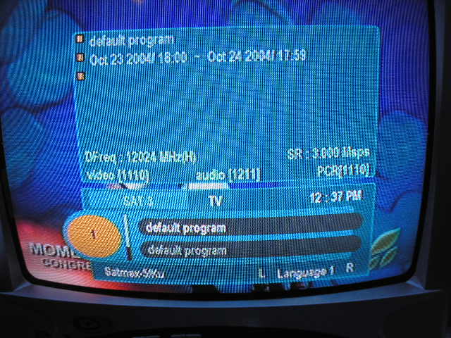

Ok. finally setup my tripod temorarily, to experiment. Found SatMex 5, but only
got 2 channels. Using of course geosat90cm, Pansat 3500, and the geosat bullet
universal lnb. lnb is set to universal 1
I get 12024 H, which is ESNE TV, also get 12165 H BYU channel.
Could not Find XEWT 12 From Tijuana.
Did a couple of sateliite scans, and also Blind Scan, which the 3500 has.
It was a little cloudy. Quality was going from 37 to 41, back and forth.
Also played around with the Skew on the LNB. But I am happy I did Find it.
here are some pics.

Use 11977 H, SR 1562, sometimes you'll get signal at 11974, sometimes at 11980, kinda weird that TP... LOL, but you'll have to wait at least 20-30 seconds for the signal to come.
SatMex has been having problems as of lately, one of the positioning engines or something like it, reducing 5 years it's service life, after that happened (2 weeks ago) i began to have stronger Q's in Tijuana's channel, i don't know if it's related or just a coincidence.
