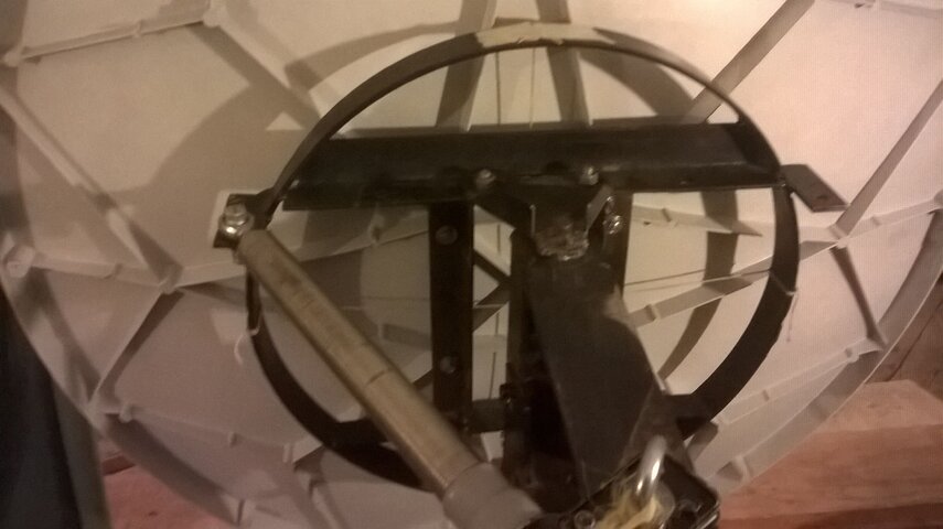

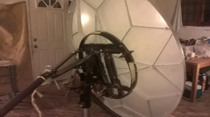

I picked up a Winegard 3100 1m dish and would like to test out cband. I've had Titanium C1-PLL and CS1 scalar just sitting in the garage for the last couple of months and I feel it is time.
I worked on mounting the dish and getting the hardware up last night and worked on the coaxle this evening.
The first and only problem I foresee in this project is the cband lnbf holder. The bracket that comes with the scalar does not seem to fit the lnbf arm. Another words it looks like I have to do some modification on the bracket holder to attach the Titanium C1-PLL. I've kind of drawn a blank on how to move forward.
Does anyone have any firsthand experience with this dish and the problem I attempted to describe?

The flat scalar provided with the C1PLL is for prime focus reflectors with FD ratio .3-.4 not the offset reflector with FD ratio .6-.7. So the conical scalar like the Titanium Satellite CS1 is the correct match to your dish type. The CS1 includes a 62mm clamp that could be adapted to place the feedhorn at the correct matching centered height, aiming and distance from the reflector.
Start by mounting the standard 3100 KU clamp and measuring the center height and distance from the reflector. Maybe make a template so flatbar, bolts/washers or other hanger clamps can be fashioned.

Unless I am reading it wrong it sounds like he has the CS1 already. As I recall those Winegard 1 meters were always problems for C-band small dish. I don't think they are actual 1 meters but the real problem that I recall is that they have a goofy LNB arm. Its like oblong or rectangle or something where the standard C-band conical scalar clamp won't bolt up to it.
I had to do some digging back to 2010 on this. I did some experimenting with a setup to adapt C-band small dish kits to widearm dishes. Have a look at this thread, it might work for you or give you ideas how to get it done. http://www.fridgefta.info/forums/showthread.php?tid=12715#axzz3IbHVRqWd

Hi ray224000. I have over the last few months experimented with my Winegard 1.0m for c-band. The general consensus seems to be that 1.0m dishes are undersized for mini budding. a 1.2m would be better.
i'm not suggesting abandoning the project .... its fun to experiment .... just trying to suggest an alternate view. don't forget some of the strongest c-band signals on 99w are recently gone. you didn't mention if you're motorizing. the winegard is a very heavy dish as you know which puts a lot of strain on a ku motor. I had mine on a stab hh120 & it still struggled near the ends of the arc. so I gave up on that setup and picked up a channel master/skyware global 1.2m and modified a spare c-band polar mount to accept it. very similar to this thread http://www.satelliteguys.us/xen/threads/another-channel-master-polar-mount-attempt.201238/ here's what I did. I didn't like the way crackts solution put the dish so far away from the mount. it might vibrate a lot in high wind areas. WP_20141111_001.jpg WP_20141111_002.jpg
try putting the winegard on a polar mount. I live in Canada so i'm not sure if impakt still has polar mounts https://www.impaktproducts.com/Mounts-and-Pipes-p-1-c-305.html if not find an old 7 foot mesh dish and use the mount.
have fun :)

It's been about five years or so since I used my wineguard for Cband. I remember hitting the dish and the bottom cband bracket snapped.
What I did was use the bottom bracket for 40 mm ku band and top bracket from the Cband. Had to just drill bigger holes in the Ku band bracket. This worked fine. When I got the dish it came with a 20mm bracket, which I still have. But I know the 60mm cband bracket should work. Just a matter of placement and some dremel work.
