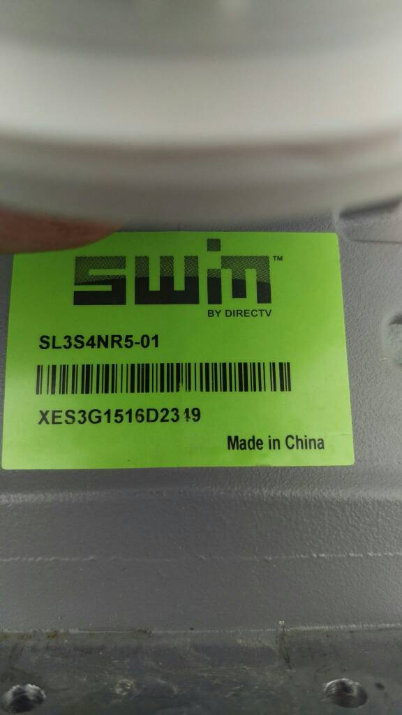

This in my lnb. Using with h25-700 receiver
Are you sure the PI is good, 21 volts coming from it, maybe 29 depending upon the model? Has the lnb worked in another setup? How about the H25?
