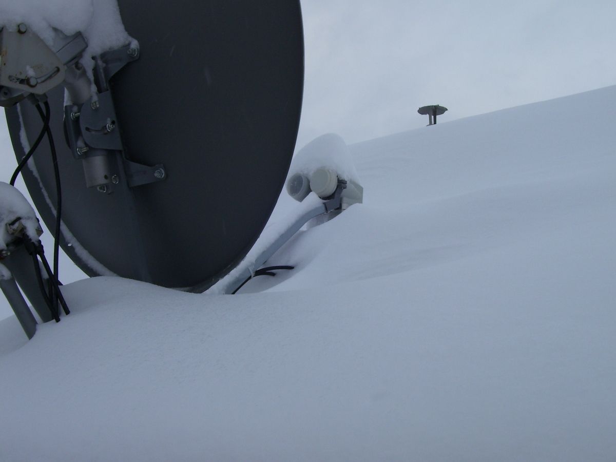

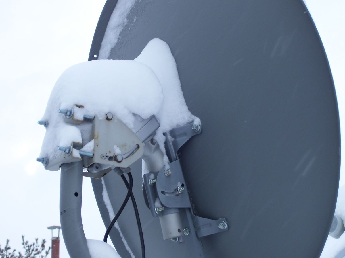

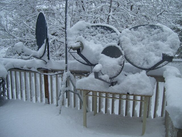

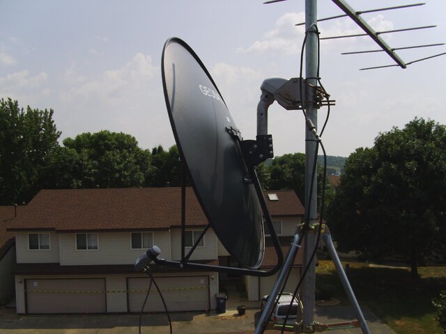

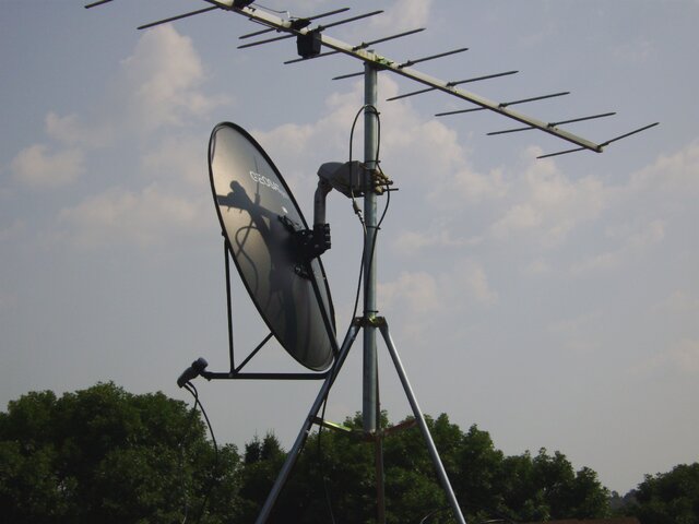

I used the same SG2100 motor here in Minnesota for 8 winters...and it survived just fine moving in the bitter cold (where in January minus 20 is common and minus 30 is not uncommon)
(so cold that you actually THOUGHT a little bit first if it was worth going out and working on the dish farm)
This was one of the few times I didnt move the dish (for obvious reasons) ;)
(and not due to the snow on the motor either)
