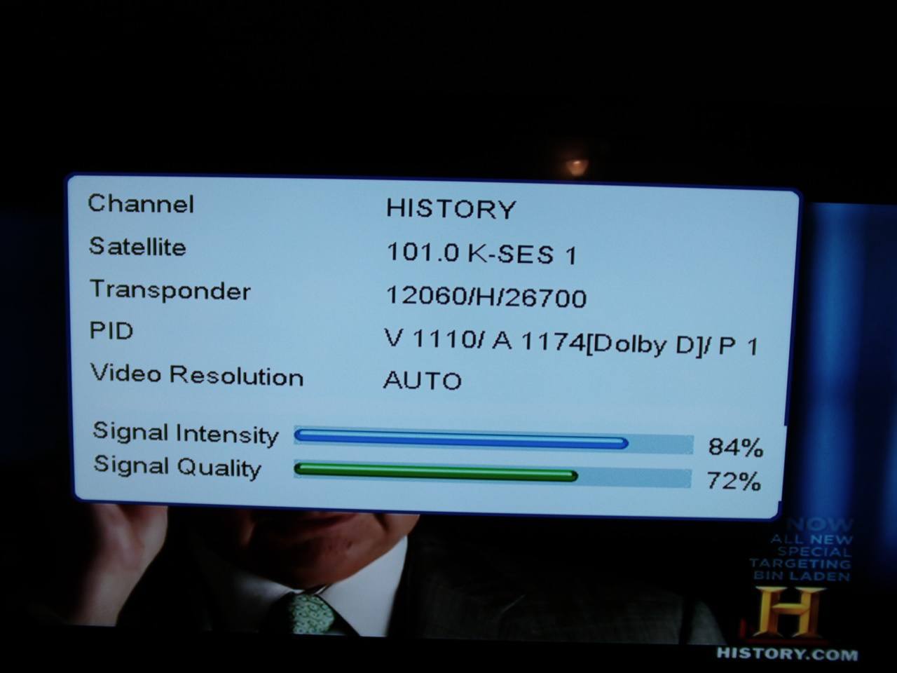

The sun doesn't apply only to the reception site, It also applies to the uplink side. Just because the sun is not inline with you, don't mean that it is not inline with the uplink site....... There are also other variables... Been watching most of the day and here is what I have... except when the sun interferrs at my place and the uplink side. Twice a day..
