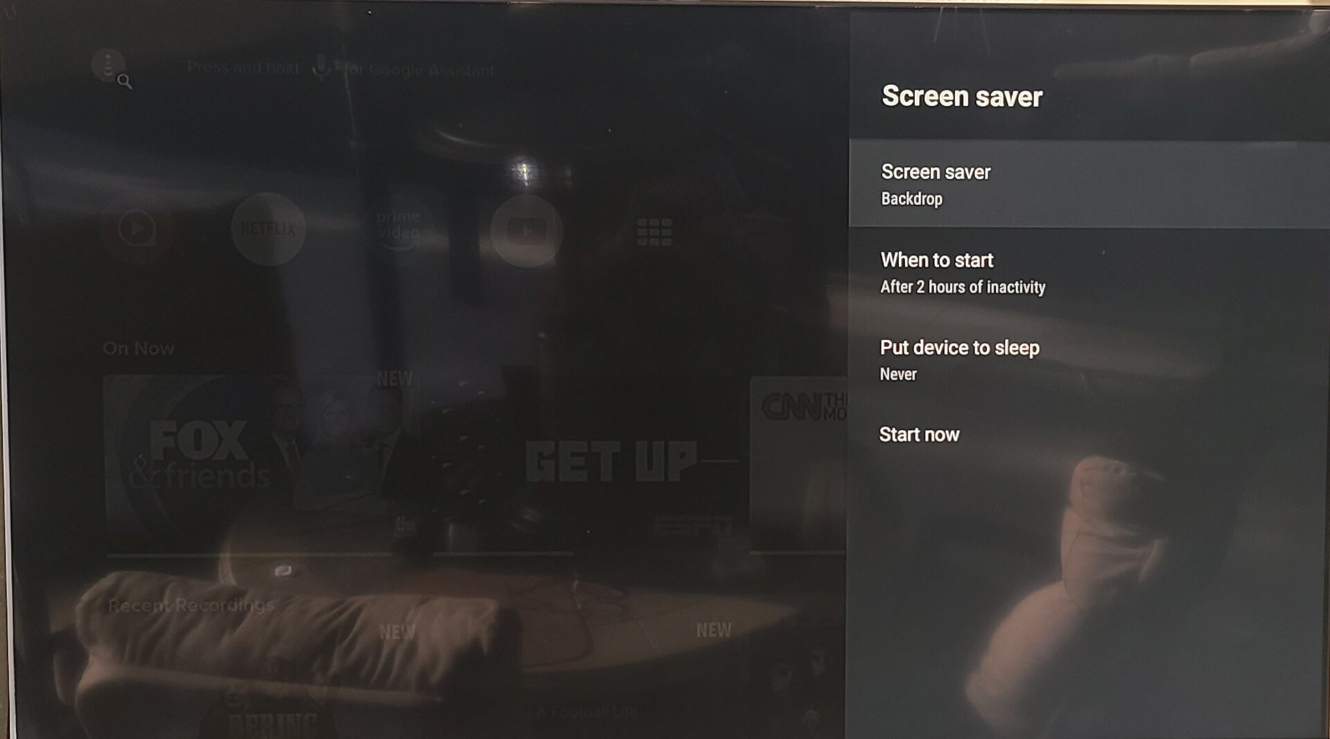

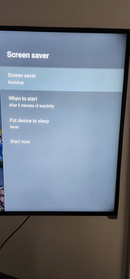

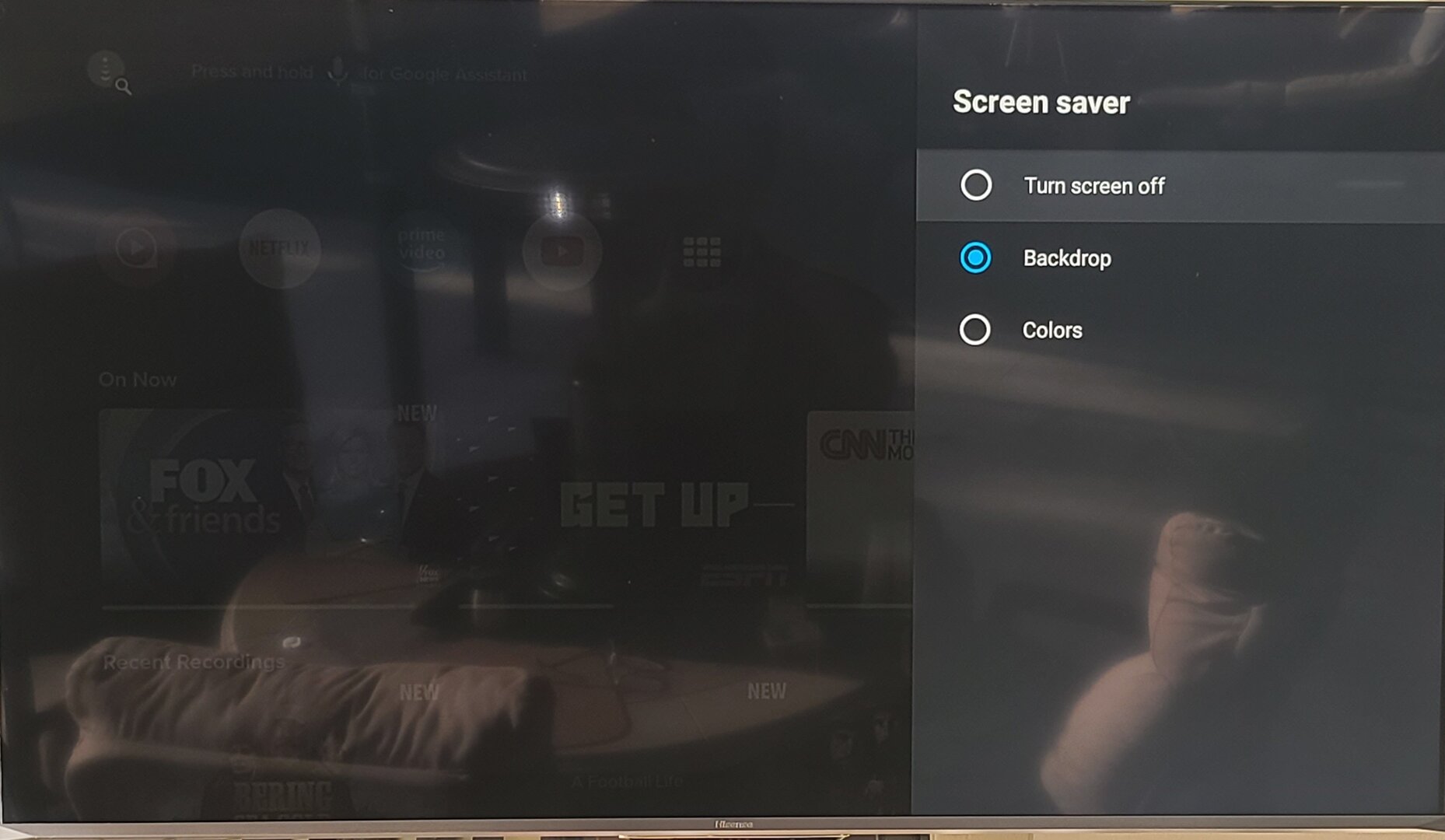

Just curious, what do you have screen saver set to on the WJ4 under device preferences? If you have it set to "Turn screen off" Try changing it to one of the other 2 options. Also try putting your settings like this...
Just curious, what do you have screen saver set to on the WJ4 under device preferences? If you have it set to "Turn screen off" Try changing it to one of the other 2 options. Also try putting your settings like this...View attachment 160363View attachment 160364
Screen saver is not set to off. It is the bubble one. When I get home will take a look at those settings. Thanks.
Ok BTW re read the one option. It confuses people, it says "Turn screen off" not "Turn screen saver off". Choosing that option will actually make the screen go black as a screen saver. ;)
Both WJ4s screen saver are set to Backdrop. What's your thoughts on why the CEC Less adapter does not work?

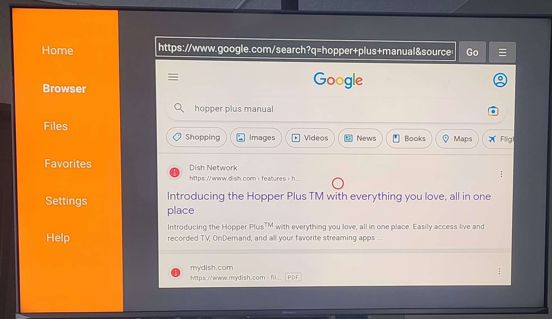

Again like I mentioned try the Downloader app's browser. I just did it using your criteria and had no issues moving the red circle to each result and selecting it using the arrow keys and select button on the remote. BTW I just installed the app you're using and even though I didn't have any issues it is way too confusing. I think you will enjoy the downloader app more.
I don't know-maybe I have a defective H+.First time install was definitely corrupt-everything locked up.Uninstalled and reinstalled.Still couldn't select anything.Tried a yet another browser with similar results.Also I get a black screen when accessing Netflix. The other night Prime had issues playing anything(Roku played Prime and Netflix fine).Last night Prime was ok.
