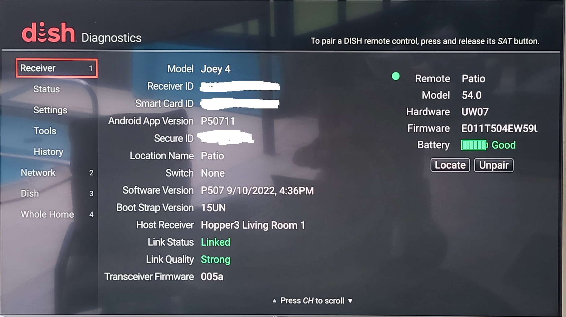

Where is the J4 & WJ4 APK in the diagnostics menu?
It doesn't show up.
What did you mean then?
The receivers use an Operating System. An APK is not an operating system, it's a package that runs in the system. There are a LOT of packages in the OS's on each receiver. So I don't know what exactly the Joey and Wireless Joey 4 APK's are

I believe the APKs are showing up as the Android App Version in the Diagnostic screen. If you look at my picture I am on Android App Version P50711 and the current one you posted is
Joey 4 APKP51101

I see a lot of people trying to update their Joeys, but forgetting the software comes from the Hopper in the first place. Android TV does update from the internet from what I've seen, but the base software is still delivered from the Hopper. Can you guys check the "Available Joey Software" section in diagnostics on your Hopper's? If P511 does not appear there, it probably doesn't matter how many times you place the Joeys on standby, it won't update. Also, there should be an option to redownload Joey software on the Hopper tools, if the Hopper updated but the Joey software did not that might be worth a try.
I'm being told my Joey 4 is in standby mode every time I push the power button. I do that every time I'm not watching TV. Could it have something to do with having the HP disconnected?
The joey must be connected to the Hopper at all times. All programming and recordings come from the Hopper.
The Joey is nothing but a terminal connected to the Hopper (server).
