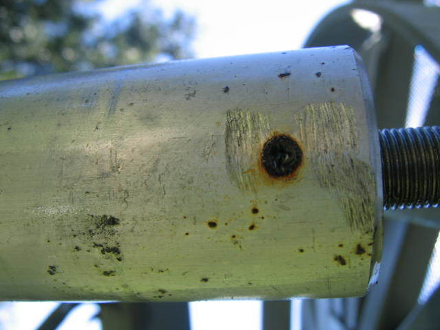

What causes an actuator to make a loud grinding noise on the downstroke? Mine grinds so LOUD you can hear it inside quite clearly. Drive it up the arc, no noise. Sounds like its coming apart! :(
Have you ever oiled it? Mine was making a lot of noise so I ran it as far west as it would go, drilled a quarter inch hole on the top of the arm so I could see the screw and poured 90 weight gear oil into it. That seemed quite it down a lot so now every fall I dump some oil in it to get it through the winter.

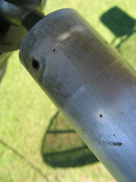

Gabshere and I are swapping PM's on it right now. On the eye end of the arm there are two holes already drilled, top and bottom of the arm. I got my squirt can and tried to squirt some oil in there and it won't go. I took a scribe and poked the holes, they seem to be clear...might need to drill them bigger. The holes are in the second and third pic.

I forgot to tell you that after I put the oil in the hole I would run it all of the way to the east then run it back to the west and add some oil then run it back to the east. I did that maybe five or six times. It really worked the oil in, which was good, because I had never lubed it before.
Jim,
I took your advice, drilled a 3/16 hole in the top of the arm, took my squirt can with 10w30 synthetic in it, just started pumping it in there, moving it east to west as I did it. Seemed to have worked much better, just a few spots with the grinding noise.... I put quite a bit in there, did you mean to say that you filled the tube ALL the way up? Like completely full? I have some Mobil 1 Synthetic gear oil, tomorrow morning I will fill it up to the top if that's what you meant. :)
Stogie,
I didn't "fill" it up if you mean like filling your gas tank. I just keep squirting a little bit at a time then moved the dish and squirt some more. I did that until it started to quiet down. By moving the dish the screw would rotate and spread the oil up and down it and into the device that made the screw draw back and forth. NO, don't fill it completely, I don't think that would be good. Do it just enough to get the screw well lubricated. I would say I used maybe 2 pints of oil the first time I did it, since I now do it on a regular basis it doesn't take so much. One time I used grease and that didn't work too good. The grease fitting is right next to the drain hole and it clogged it up. When I noticed that I cleaned the hole out and water drained like it was coming out of a faucet. GREASE IS A NO NO!!!
This came about because my original arm broke. The screw was rusted and just snapped. My late father, who was a machinest, among his other trades looked at it and said in a playful father and son moment: "have you ever put any oil on this?" When I said no, he just shook his head and said "dumbass." He gave me the idea that I have just shared with you. He also had me use the 90wt gear oil because he deduced that since the arm had a hole at the bottom for water drainage that light weight oil would do the same. I've had this dish for 24 years and this is my second arm. I would probably still have the original if I would have been smart enough to do this in the begining. The "old man" has been gone since '97, so I would say it was about '90 or '91 when we did this. As a matter of fact since you brought this up I think I will do it tomorrow. Usually I forget until it's about 10 degress with a 20 mph wind then I freeze my butt off doing it.

Well guys, I went out this morning and serviced the arm and motor. I squirted maybe a quarter of a pint of oil in the arm and took the cover off the motor and shot some WD40 on the gears and the screw. The only noise I hear is the motor purring like a kitten. :):)
I have to say, at one time it was pretty loud. I could hear in the front room. The wife would complain about me keeping her awake because of the noise, the bedroom window is about 20 feet away from the dish, since I started keeping it oiled I run it any time during the night and I haven't heard one complaint from her. Now if I could just master everything else in this 30 year marriage.:)
Well....I wish my news was better. But MY problem is in the motor. I brought the positioner box out to the dish this morning, some gear oil, I was ready to rock. Hooked up the box, started moving the arm...the motor started howling like its was seizing up. I've burned up electric motors before...so I know what THAT sounds like...:cool:
So I oiled the arm good, but the motor is howling like a tortured cat. Can you change out just the motor? I wouldn't see why not unless the gears aren't universal. Doesn't look like much holding it on there, two bolts all the way through, some wires, should come right out. Am I missing anything?
