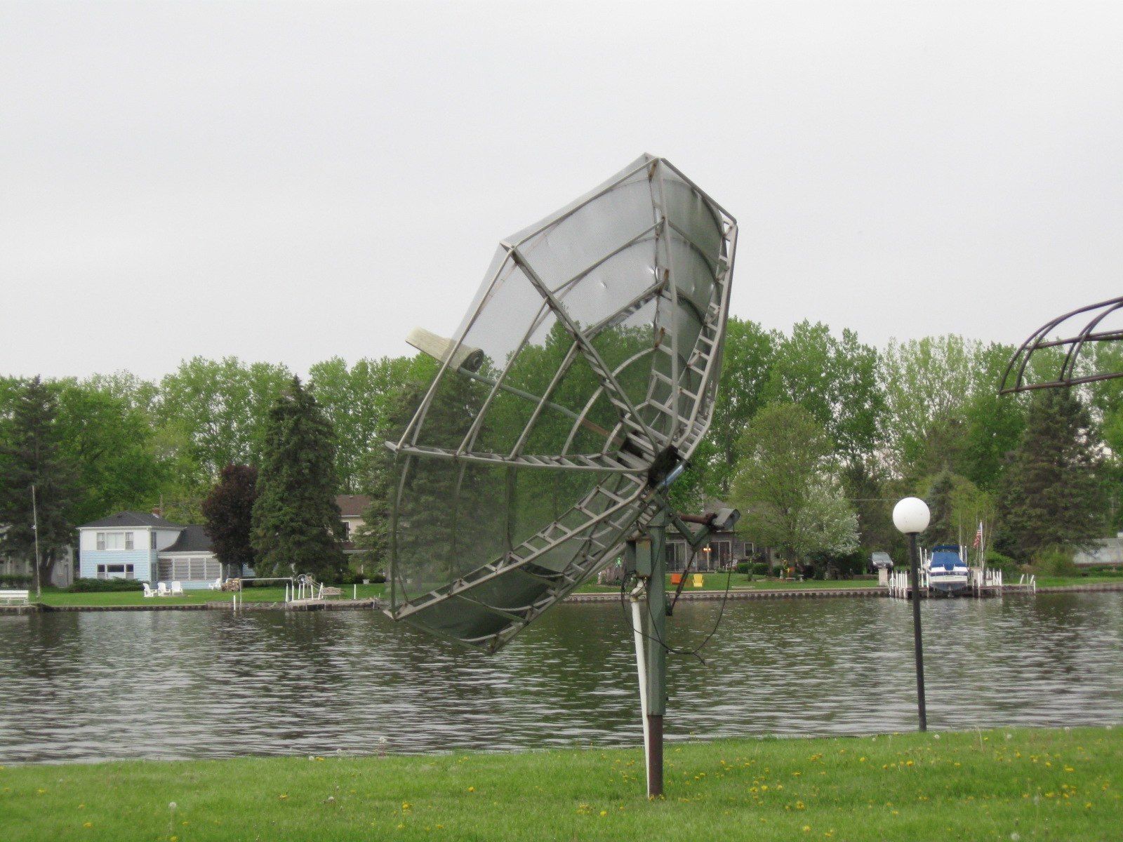

chain-o-lakes
Has this been done before? Can it be done? Anyone got any ideas? Is it worth the trouble? 12' is a little wide for the roads here, but I've only got 7 miles to go. Four bolts gets the dish off of the mount and then I can lay it flat on the trailer, button hook and all. Here's some pics, looks like it's in great shape with the exception of 3 small cuts in the mesh about 3-4" long which should be easy to repair.

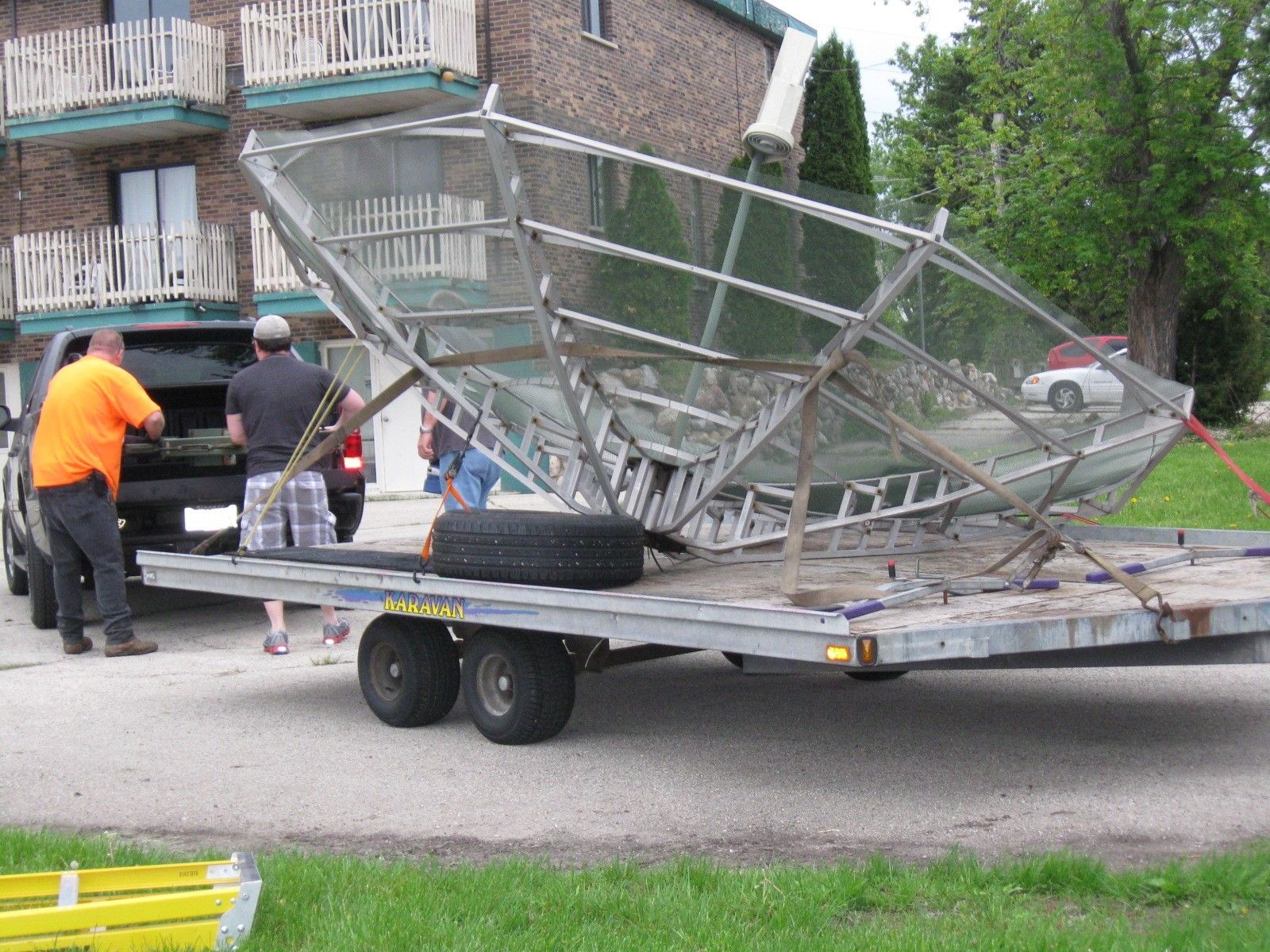

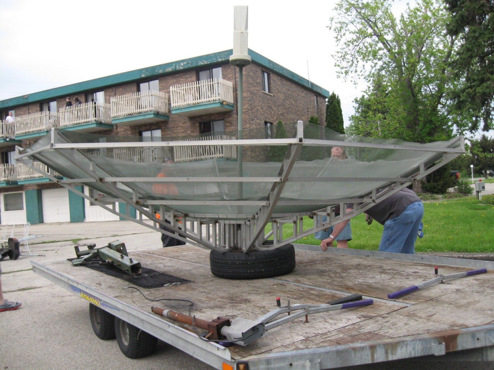

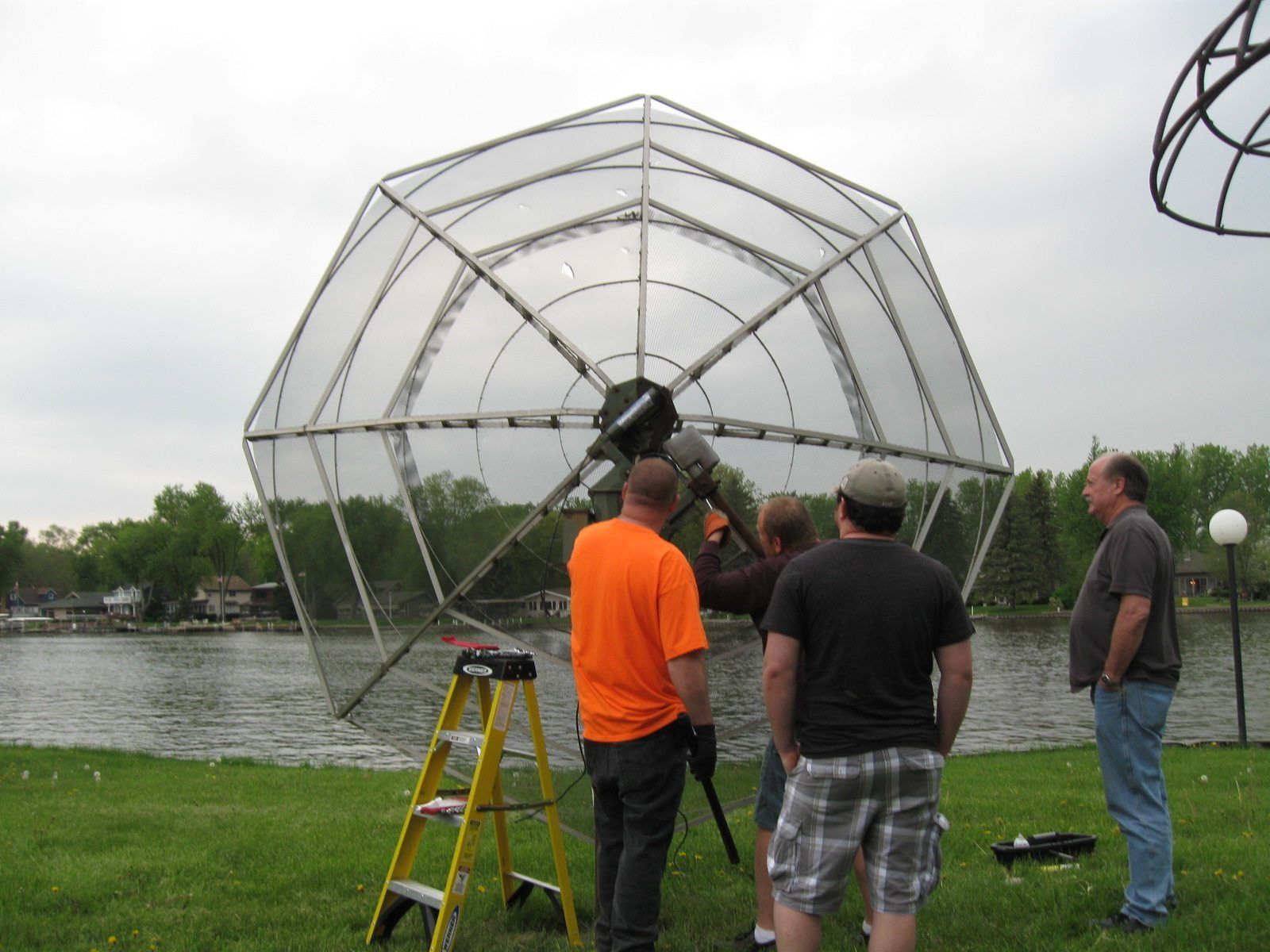

Alright, despite intermittent rain as we started, three generous souls and I got the dish down, the mount removed, and loaded the dish on the 8.5' trailer for a mock up so I would know what to expect.
While on the trailer my father in law pushed one side down and asked if that would help with narrowing the load, it sure did. With the dish cocked on one side and resting safely on the trusses it only had one foot of overhang on the low side. The high side looked like maybe the same, you can judge from the pics my 7 y/o son took.

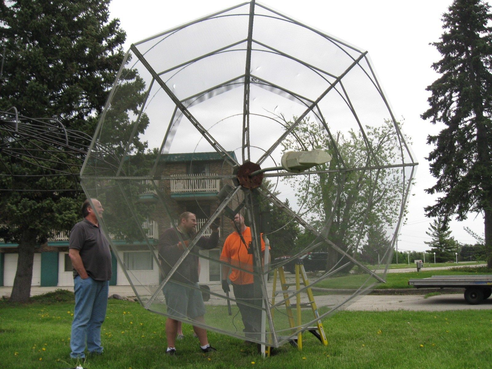

We removed the 4 bolts that hold the assembled dish to the mount, it was awkward but with four big guys went smoothly. Once on the ground it was a cake walk as far as handling the dish was concerned.

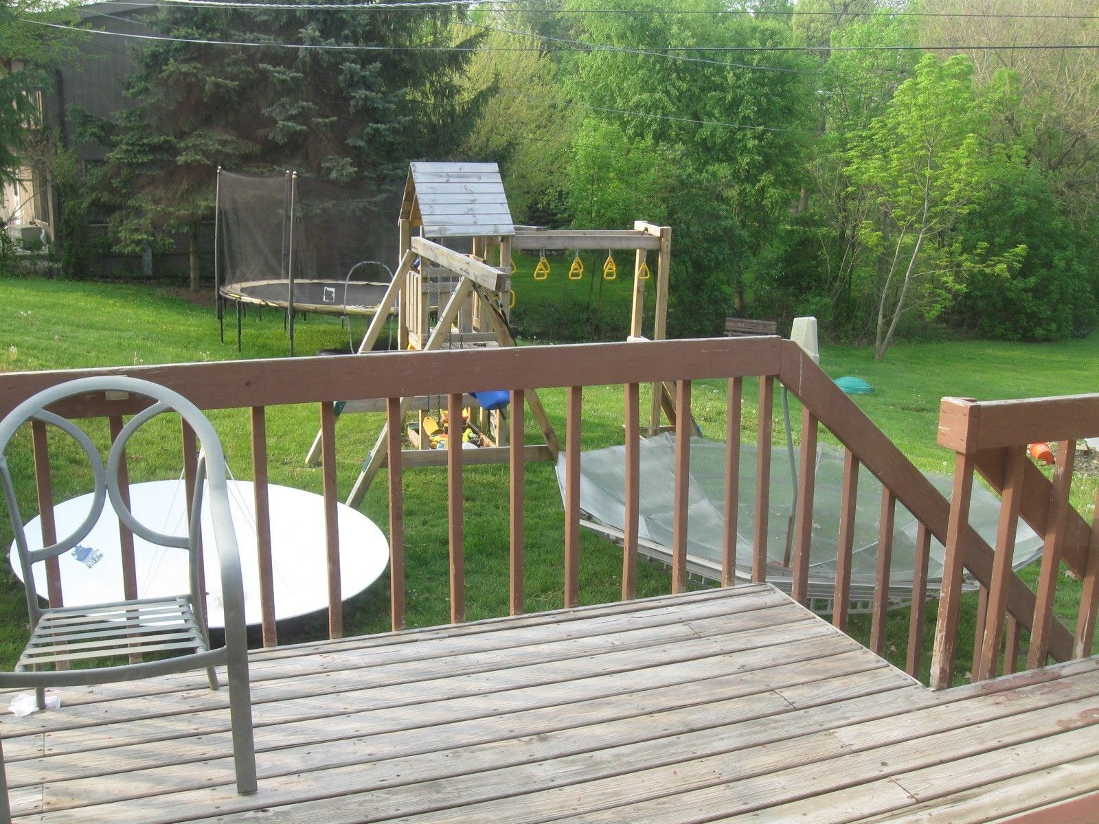

In my backyard, next to the Birdview, that 12' Paraclipse is HUGE!!! It didn't look that big out in the open, especially next to the river.

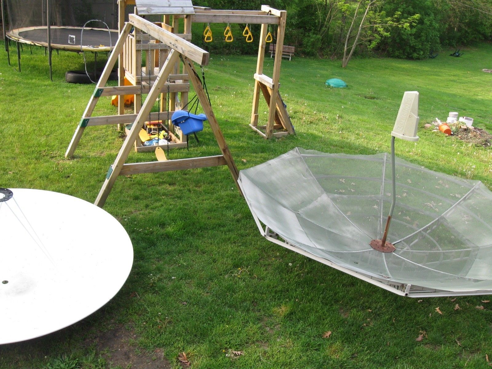

Mmmm, what to do. Get the Unimesh down off the pole first I guess. I'm afraid my mounting pole will be too short to have the dish completely vertical. dishes 003.JPGdishes 001.JPG
12' Paraclipse or 9' solid Birdview, your opinions please.
