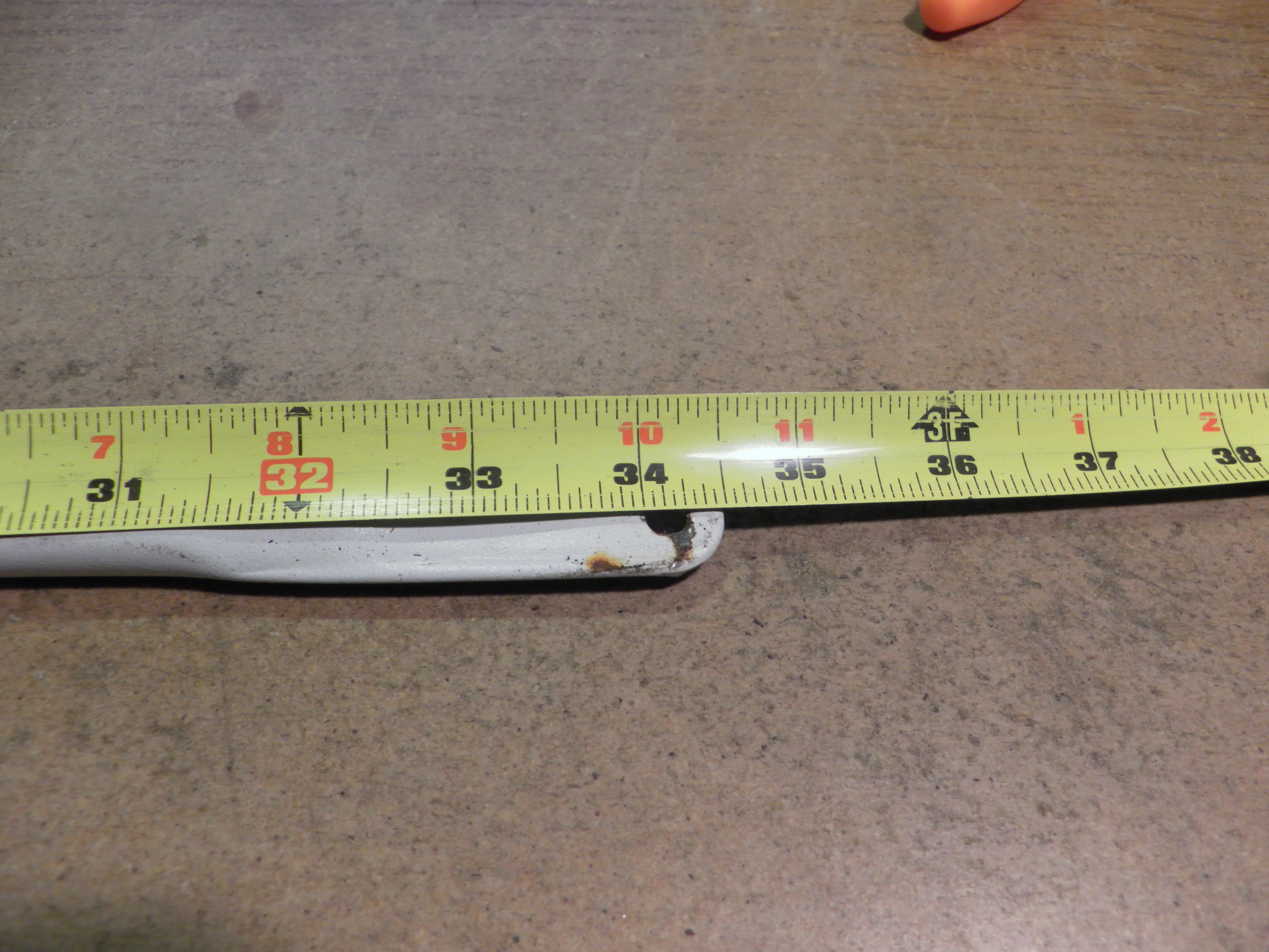

I have the WSI $69.00 special and for the past three years rust has been eating away the tripod (lnb holder). I need to built a new tripod but I have no clue how long the arms are supposed to be. The ones I have right now are so bent and mangled that it is almost impossible to get an accurate measurement.

**According to the parts sheet here: http://www.satelliteguys.us/downloads.php?do=file&id=309 the focal length is 26 3/8- 67cm (?) and F/D is .38
#2, LNB Supporter says 12x980mm pipe
How helpful that is is questionable. Think I'd somehow support the lnbf at the proper position, and then measure/fabricate supports. (Focal point should fall around a 1/4 inch inside the throat)

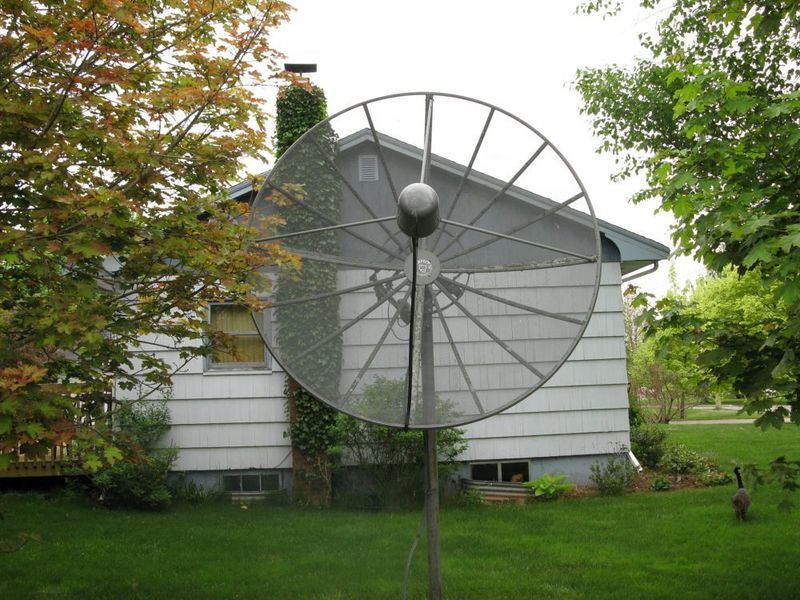

Take a look at the 8' perf in my signature. Very stealthy. :)

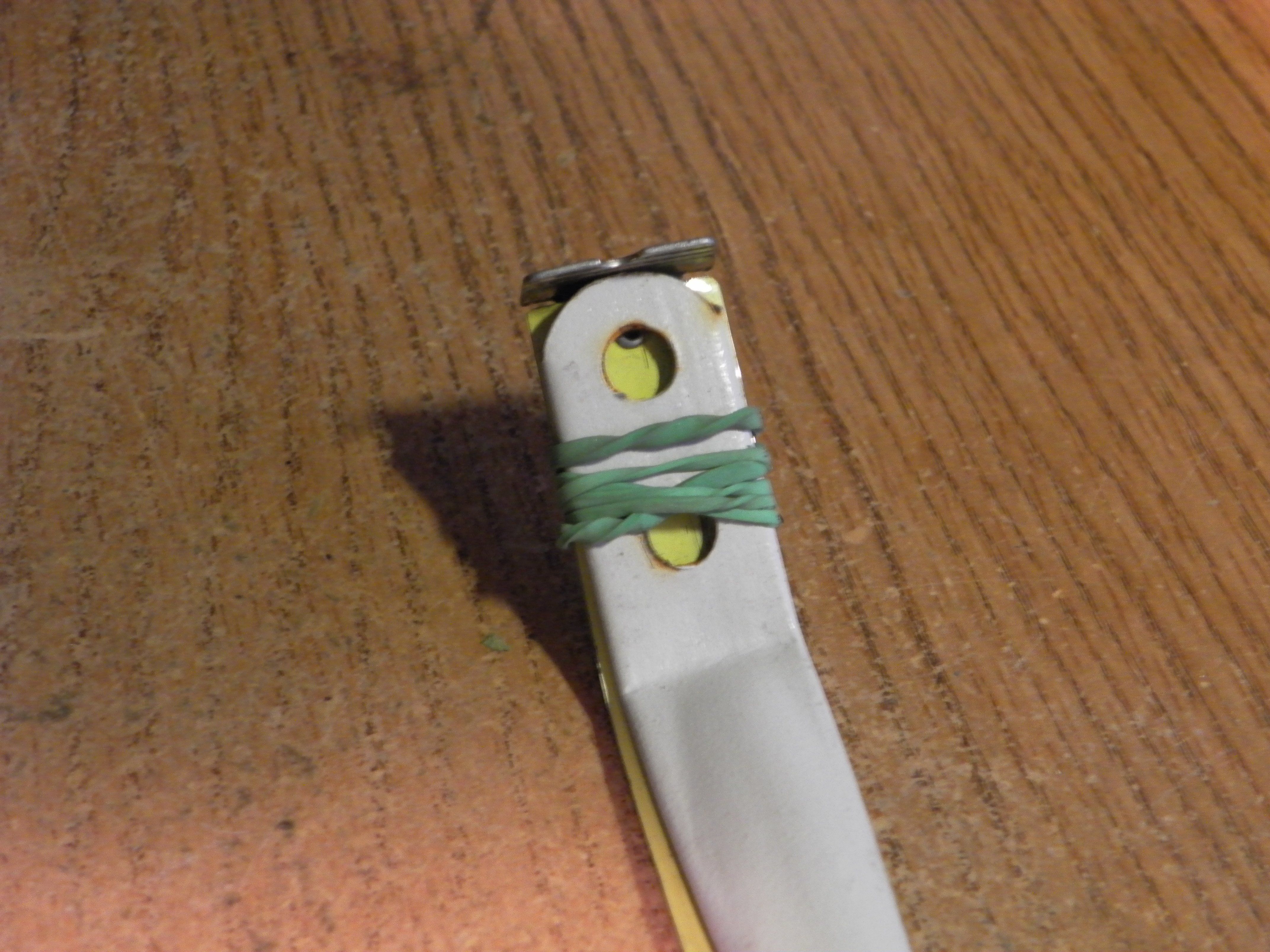

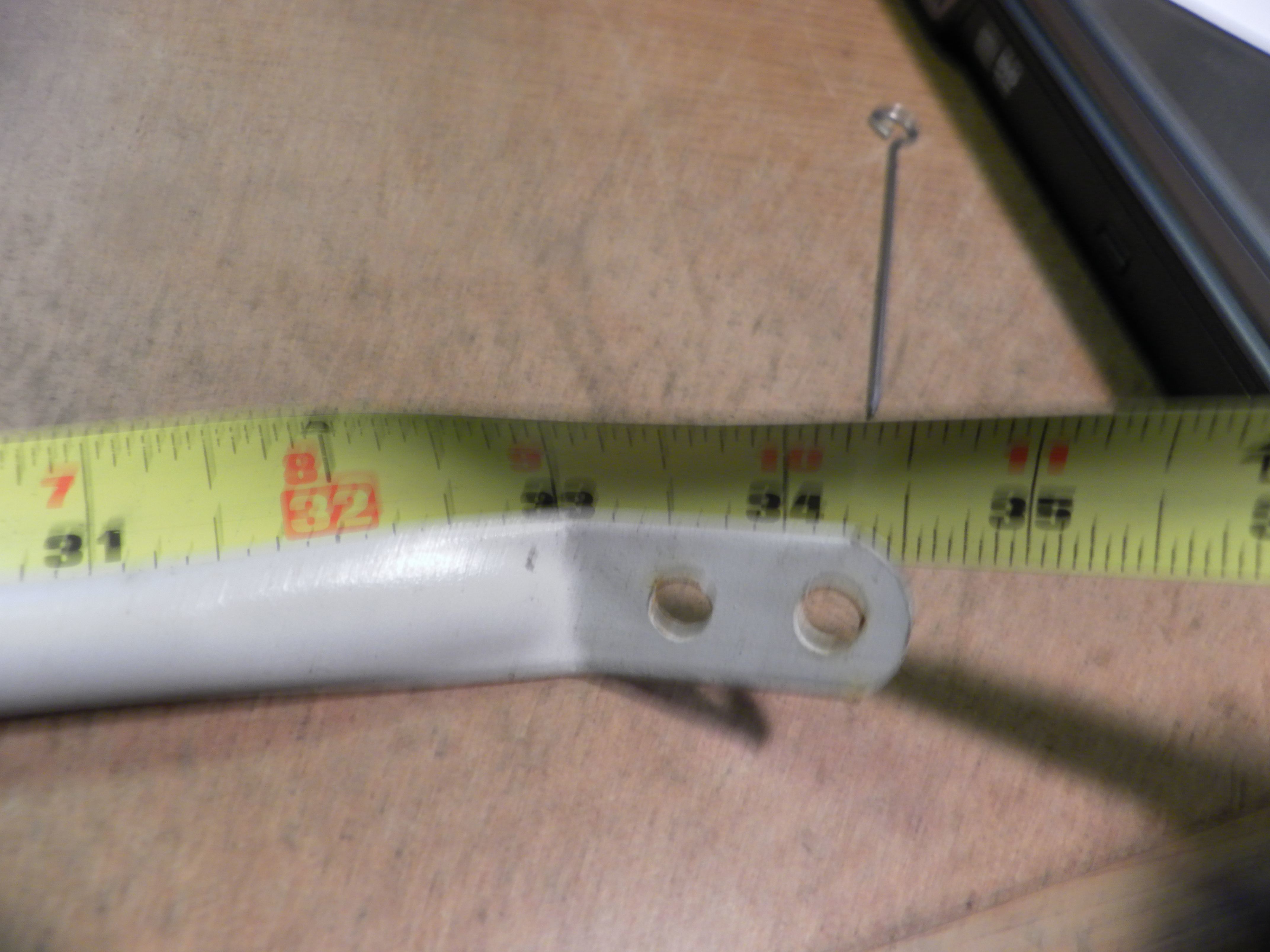

Yea, new dish time :) but FYI
and from the other end
