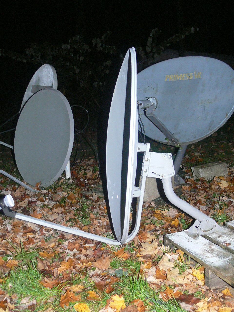

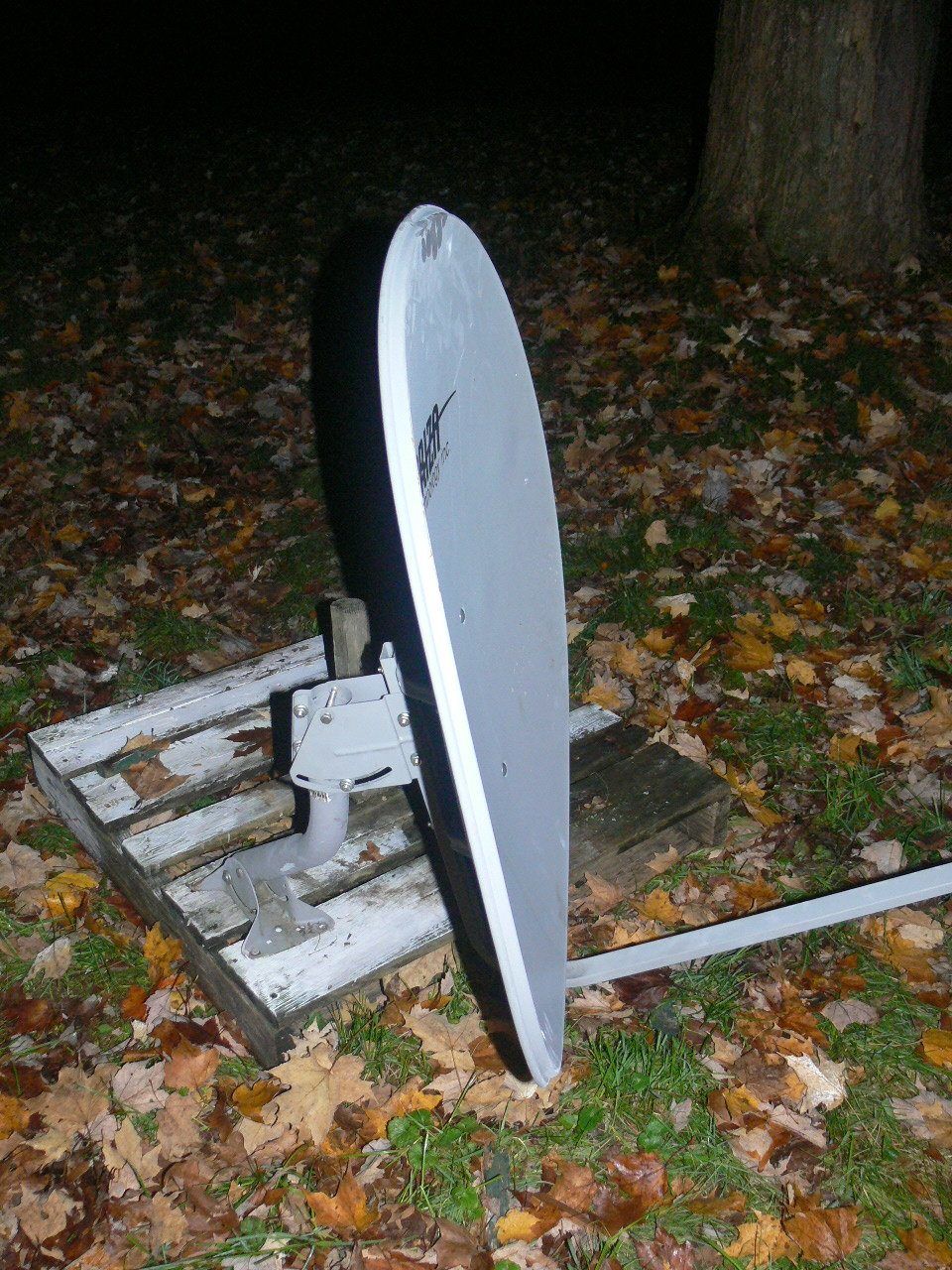

Pics you wanted
Remove bracket, so you deal with the bowl only. Put a few books on a big table and small pillow or piece of sponge on the books. Get 2 pieces of styrofoam 2" x 4" x 8" each or similar size. Put the dish centre on the pillow. If the edges touch the table, add books so the lowest edges are about 1" above the table. Press the higher edges through the styrofoam ( the sides 2" x 8" sit on edges ). Perhaps you would need another person to help you. Cheers, polgyver
I would hold the rim like you were holding a steering wheel at 9 and 3 o'clock on the unwarped sides.Now take the dish and hold it to your chest and thrust it away from you and jerk it back quickly. Then check it on a flat surface or use the string method until it is perfect.I have done this several times and had great success.
