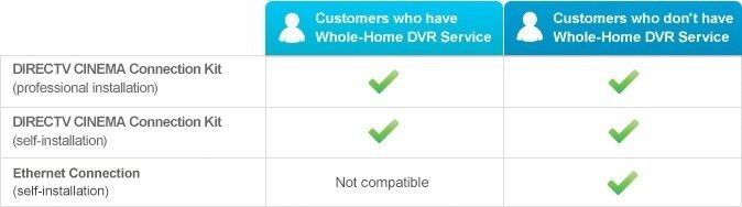

I don't know HOW I missed this super-scientific chart on the official website ;)

Sorry my post was a little vauge. If you have mrv and want on demand, you cannot do a direct ethernet connection because it will disable whole home.

Sorry my post was a little vauge. If you have mrv and want on demand, you cannot do a direct ethernet connection because it will disable whole home. .
I don't have personal experience on the HR34, but according to a number of posts on this forum, what you see on the HR24 (the disabling of the internal DECA when you connect an ethernet cable directly to the receiver) does not seem to apply to the HR34. And, as I stated earlier, from comments in other posts on this forum, connecting the HR34 directly to an internet connection appears to act as a CCK all in itself.

I'll do some research on the HR34 having an "internal CCK", but it seems to me that if hardwiring a CCK disables MRV, then that would be an issue whether the CCK is external or internal. I was just hoping to not have 1 more thing to plug in back there - my surge protector is full up.
--EDIT--
Ok, THIS answered a lot of questions.
What's really cool about the HR34 is that if you have one, you don't need a CCK if you hook an Ethernet cable straight into the HR34. The HR34 has the exact same hardware as a CCK built right in. If your HR34 is connected to your router, it will send internet information to all your other receivers. You can also use a CCK if your HR34 doesn't have Ethernet nearby.
If you choose to run Ethernet networking instead of coax networking, you need to be aware of this. The HR34 will try to use coax networking and your other receivers will become confused. There really isn't a need to run Ethernet to every receiver as long as you have it connected to the HR34, but if you choose to do this, be sure to connect a Band Stop Filter between the satellite cable and the HR34. This will force all the receivers in your network to use Ethernet.
So, I think I see where the confusion is arising. If ALL my receivers were hardwired to the router via ethernet, then MRV would not work (officially). This is actually not the case for me - while the downstairs receiver is hardwired, there is no ethernet cable going up to the bedroom. So I would need the CCK to get both on-demand and MRV upstairs.
BUT, since the HR34 has the CCK built in, the only reason I would need a CCK would be to connect to the router wirelessly. I'm going to tell the installer to leave the CCK out of the setup and see if everything works.

Okay, short story short:
Removed the CCK from the setup completely. This included removing a splitter that split the SWM power coax (or whatever it's called) and the coax running to the CCK. Plugged the ethernet cable directly into the HR34. The HR34 (which was plugged in while I did this) displayed a message when powered on that it was not communicating with the dish, despite showing a live picture at the same time. A red button reset cleared this error. MRV works perfectly, the H25 upstairs is connected to the internet, the CCK is totally unnecessary in my setup. Took all of 5 minutes to do. Installer was lying or just didn't know, I guess. One less thing plugged into my power strip... plus that CCK got HOT man. Glad to have it out.
