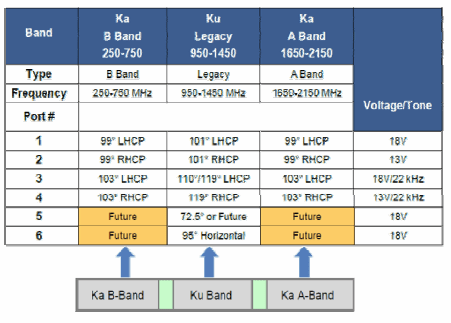

You missed my point, the mdu reverseband will need 4 from the kaku ports, then both flex. No room for 95, it's one or the other.
Sent from my SM-G900V using Tapatalk
Though I also see no reason why a diplexing arrangement can't be made to connect the 950-1450 MHz converted Ku band of the international dish to one of the flexport lines from a 6 output RB legacy LNB. Lines 5 or 6 in the diagram. With the converted RB spectrum to either side (the "future" blocks in the diagram).
Sent from my SGH-M819N using Tapatalk
I agree ...
Plus tell all MDU, lodging, and hospitality customers they'll have to ditch any international dishes if they want 4K?
No way ... that's unacceptable.
My thought Is they move those channels to a different Sat, when time comes that they need to.

You can not leave customers hanging like this. Directv is DROPPING THE BALL on this big time. So you are saying is that I have to give up my international programming in order to sub to 4k. That is not going to fly. If DirecTV can't provide a solution to receive all of its programming then you will have people cancelling. It drives me insane that this was overlooked and the attitude is that we don't care about international customers who spend big bucks on foreign programming. That is the WRONG answer and is completely unacceptable. Every customer is important, as they are why many at DirecTV get a paycheck in the first place. The moment you dispell one type of programming then who's to say HD isn't next or SD, ect. If they offer it, they need to provide a solution to get all of it.
Wouldn't the easiest solution be to mirror intl on RB? I know they've only "leaked" info on RB 4k, but this would work, too, no? Also gets out of a big dish.
Yes, mirroring to RB as a prelude to moving 95W, or just continuing to mirror it there, or to somewhere on the Ka band for that matter would seem to work just fine.
However, what seems sensible and fine to us and what DIRECTV engineering ultimately chooses to do for their own reasons usually unknown to us are two separate issues unfortunately.
Yep, there is a cost involved with mirroring to another slot, and mirroring to reverseband isn't a bad idea as it would get rid of the current conflict, ultimately they could do it now as we don't have that much 4k content and move them elsewhere once the SD to HD transition happens. I don't see that happening until the next generation box is launched because ATT will want everyone who has SD boxes to have upgraded equipment when they do the transition to an all HD platform. They could temporary mirror the internationals to reverse band and then move the internationals to another slot once the HD transition is complete. Until DirecTV figures out a path, any customer who upgrades to 4k and has international programming is left with the choice of one or the other. Not cool. I get the feeling that we wont see anything for a while and it's going to turn into when Dish Network said "soon" with HD RSN's. We know how that turned out 10 years later... Our luck att wont have a solution until 2020! :(

I am hearing conflicting reports on international programming, one answer is one or the other for that type of setup dswm module with 6 wire lnb or the current international lnb. I also heard a Rumer that the 95 can be diplex ed onto line 5. But solutions are like 2-3 yrs away
My information that said one or the other came from a trusted source high up in the know. But I don't know much about the information regarding diplexing. Field testing is not even scheduled yet.
A few questions, how would this be wired... and how would one setup in the IRD? No option is present for it.
Hence the 2yrs away part of my post... I don't really have any information worth sharing at this time. I anticipate the dswm13 switch to go residential and the DSWM30 to be released.
