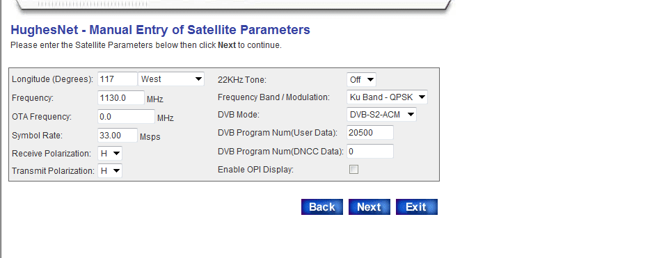

Maybe I missed something, but I don't understand the need to change the parameters on the modem unless it's a spot beam & he's out of range. The easiest way for him to tune the dish is to let the birdog in the truck, get a long LAN cable, enough to go from the modem to the dish & use a laptop. From the hughes system contol panel/registration installer he would have everything needed to get the system up & running. I take screen shots of all my last successful parameters for the different birds. The 1 attached is from 10/7/11 for 117w. 117 1.PNG
