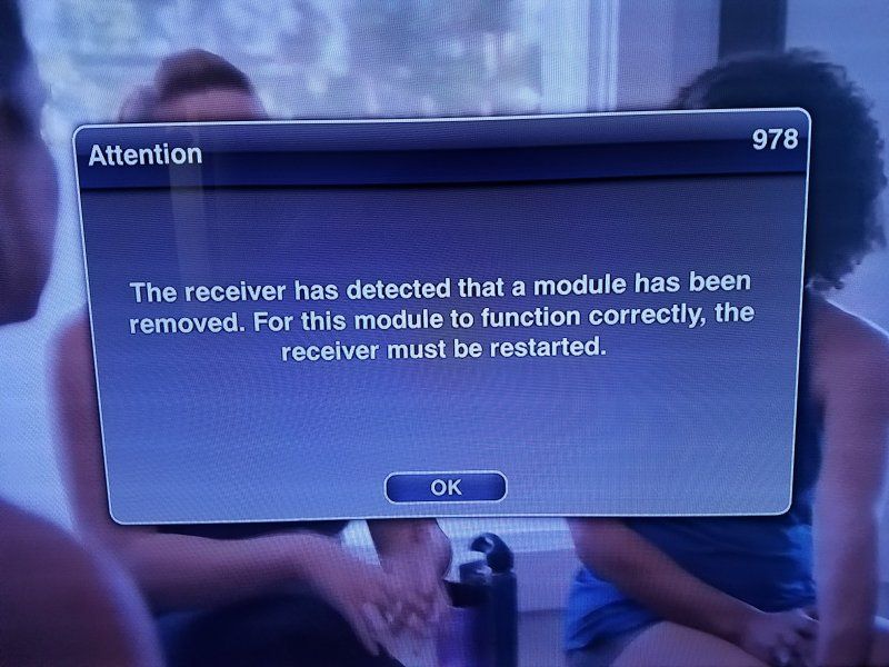

I have been getting an Attention pop up #978 that says The receiver has detected that a module has been removed. Then I have to click OK and my HWS does a re-boot. Got it twice today and once about a week ago. The only thing I have done recently was add the new Dual OTA Adapter couple of weeks ago. Any one have a clue what is going on? I also added the new Dual OTA Adapter to my other HWS and it has not given me this issue. Tried to upload a pic but it says the file is too large. Never had that issue too since the new SatGuys has been installed.

I just got the popup again. Anyone know what it means?
That does look like the one you get when you unplug the OTA module from the USB port. Did you try another port to see if it follows the module?
No, haven't tried that. I will try another USB port tonite or tomorrow when there is nothing recording. Thanks for the suggestion.
It means something is 'flaky' with either the module or the USB port it's plugged into. It thinks it's been unplugged. Use another USB port as suggested and if it's fine, it's that particular port. If it happens in the others, the module is failing or worst case, the USB 'interface' internal to the Hopper is failing. That means the Hopper will need replaced.... and it will come with the new s/w interface.... :p
