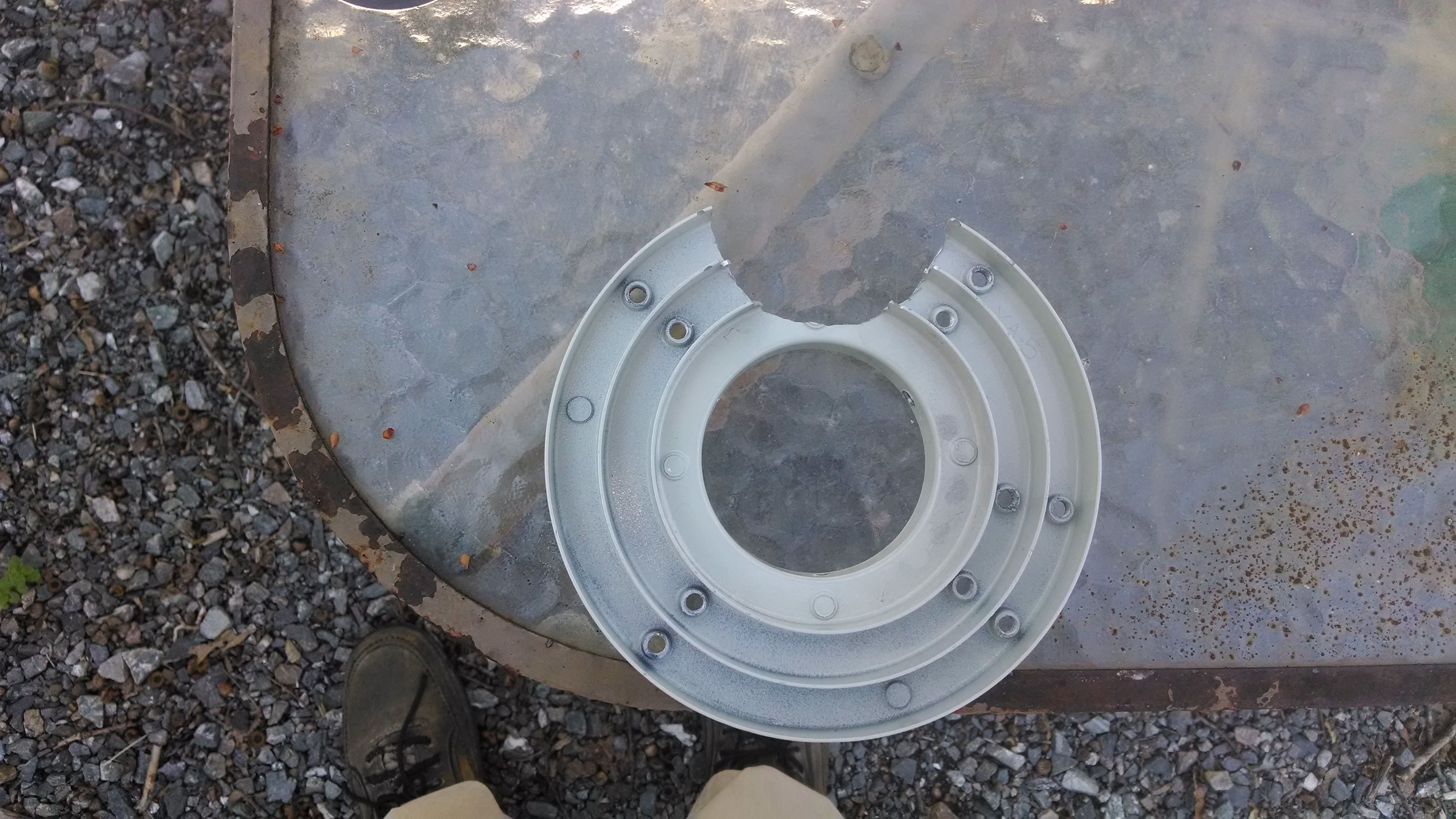

Lets say I had a custom made scalar that placed two Titanium C2PLLs as close as possible, maybe touching each other. On a 10 foot dish what would you think the minimum separation achievable would be?
2 degrees, 4 degrees?

I would like to say all you guys talk about is easy; if you can understand what you are asking. The dbs type of dish does use only parallel lnbf's of the horizontal; using only the dish to make the angles. If you use the lnbf to cut the angles in half; they gain some signal level by using the middle of the dish; each. The center of the dish with 2 lnbf; both receiving the full parabola/round the dishes middle is spaced between the 2-lnbf (center of dish is between the 2 lnbf; and they both aim at the middle; both skewed; and both satellites linear c band; full signals of each). At 2 degree's the scalar's need to be cut or removed to allow them to fit close; but each must be isolated using plastic; and cannot touch each others metals....except to the diseq sw and cable gnd. serving them. I figured this out because every time I was mounting a second lnbf; i would lock up the system if the 2 lnbf's were powered up at the same time when I placed the second lnbf. By using a diseq sw only; tand plastic holding the next isolated from the first; it worked (over a certain number of lnb's; or a small ground in the home (smaller than the dish is as a ground) needed special "isolation" the cable companies used on their dishes (lnb's cost 500 each; and isolator's cost 1-500 (and they were just plastic,,,! Let's just say the plastic was needed because you do not want the "i's" to mix together; you want them seperate.

And, the holes diameter is for fitting lnbf w/o scalar (; does it also allow the angle to also offset to the middle of the dish across the elevation change, and cut the angle in half across horizontal (to make the dishes middle, or prime focal and middle distance length; at the same time; when the dish is not motored; at all. Then amc7+amc10+as many as you want; can be aimed and arrayed using this "hole" technology. It is used on James Bond film's; and now in peoples homes. The cable companies used these years ago (60'-70's). This principle was missing in DIRECtv and Dish Network technology from their beginning; and they do not use it today; as their dish antenna is designed to focus the signals to their lnbf assembly.
And skew is easily set to the "hole"; also. As well as elevation and east/west aim; all with the middle of the dish. I just do not use too many scalars; but the plastic stays on 10 or more lnbf array's; as so many signals are focused at one time; the lnbf's count too much of the others as noise if they are powered up. Plastic, the answer to everything. One at a time powered by DISEq 1.1/1.0 switches ONLY! A dish laying flat on the ground; horiz.; works this way; every day of the week; and never moves an inch. I play with the offset; and it shows me the pictures I aim; while I am working on "duck pond satellite tv in the USA is an FTA"...You can also mount any satellite dish upside down; and it works this way; or even sideways; and it works this way also. it is not in their directions, either.
how many lnbf you can array this way is dependent solely upon use of the middle of the dish; and how many shadows of any signals needed from the dish; can be avoided (and 2 degree sats aimed). This picture is not 3d; but shows just a few on a duck pond dish; layed flat on the ground looking straight up; compared to a pre-determined offset for aim.
