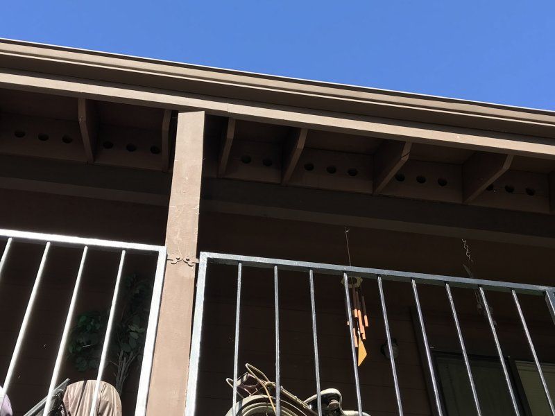

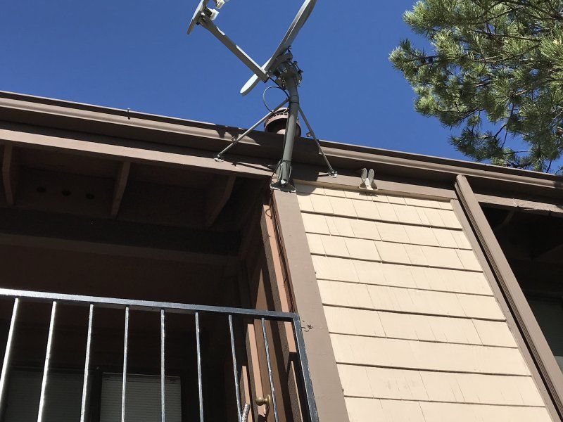

So the HOA president also the owner of the unit it okay to install it here:
That should be an acceptable point no? For some reason the tech wanted to install it further in front, the next post.
I live in the unit behind, there is a breezeway between building 8 & 9. I live in building 9. It be a bit of wire job, but that would be an acceptable spot no?

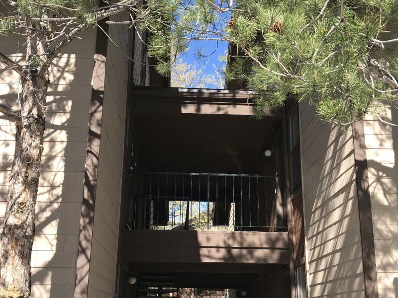

So your unit is facing north?
My unit is facing south directly to the southern skies.
Problem is if I have them install it on my patio fascia there is a tree right Infront of it, so all the units dishes are installed on the other side.
Claude, I am stuck in a contract until September of this year, would you suggest me cancelling Directv and then resign up under a brand new account? Do you think they would be more willing to install it at that point? I never dealt with a third party installer, I tried to google a 3rd party installer here in Reno but I haven't come out with any research yet...my unit from the pic is in the breezeway on the right, you are looking at the left from the above pic.
No. A fascia board by itself isn't strong enough, and isn't acceptable to Directv, as a mounting point for a dish. If they use an undermount then maybe depending upon the condition of the rafter.
They need to saddle the rafter and make sure a couple of the lag bolts are long enough to go through the fascia and into the rafter. It'll be fine.
Two lag SCREWS aren't enough, you need at least three, maybe four by Directv standards.

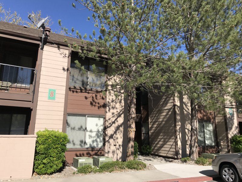

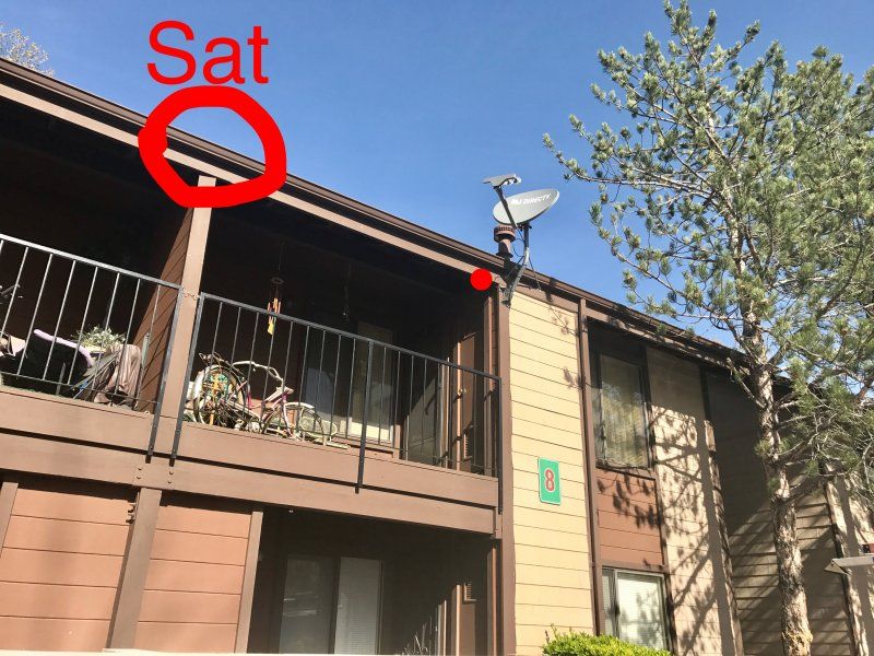

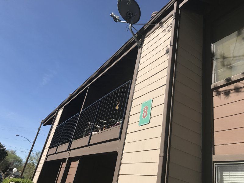

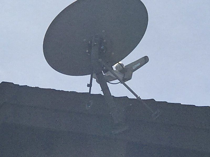

They literally could do this on the side:
Mine would be in middle...
The installer at one point agreed to install it on the 3rd fascia instead of 2nd, not sure he reasoning.
On the vertical trim board looks like it would be okay, can't tell for certain.
I would ask neighbors who have DIRECTV, who did their install. Was it DIRECTV or private?
I would call Directv to see how and if a private installer would take away your credits.
dont think i would want to put a 1/2" or 3/8" lag into the end of a 2x and trust it for very long, 2 of them is a recipe for disaster. the thing will split, predrilling will help, but there is only so much meat there

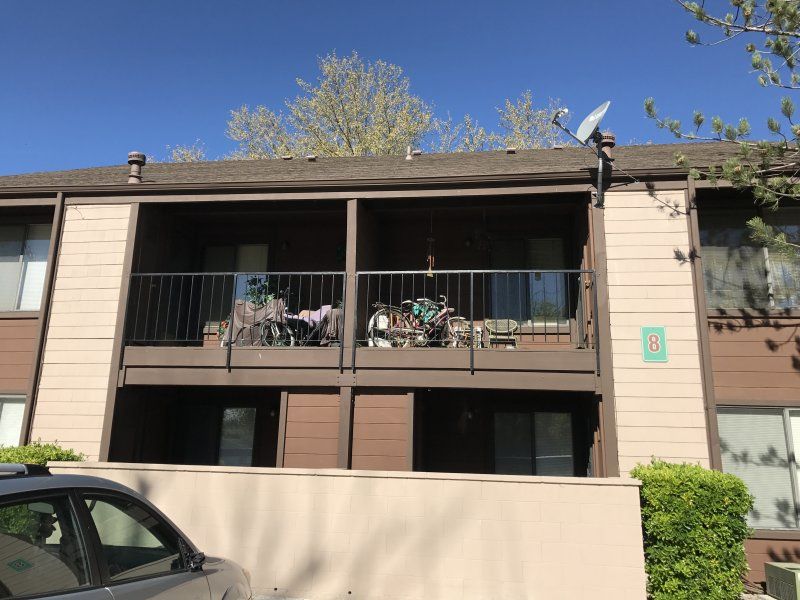

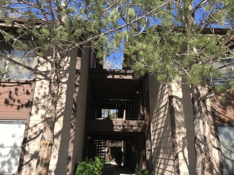

I posted the pics with a closer look on where the install is going to be and a closer look at the wooden part. I'm sure the tech would have a good idea on how to run the cable properly, but the guy yesterday told me HOA lady that the wire was going to be hanging which is BS because they would obviously be stapled next to the wall. But he made it sound like he was gonna drop a cable on the roof...

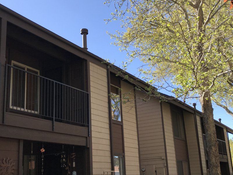

And this is the other side which is very close but both techs that came agreed that the tree would be on the way otherwise the install would have been very nice...

it really doesnt matter what is already installed
guidelines change.
techs can only do what they are currently allowed to do
