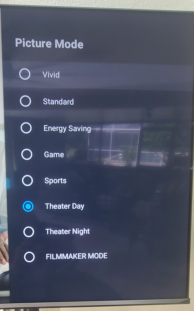

With all due respect I know exactly what is going on. I am one of those video/audio geeks. I strive for a perfect picture/sound experience. With a constant HDR signal being sent it is taking away the ability to use a day and night calibration I have setup for SD and HD viewing. I have some pretty expensive software and equipment that is used for this purpose. This is what I should be seeing on my picture menu of the TV when no real HDR signal is being sent...

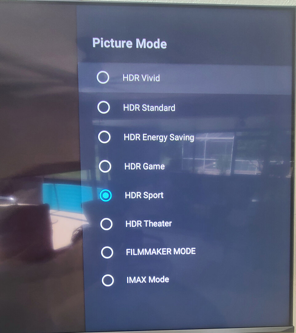

When the TVs are being sent either a true HDR signal or an upconverted signal those options are replaced with a series of Factory preset HDR settings.
There isn't a way to calibrate a non HDR upscaled signal correctly. What you may think looks good after basic tweeking is no where near what your picture could look like if done correctly with a proper 20 point grey scale calibration and Gamma calibration.
