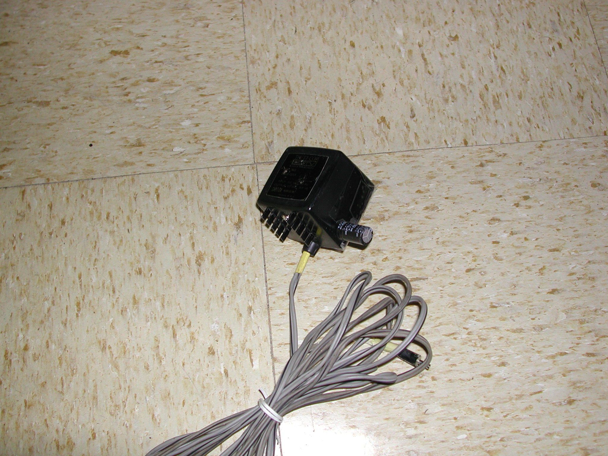

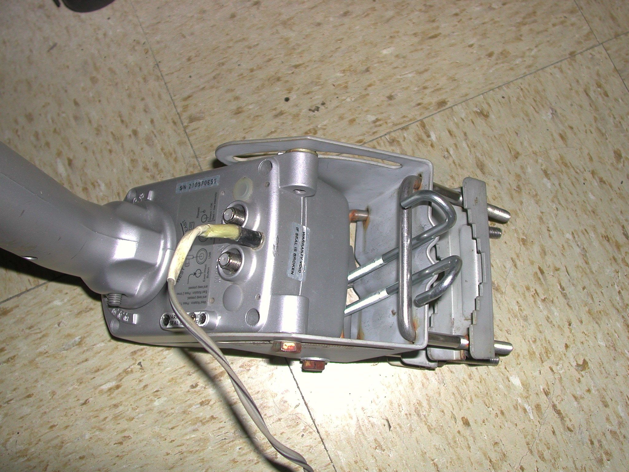

Exactly, I did the mod. A wall transformer with a LM7818 and some caps to to provide regulated 18v. I could have gone 20, but 18 is the highest normally sent up and I didn't know what the limit was for the motor. didn't want to burn it out. But does still move very slow. It's just too small a motor with a very high gearing.
I tested it the other day after going over it for backlash. It was pulling about 90ma with no dish and I found it had some play that could not be adjusted out. Opening it up, I found the worm gear was moving back and forth. The wedge they designed didn't do much for end play. However a small piece of bicycle innertube rubber was just right stuck end the end below the adjuster. Has no play now and still pulls ~90ma with no dish.
We have those wirlly vents on the roof and I have a pass through to the attic space near the dishes. Just inside is a outlet for the transformer.
