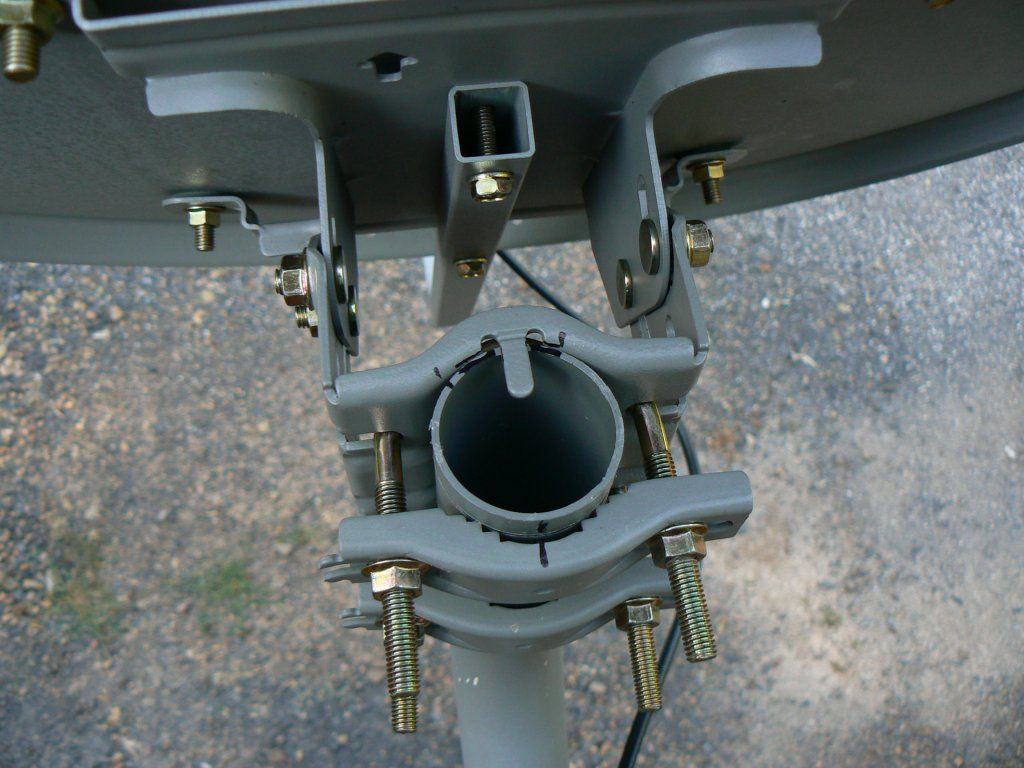

Good that they made it right for you. :) What size (inner & outer diameter) is the tube on the 36"? Any pics of the dish and mount?
I'll post pics and measure the tube when the sleet and freezing rain stop.

I understand the HH120 is slower however my dish has a tab on the top of the mounting bracket so it doesn't slide down the mast. Makes it easy for one person to handle. On that point alone I think the choice for me is the 120. Thoughts?
For the dish you have an HH90 will do fine (and perform faster). I believe I read somewhere that the HH120 took as long as 2-3 minutes to move from one end of the arc to the other (someone please confirm) making channel changes quite long in some cases. If you are thinking of upgrading to a 120cm dish in the future, either for tracking down an elusive ku feed or for experimentation with a mini-bud (small c band setup) then you definitely want the bigger HH120. :)
Be aware that the diameter of the HH120 shaft is 54 mm - whereas the HH 90 is 42 mm, so a small dish may not fit on the HH120 shaft. I had to make a custom bracket to fit my 85 cm dish on it.

Regarding the tab on the dish mount, simply bend it out of the way to get it on the HH90 shaft.
