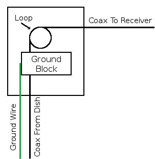

Put the coax loop between your ground block and your indoor equipment.
Loop presents higher impedance than the ground block to pulses.

No myth. I cared for multiple commercial radio repeaters under 200 to 300 ft towers on buttes in western ND/ eastern Montana. Would have to service lightning damage on at least one every weak. After I put a loops in the RG jumper to the heliax the trips to these sites dropped to once every other month.
Thanks for the tip! You do mean after the ground block, before it enters the house, like this?

I agree, nothing for MythBusters to debunk! I place three or four 1 foot loops secured together with nylon ties in the crawl space. I do this for coax and control wires. Wouldn't matter if it was placed before or after the coax ground block.

Most electrical codes require all non-mains conductors to be bonded before entering a dwelling; this means to have your feedline running through a grounding block that is connected to your house electrical ground at the breaker box or direct from the ground rod or plate. This should be the first line of defence. If your installation is not to code there could be insurance issues if you were to make a lightning damage claim.
I think it might be better to have any RF chokes (wire coils etc) outside before the ground block... in an attempt to keep any (spark) potential outside rather than dissipating it inside your residence. No doubt RF chokes can help dissipate high amperage high frequency AC, but a direct hit will destroy things... no matter how good your grounding is.
