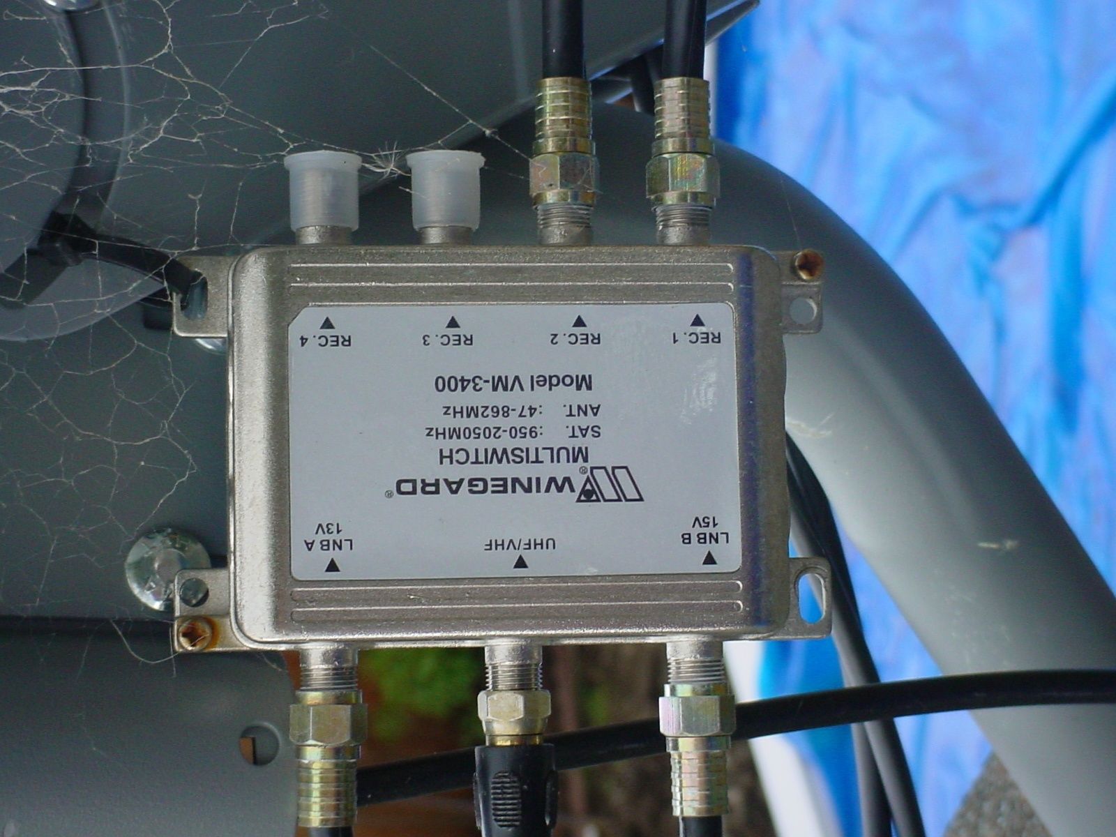

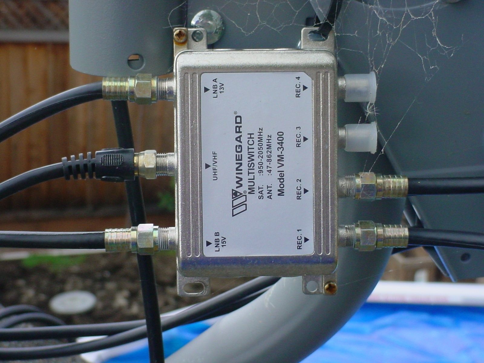

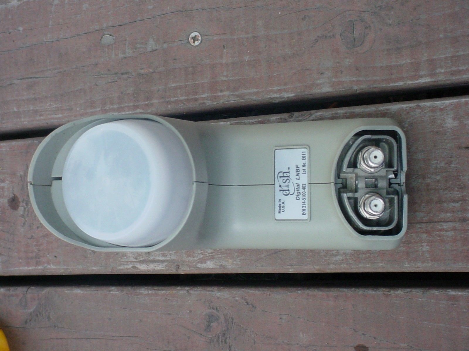

I have a first generation Dish Network system for lack of a better term. I bought it in 1996. I've had a 3000 series receiver since the original installation. I later attached and activated a 301 series receiver. It always worked great.
The lack of equivalent HD at E* forced me to go with Voom when I upgraded our TV.
The following is a list of equipment I currently have and plan on using:
811 receiver
301 receiver (this I plan on upgrading when I replace the SDTV with HDTV)
Voom antenna (dual LNB)
Pre Dish 500 antenna (dual LNB)
Note the attachments. One is of the Dish Network dual LNB and the other 2 are of the switch that was provided during the Voom install.
What I'd like to know is what do I have that is still useful and what do I need in order to make a two TV system configuration work at 61.5 and 110/119.
When I got the 811 the other night, I hooked it up and had it activated and I can currently get OTA off of my aerial antenna as well as Voom off of the 61.5 pointed dish.
Thanks in advance,
me
When you say Pre-D500, do you mean the original single sat Dish Network labeled dish? If so, which sat is it pointed at? As for what you have, the multiswitch is a simple 3x4 switch. It wasn't really neccessary, however, it was probably used instead of 2 diplexors(that switch has a built-in diplexor) at the dish. If you have a single sat dish, I would see about replacing it with a D500, preferably with a 500Twin so that you can get the 110/119, and then you can tie into the existing V* dish with an SW21 for the 811. However, if you are planning to add a 942, you would be better replacing the V* dish with the old E* dish, getting the D500, getting a DP+ Twin & a DP Dual would be the simplest way to do it. Good Luck.
Thanks for getting back to me. When I say pre dish 500 I mean exactly what you say. It was that single dish Pointed at either the 110 or the 119 position. I kinda remember going into the diagnostics screen and seeing that on various occasions.
I will get the D500 twin and an SW21. I don't want to replace the Voom dish because it is already pointed. A 942 would be great. Would it eliminate the need for the 811 and 301 because it has dual tuners? I might add that in the future. I'm getting the impression the 301 would be obsolete and useless for the HD configuration I'm seeking, or would it tie into the line and only unscramble the SD signal. If not, I will eliminate the need for satellite in the second room with the SDTV until I replace it and buy a dual tuning receiver like the 942 in the future. I can't see wasting another $125.00 to $200.00 on another 811 because eventually I want to leap into the new millenium with a DVR. You've been very helpful.
Thanks again,
me
