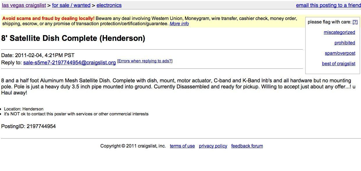

Thank you all for your responses.
What I have learned from your posts:
1. I don't want Christian Channels, so I need a "C" rather than a "KU" or a combo.
2. I can get a recommended receiver such as openbox and be happy with it.
3. I would need something with a rotor since the programming is 'spread out' and it would make sense to tweek the satellite easily depending on the time of day or signals received.
4. Ethic channels are fine and dandy. I understand that I can get transmissions from European countries and would love to see their news programming.
So.... What is the best Satellite with LNB I should get to receive C bands? (I figure I can get the openbox receiver and be done with that portion. Unless it is more affordable to buy a system?
Thank you all, even the youngster, radar (who is right about the programming). :-)
