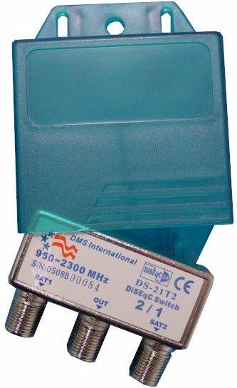

Are the DMS International DiSEqC switch's water proof? I put some weather boots over the connections, but I think I need something better.

little bit of some coax seal that I got at Rat Shack...
other than that, nothing....I have another one that the back is all rusted to hell but she still runs like a champ (another 3 year switch) :)

The DMSi switches come with a neat cover!

Yep, they look nice. But just like you I have had the same DMSi 2 way switch for a few years and its up behind the dish in the weather with no protection :)
