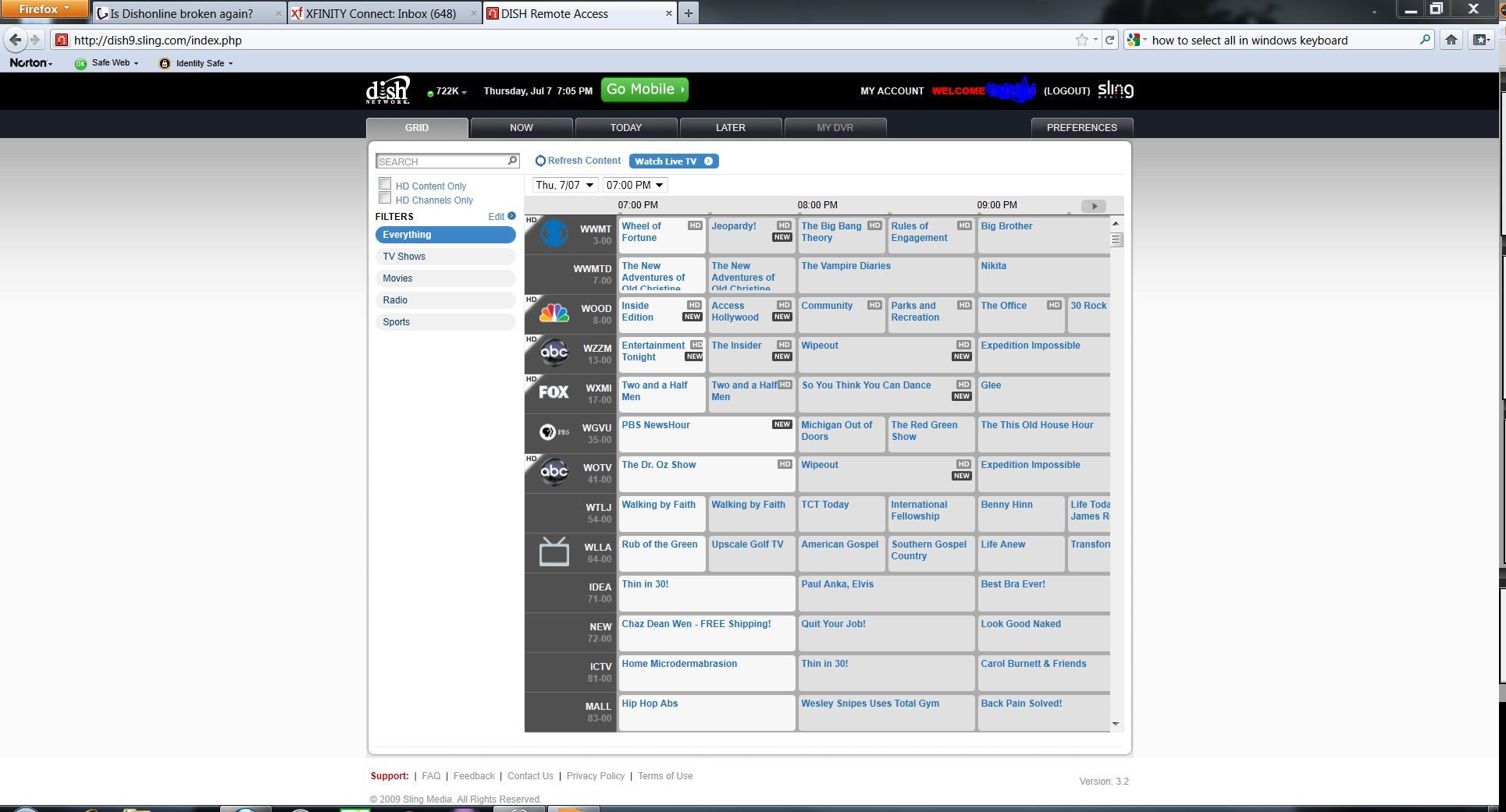

Just wanted to check in, this is still a known issue that is being work on. If I can please get more people to PM me issues with your account number, the server accessed in the Address Bar, and the email used to log in.
FWIW, Dish Online grid works (using that term very loosely) for me in IE. It's blank using the IE Tab add-on in Chrome. iPhone works fine. Haven't tried it on the iPad lately.
I recently started getting "There were no results found" in all tabs on the iPad Dish Remote Access app. I can watch Live TV, but cannot see anything in the tabs. I am able to see "Scheduled", "Timers", etc. I have removed and reinstalled the app along with rebooting it. This also happens on my iPhone.
I had the same issue with "no results" in IE9, but cleared cache/cookies/etc and am able to view the guide. I am able to see the guide using Safari on the iPad, but can't watch anything for obvious reasons.
Information sent to ZachS
The program guide just started working again. This morning, when it was not working, the Dish web server was: dish9.sling.com. Just now, the web server switched to: dish11.sling.com, and the program guide is now working again.
Same here - started working again except where I was hitting dish9.sling.com before mine now goes to dish8 - maybe it was a bad server?

Yeh,so, the iPad DRA app is working again this morning. And, significantly, the language list is now populated with a long list of languages.
Yep working now.

Matt .. not to be the d*ck on this.. but you realize DishOnline doesn't allow the user to see what server they are connecting to, they only show
Code:
www.dishonline.com
... no real server association. So the back end sling conneciton is probably still the same, but the front end is now just a redirector with load balancing (manually or some truly non-dynamic scheme) ... and so ... for "DishOnline.com" this kind of feedback can't be gotten by the lay person. To find out what server the user is connecting to (unless they come out with an "info" button) they'd have to check their netstat in a command prompt, or they'd have to look at the log file for the web player.
And that's something that really should be pushed back to DishOnline about *not* hiding the direct server name a user connects to .. specifically because of issues like this.. which have continued for over a year, and then there's the whole other range of issues that were also found to be associated to user account on which dishXX.sling.com server they connected to..
