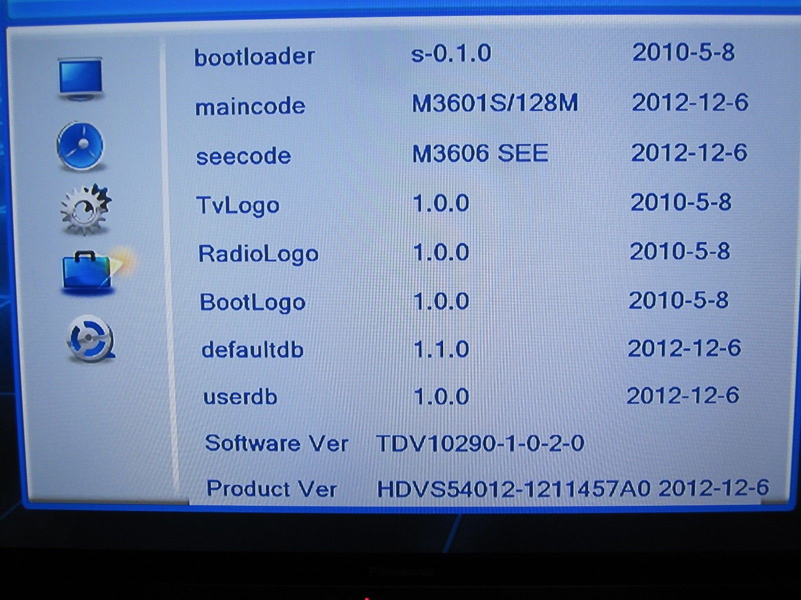

Firmware: installed the most recent load you posted in Dec/12. See screen grab below
Re file renaming; one file was renamed via DVR menu, a 2nd was renamed via PC desktop..but only the folder name was renamed in this later case. IMG_6955.JPG
