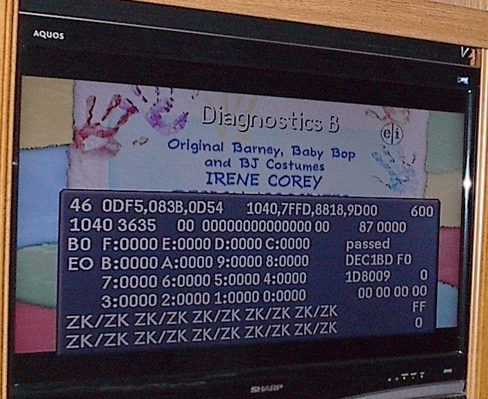

Is this what "UK" stands for on the authorization screen of Options 6, 5 while on T-4 ch 600
"Un Known"?
If you did a Master Reset :eek: on your 4DTV anytime after the Jan 4 conversion, that may be why the UK shows up on T-4 ch 600.
Just a thought that popped into my mind!
There is no UK except in England :). If you mean US Unidentified Service that has nothing to do with the conversion. I show ZK on T4-600 with a picture and running 4160 HITS SAC.
For anyone showing anything but ZK on the NET channels. You have an alignment issue with your dish. These channels have a 7/8 FEC and are harder to get with small or misaligned dishes. Net recommends at least a 3.8 meter dish (12 foot) for their services. Get the wrenches out and get a tuning :)

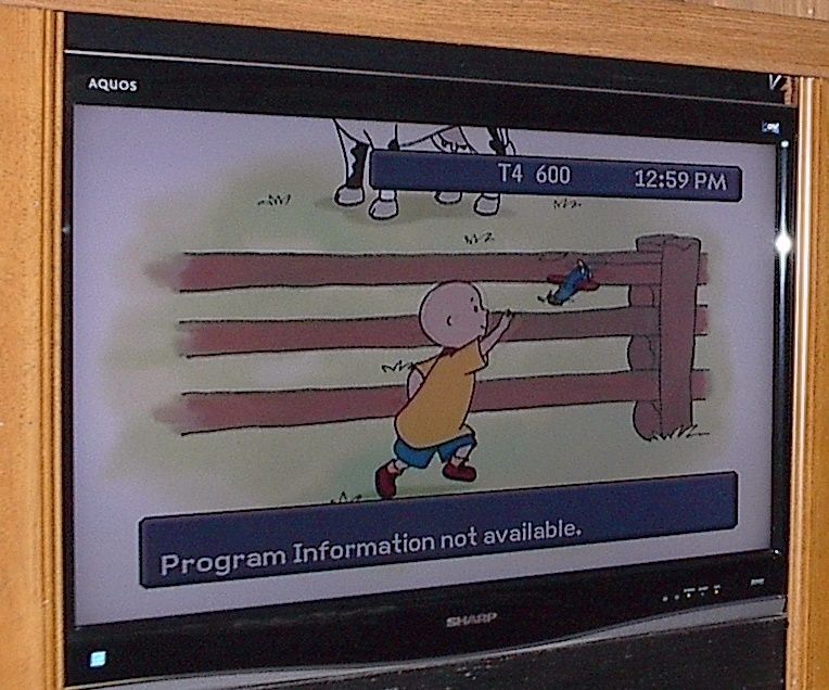

Here are pictures taken on CH 600 T4 on my bud. You can see it's working and in ZK mode. Anyone having issues have something wrong with alignment or corrupted maps. 602 & 603 working too.
