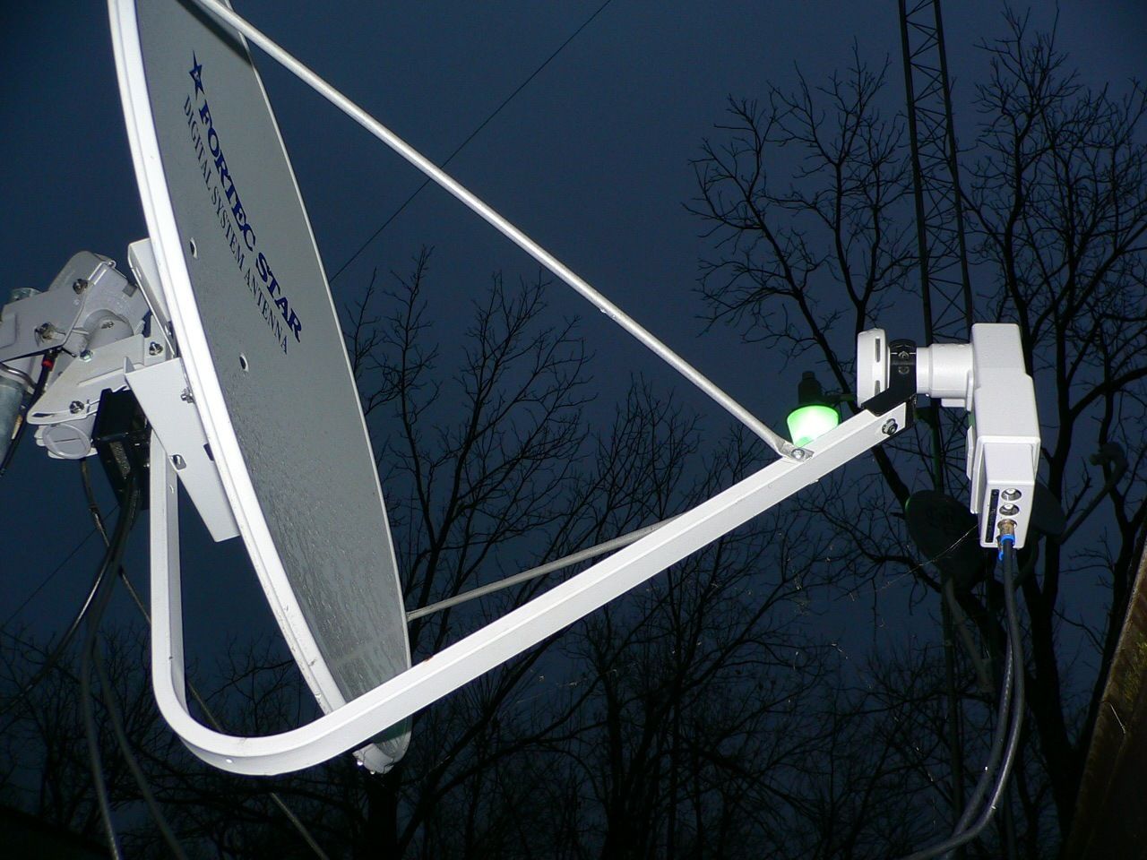

you may need to do a mod to the fortec star because the weight of the invacom pulls the LNB holder arm out of the focal point of the dish.
That's what I did when I put an Invacom Quad on my .9m Fortec.
The retro-tubes were lifted from a scrapped OTA antenna.
