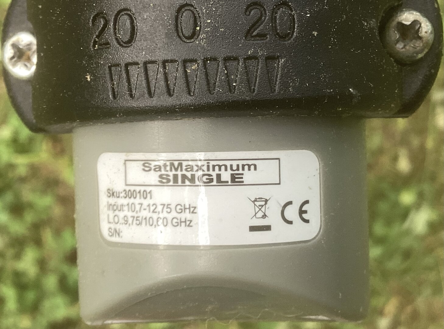

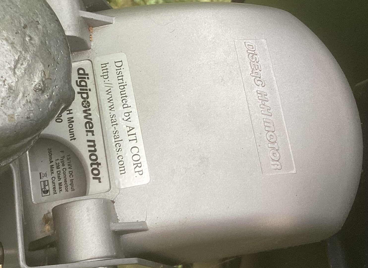

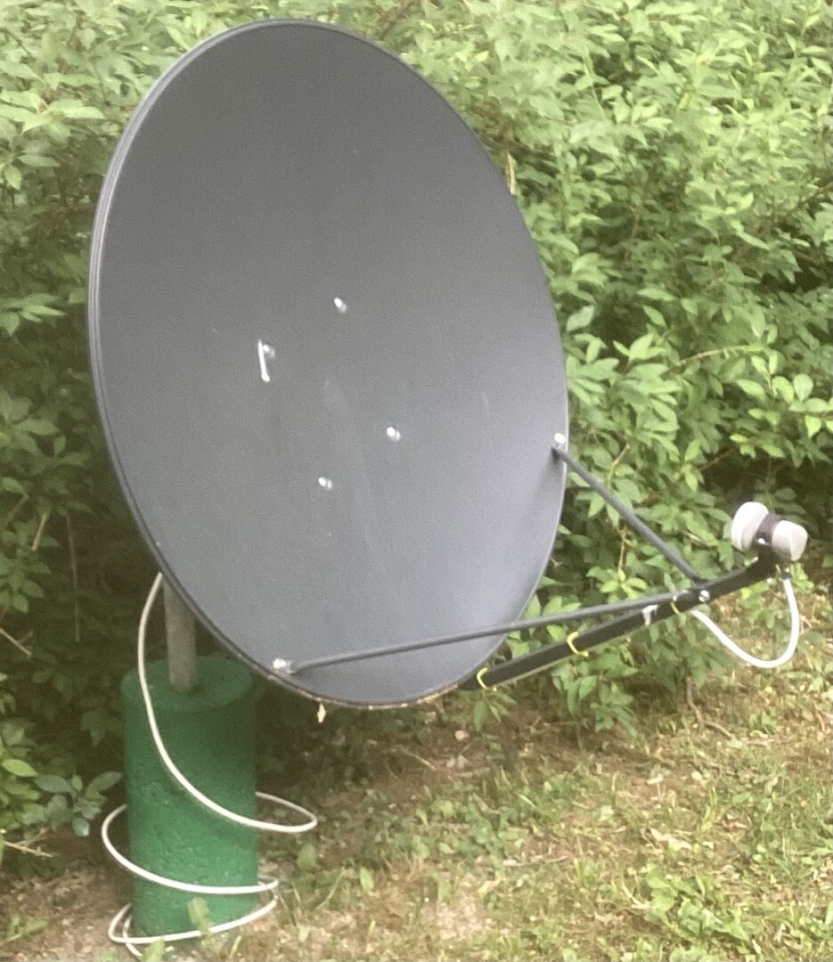

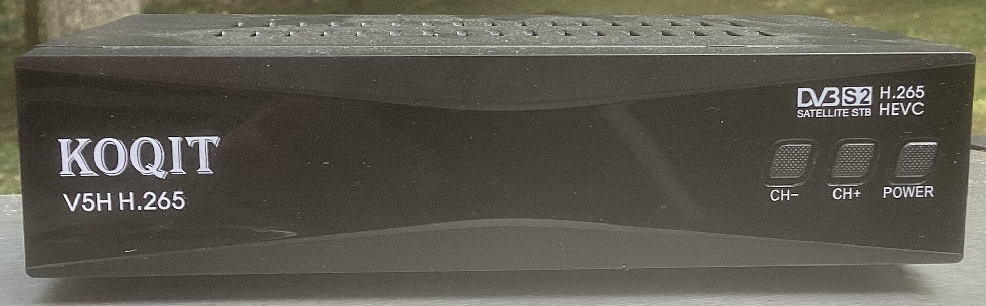

Hello Everyone!
I'm experiencing loud 'static' on the 2 meter amateur band whenever I turn on my Koqit satellite receiver.
I thought that perhaps the motor may have been causing the problem. To find out, I disconnected the cable OUT on the motor and rerouted the cable straight to the LNB which in turn leads straight to the TV in the house. I turned on the receiver navigated to a live channel and the 'static' could still be heard. Therefore, the motor wasn't the issue.
The 2 meter band radio is connected to a 12VDC battery and NOT the mains.
I'm uncertain what I can do next and thought the community could help me out. Has anyone heard of a problem like this before? Can it be fixed?

I have never used the Koqit brand myself but it might be the 'wall wart' power supply for it. Some of those switching power supplies are not designed very well and have a tendency to cause a lot of interference issues. Do you have another power supply of the same rating you can replace it with to test?

The original power supply has an output of 12VDC at 1A. I replaced with adapter I found rated at 12VDC at 750mA and issue persists.
Is the adapter you tried replacing it with of know good quality? I mean have you used it before and know it doesn't cause the issue you are now experiencing.
Have you tried another satellite receiver? If it is not the wall wart then the interference may be a result of something within the receiver itself.
I swapped out the receiver with the exact same model and same result here too!
If it is the receiver causing interference then the same model would likely do the same thing. Do you have another brand to try?
