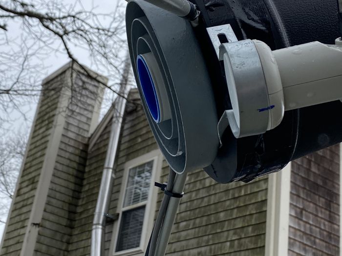

I went out a short time ago between rain showers and took this picture.
As you can see the Ku LNBF is behind the the C Band feedhorn.
I'm sure fine tuning the F/D will improve the signal, but for now and because of the rainy weather, it will suffice.
Hope this helped.
John

arlo,
Hope this helped.
John
That's the photo I was waiting for.
I'll put one up later of mine.

My Ku lnbf body (not plastic rain cover) is appx. 3/8 back from the C band lnbf throat opening.
Explains why I am getting a fat beam width. Takes about +/- 10 bumps of ASC-1 counts to get or lose signal.
Tweaks come later on. I'm guessing you've peaked your signal and that tells me I need to pull my feed back a bit.
Right now signal strength is in the 16-18 dB. Better than C band actually.
