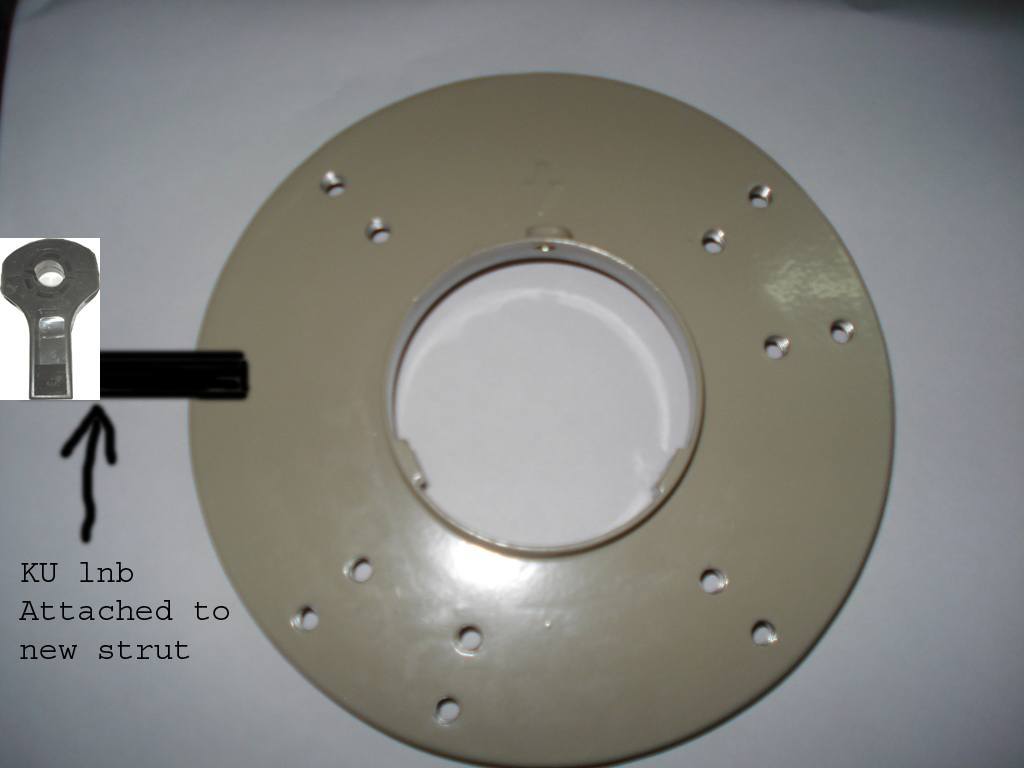

Is it possible to mount a KU lnb off the scalar ring on a 6 foot prime focus dish?
Or will the focal point be off to much? The dish is pointed at 105 for cband I would like to grab 101 for the freebies and perhaps 103 for the Pentagon Channel etc...
Possible? Absolutely! The offest KU-band LNBF will need to be positioned as close to the C band feed horn as possible to optimize Signal Quality. Once you determine the number of degrees offset, you will drive the dish to the corrected position setting to receive the desired satellite.

One thing to consider is that you need to use a Ku-Band LNBF designed for use on a prime focus dish. Most of the LNBFs out there are designed for offset dishes, and they will greatly underperform on a prime focus dish. SatelliteAV has a LNBF designed for use on prime focus dishes here.

I am trying the same: Using a large prime focus antenna but with a Dish Pro Lnb.
How can I make this work?
Do I just attach a scaler?
Any advise, thanks.
This is a product that can either be purchased (unsure if they make a DishPro version) or the end user adapts an existing scalar assembly by cutting a slot or hole to place the Dish Network LNBF in the right position.
Modifying an existing scalar is done by cutting a slot or hole in the scalar to place the Dish Network LNBF directly beside the existing feedhorn. Be sure to take into consideration the orientation of the scalar, position of the supporting arms, position of the LNBs, the cover assembly, and how to secure the DishPro LNBF.
