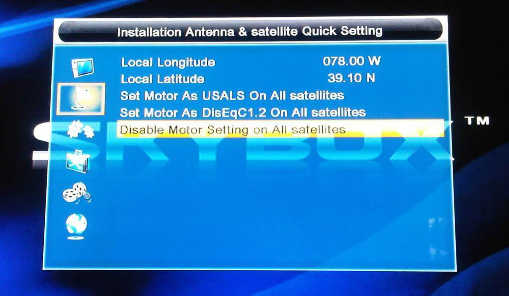

The one I uploaded is here. I agree with others that the USALS is better than before - - - and I like the fact that you can set all your Satellites to USALS globally at the same time instead of one by one.

As long as your dish is aligned decently to begin with, I recommend using USALS.

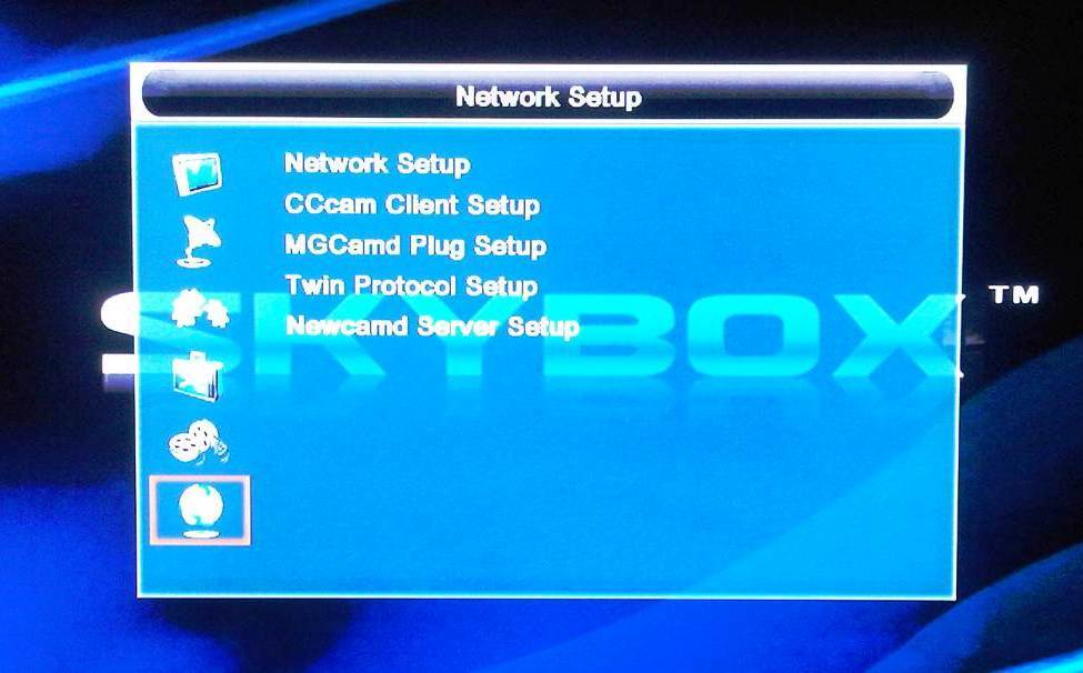

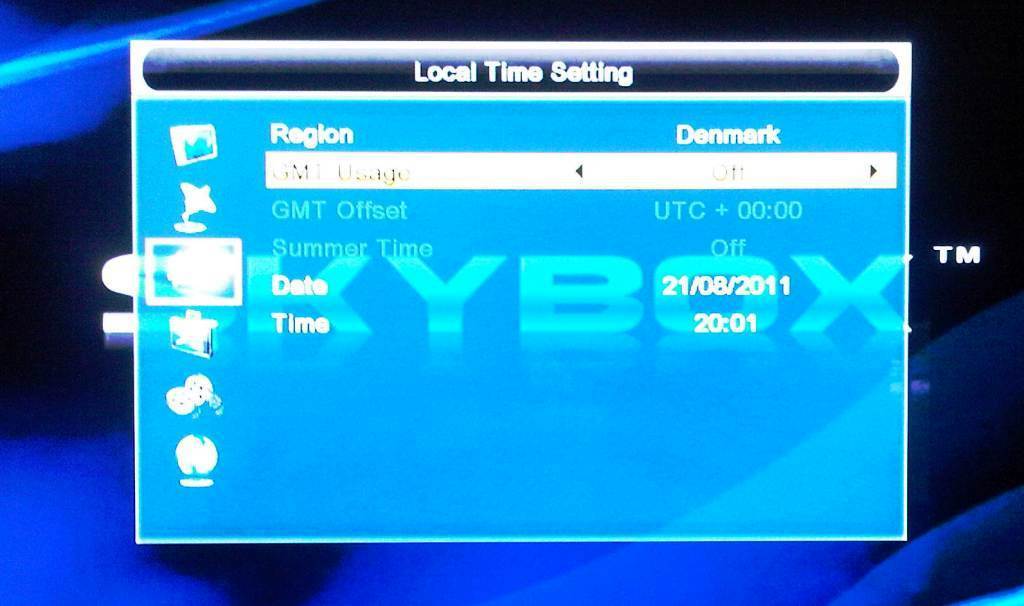

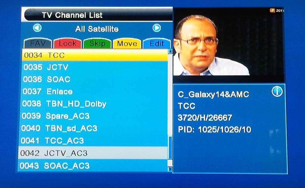

Here are a few PIX of 8-15
