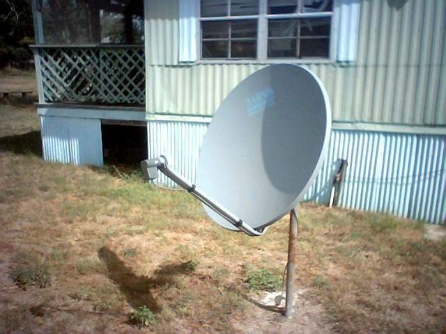

I have one 2 port DiSEqC switch... no heated shroud over the LNB, and no to all the rest.
See the picture.... It is another LNB then in the pick but everything else is the same.

Gary, you have been trying all these tests from the same wall outlet, right? Just for the heck of it, run a temporary electrical cord to a different circuit.
Yes it is from the same wall outlet. I will have to try that.... you think maybe the circuit it is on has something wrong?
Gary, just an idea. I have a travel trailer and have had issues. Did some handy wiring in the house and have seen weird things as well. Just try it. Not saying is what it is but worth a try? Just an idea, I would check out.
