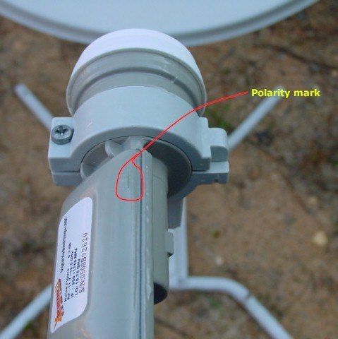

Yes, I think we can explain both your troubles.
First, that silly LNB has its zero position at a strange angle.
Read these docs carefully. (or at least see picture, below)
You probably installed the LNB thinking it was similar to your Invacom, then twisted it for maximum signal, and it's now offset by 90 degrees.

I have a feeling its the skew
jayelem..dont feel bad...I did the same thing too :)
There is a notch on the LNB and that is zero..skew from there
Ok the skew is my fault , when I swapped out the standard to try out the 905 digital sidecar and I put it back I admit I didn't pay attention to where I had it, still those numbers are really off no matter what STB I use.
I'll play with the skew later this weekend , I'm familiar with the notch on the Extreme II but I admit that it probably isn't skewed correctly.
