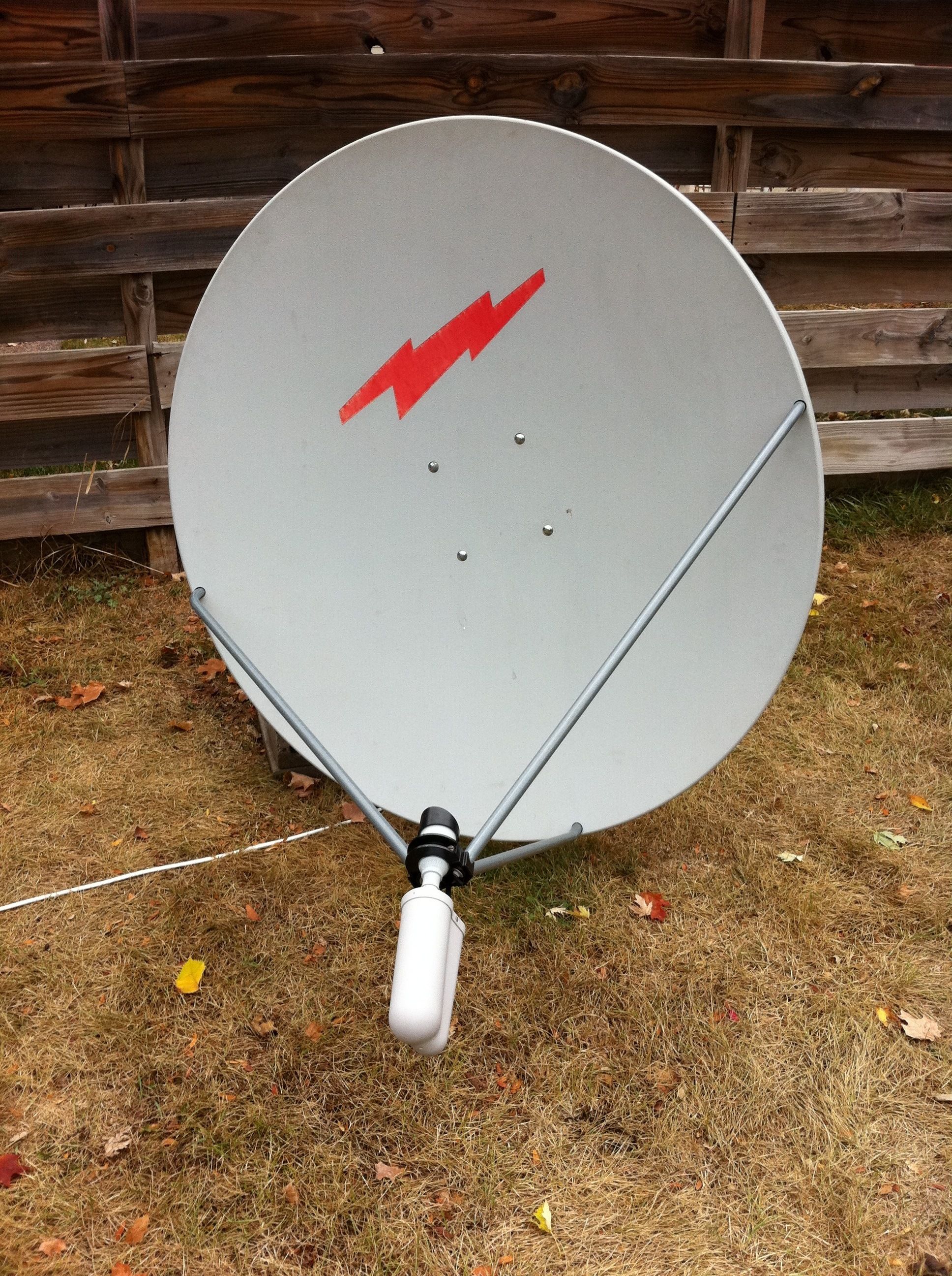

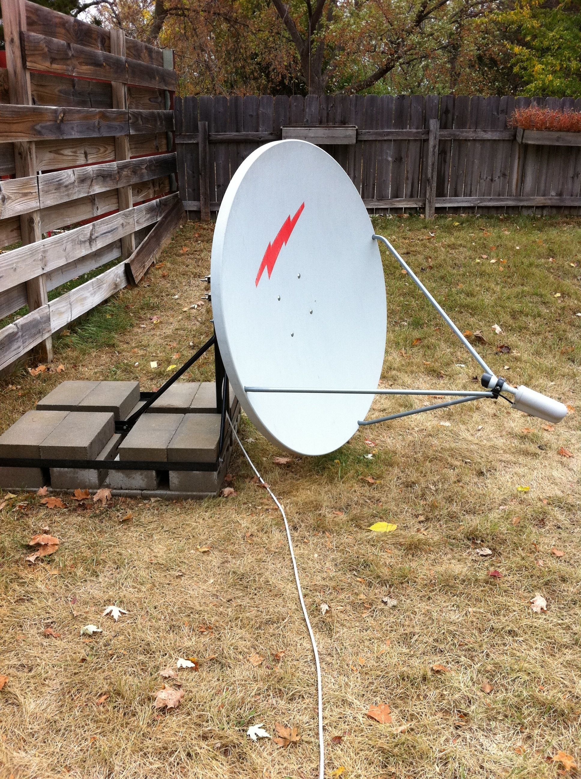

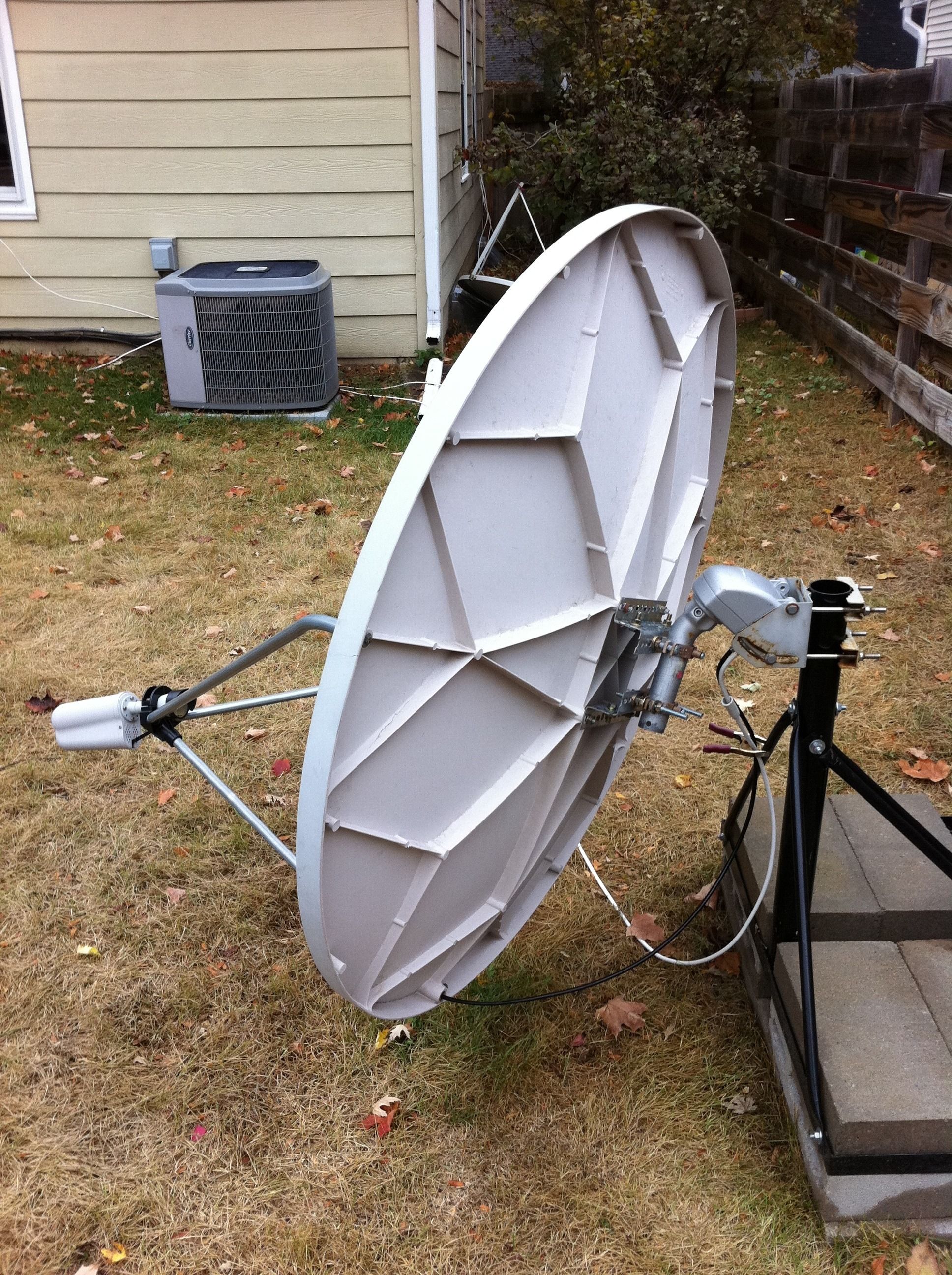

I got lucky and was able to find an Andrew 1.2m very close to me. I still have some fine tuning ahead of me, but for the most part, it's ready! I used Ziploc's plans to make the mount. The motor doesn't seem to have any trouble driving the dish from east to west.
