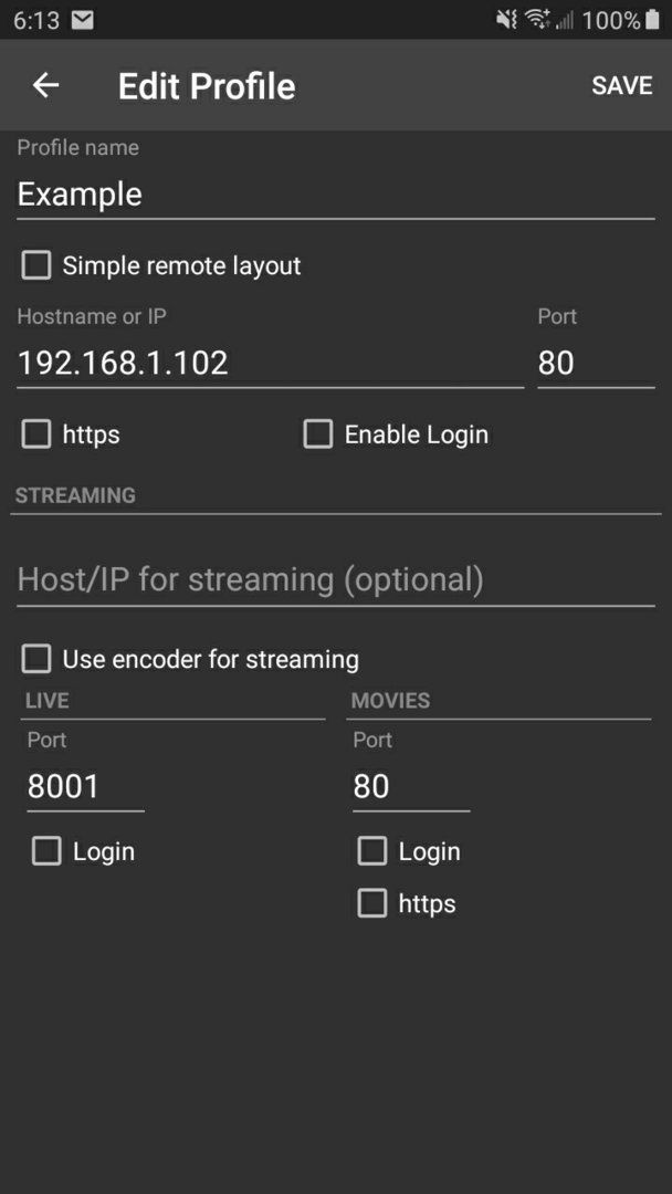

This box is a new animal for sure. I have a wifi dongle in the back usb (connected to the internet thru my router), but I am having trouble linking the box to dreamdroid. I enter the stb's ip into the app, but I don't know if I need a port number or how to determine what it is. Could you lead me in the right direction? I have openwebif enabled and can access it via my browser. http port is 80 on the openwebif config screen.

The default and typical for the Edision is port 80. As you are able to use WebIF on another computer via port 80 on this IP address to control and view the STB, this would confirm the IP address and port 80 settings.
All you should need to do to configure DreamDroid is enter the IP address assigned by the router and assign a profile name. Restarting the DreamDroid app will connect to this profile.
I have attached an example of a DreamDroid profile that works on my Android app. (EDIT: the phone app will not allow me to attach a photo to this post.)
Is your Android device using current supported / updated OS?
Is the the Android device WiFi enabled (on same network as the Edision) and confirmed working on other apps?
Is there a reason that an external USB WiFi is being used on the Edision instead of the embedded internal WiFi or better yet, hardwired ethernet?
Try with hardwired ethernet to the Edision?
Try DreamDroid with a different Android device?
