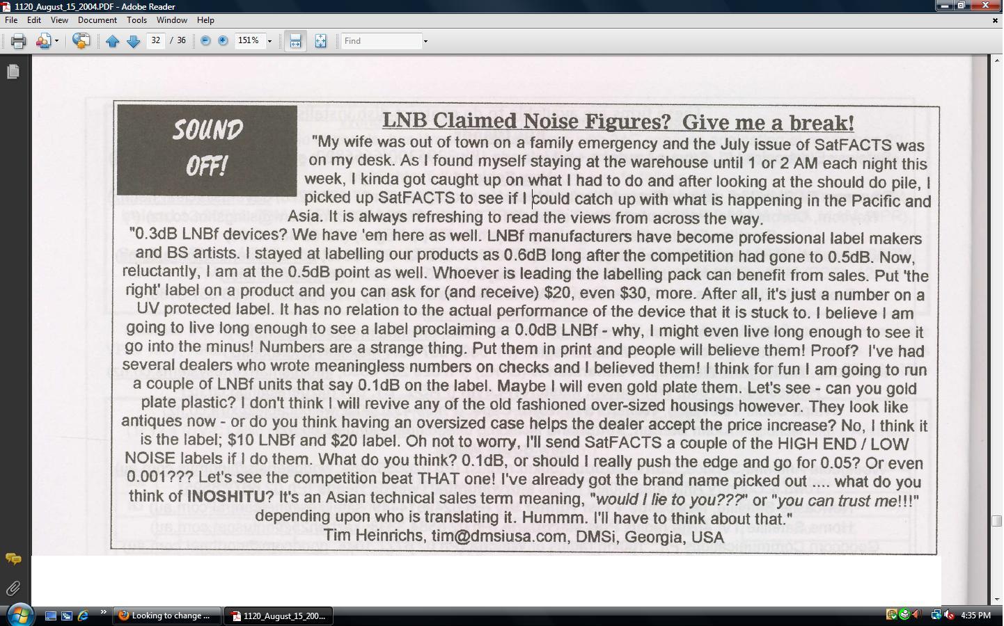

if you read through posts those "0.1" and "0.2" numbers are just hype. SatelliteAV's LNB is a .5 because Brian doesnt believe in "hype".
I did a comparison between SatelliteAv's LNB and my Sadoun .4 (the exact same one you have). Now the Sadoun one has been up there for 4 or 5 years
http://www.satelliteguys.us/showthread.php?t=289949
In fact this thread is classic
http://www.satelliteguys.us/threads/292116-Avenger-PLL322S-2-(New-Dual-Port-KU-PLL)
read post 12 (you have to download the pdf of the magazine).....so the same guy who admits those numbers are bogus now sells one claiming .1 :rolleyes:
(actually I attached the picture of the page in question)
I remember when my old Primstar LNB's that were a .9 or even a 1.0 beat the so called .3's out there
